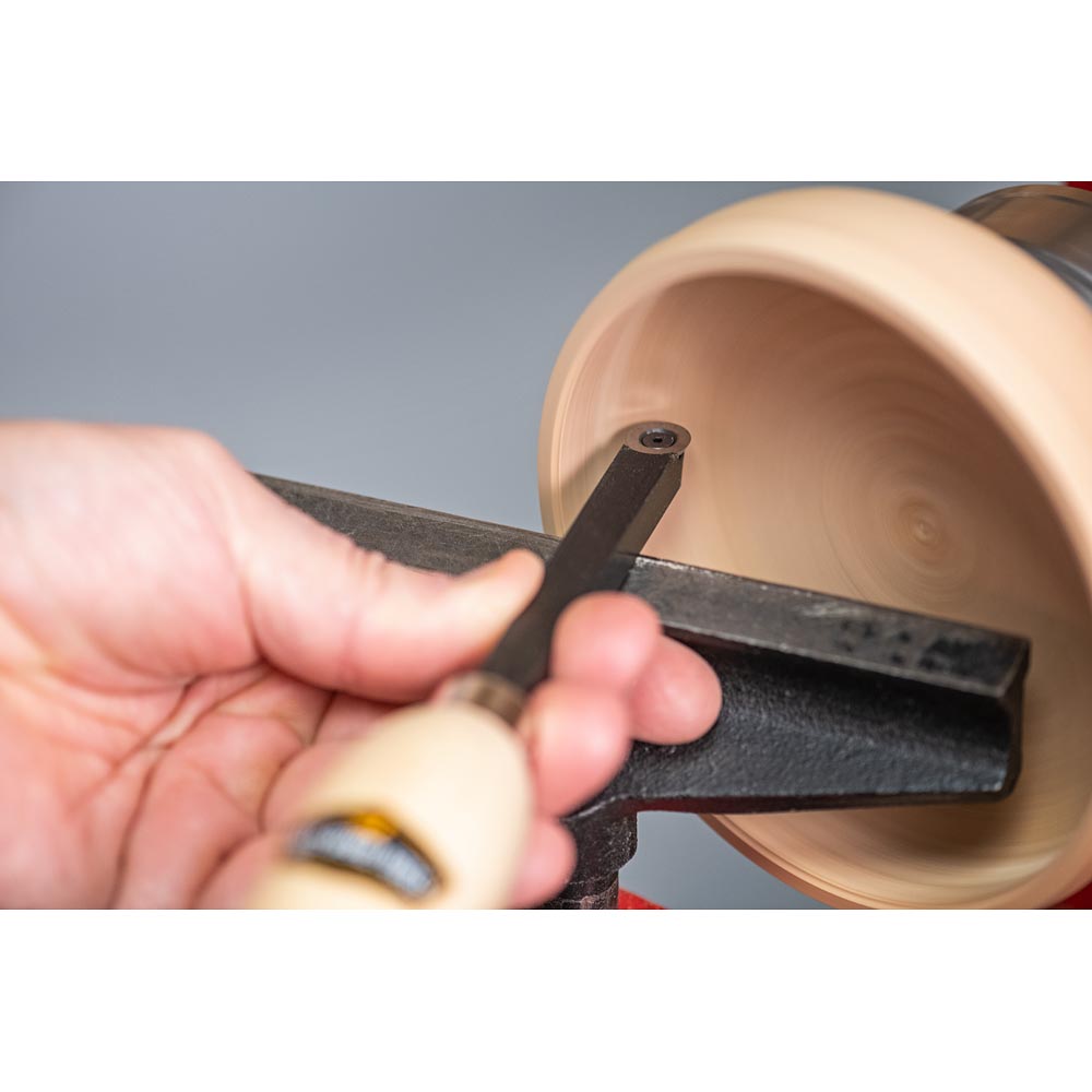

Easy Wood Easy Start Tools are great tools with which to begin your turning journey are an equally good choice for experienced turners looking for a new approach. These are economical and ideal for beginners and education. Turn pens, wine bottle stoppers, spindles, and small bowls or shapes.

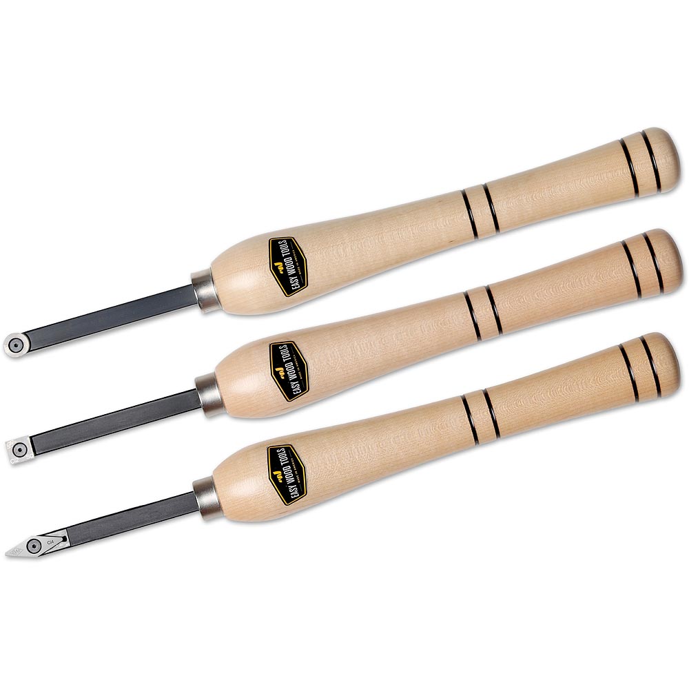

The 3 piece set comprises:

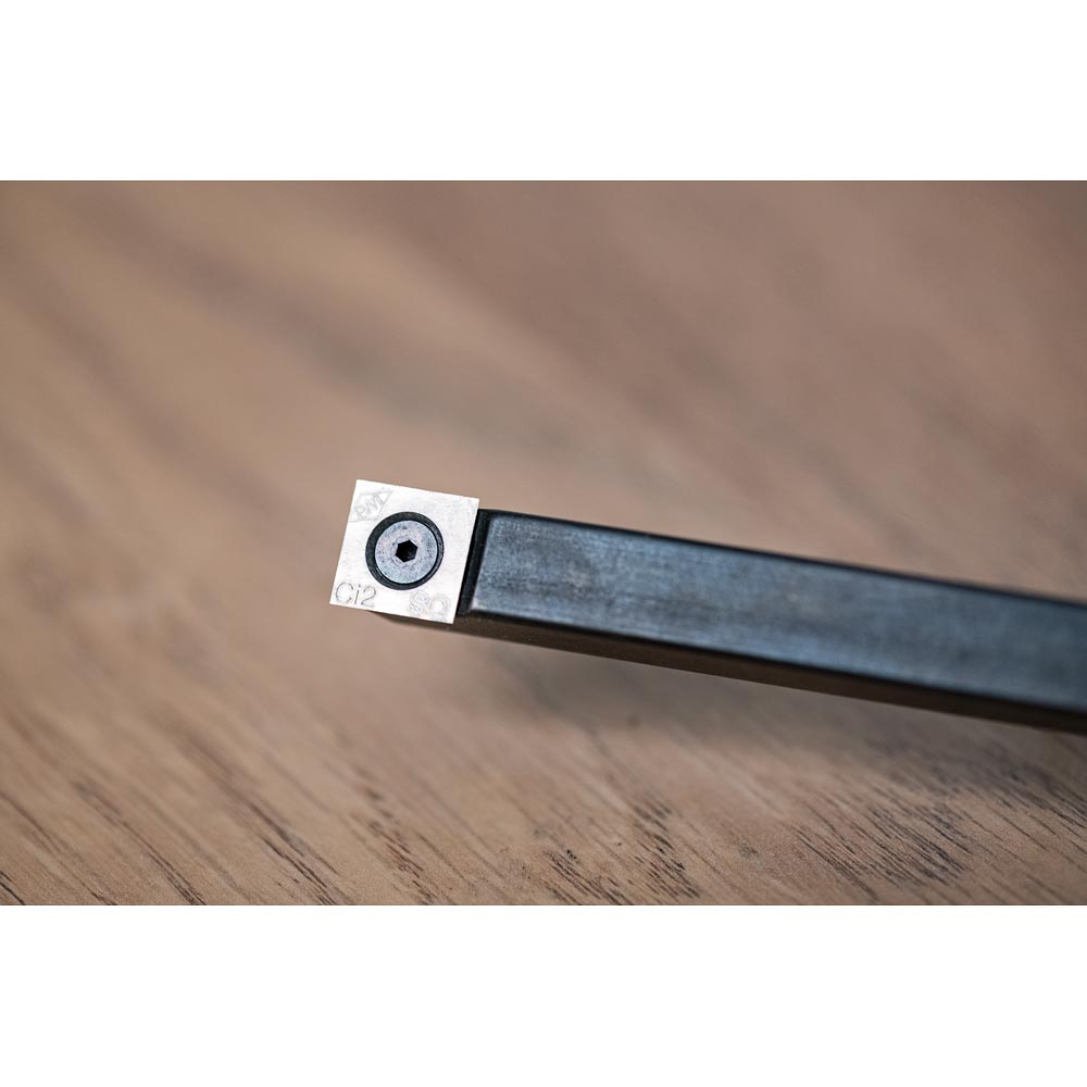

Easy Start Easy Rougher - this tool removes material quickly, cleanly and efficiently. It comes fitted with a square tip and includes a hex key for mounting the screw.

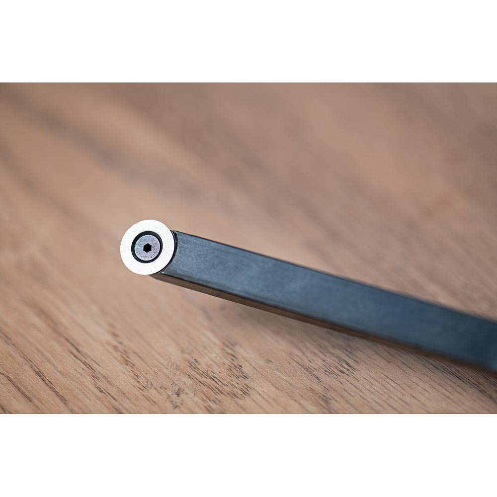

Easy Start Easy Finisher - use this tool for making coves, hollows, sweeping curves and final shaping. It comes fitted with a round tip and includes a hex key for the mounting screw.

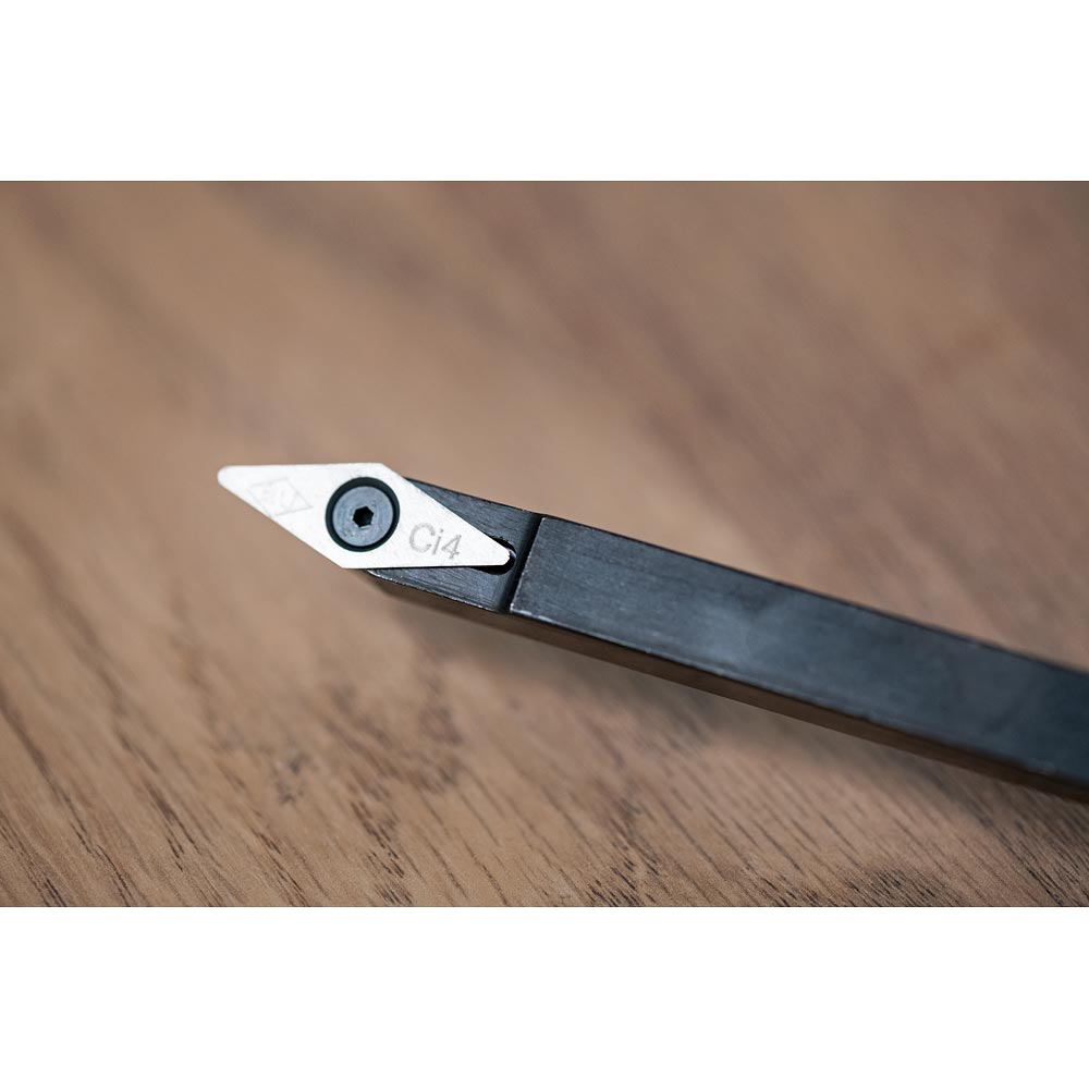

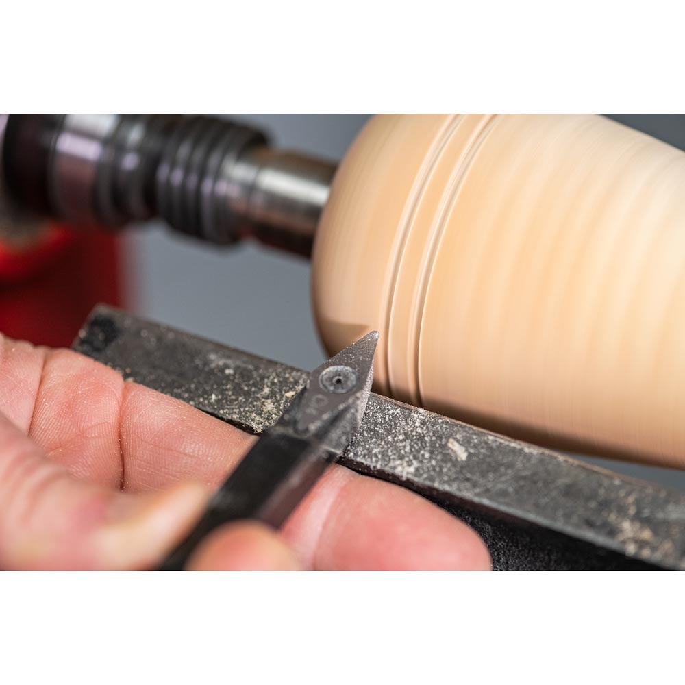

Easy Start Easy Detailer - use this tool to create small coves, beads and other fine details. It comes fitted with a diamond shaped tip and a hex key for the mounting screw.

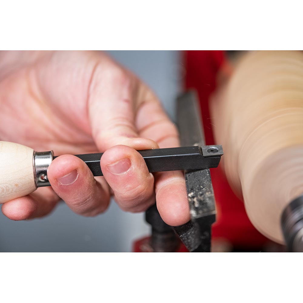

All of these tools have a 230mm long handle, made from American Maple with a copper ferrule for strength (the tools have different coloured handles for easy recognition). The 9.5mm square section bar ensures the tool sits flat and steady on the tool rest. With the tool parallel to the floor and cutting at centre height, the risk of catches and snatches is virtually eliminated. You don't need to sharpen these tools. When an edge becomes dull you simply slacken the fixing screw and turn to a fresh edge. Easy Wood Tools' carbide keeps an edge many, many times longer than HSS. These tools can be used to turn dry or green wood and acrylics.
Overall length of 318mm. The shaft is engraved with the corresponding carbide cutter reference number.
Negative rake tips are available, which work particularly well on acrylics, polyester and resins, as well as producing a fine, smooth finish on timber.
