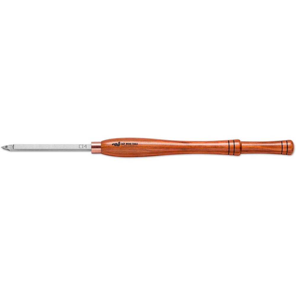

The Easy Wood Tools Pro Easy Detailer™ is a carbide woodturning tool designed for creating fine details, beads, crisp transitions, and tight‑radius decorative features on large bowls, oversized platters, spindles, table legs, sculptural pieces, and other substantial turning projects.
As part of the largest and heaviest‑duty range in the Easy Wood line up, the Pro Easy Detailer™ delivers exceptional reach and stability, making precision detailing safer, smoother, and more controlled - even on big, demanding workpieces.
Featuring a diamond‑shaped replaceable carbide cutter and a robust 12.7mm square section bar, the Pro Easy Detailer™ sits flat and steady on the tool rest, providing predictable control with no sharpening required.
The substantial 508mm American Hickory handle offers maximum leverage and vibration damping, giving turners confident handling during delicate detail work on large forms where accuracy and tool stability are critical.
Engineered for deep reach and intricate precision, the Pro Easy Detailer™ produces clean, sharp detailing cuts on larger or harder‑to‑manage pieces.

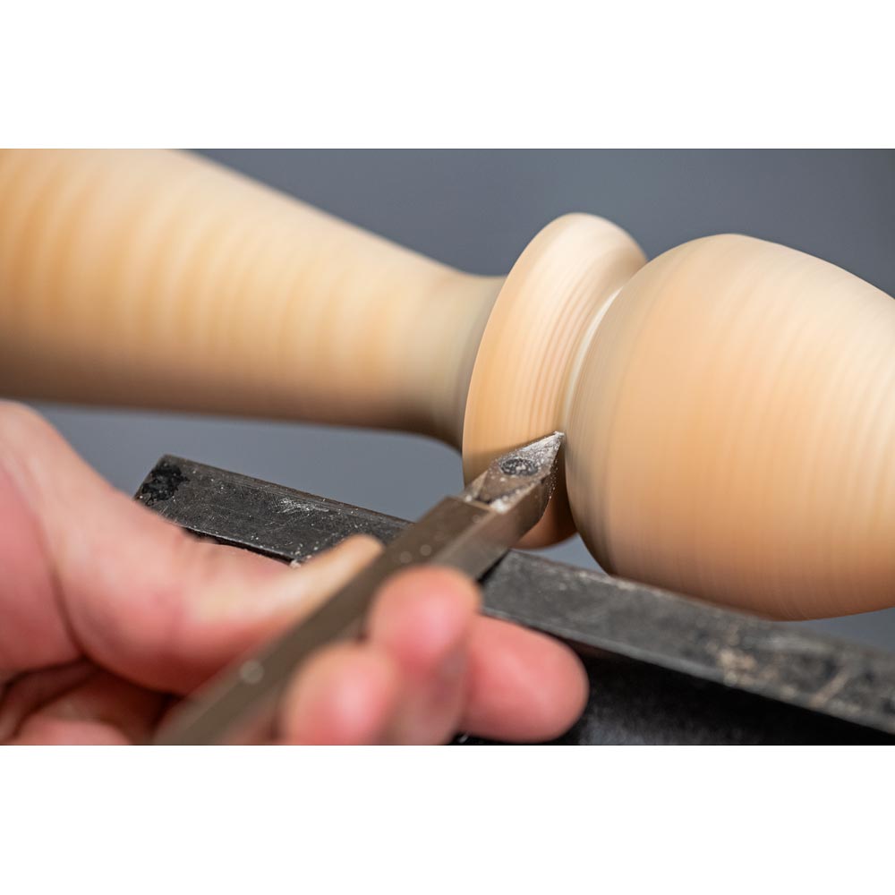

With the tool held parallel to the floor at centre height, the square bar maintains excellent stability on the rest, helping to minimise catches and snatches, even when working inside wide bowls or along lengthy spindles.
Its weight and geometry make it exceptionally effective for adding fine accents, shaping beads, sharpening transitions, and achieving crisp decorative features on substantial turning projects.
With no sharpening necessary, simply loosen the fixing screw and rotate the cutter to expose a fresh, sharp edge when dull.
Easy Wood Tools’ premium solid carbide outlasts HSS many times over and performs reliably on dry or green wood, acrylics, and resin.

Diamond‑shaped carbide cutter fitted as standard
Hex key for quick cutter rotation or replacement
508mm American Hickory handle with copper ferrule for strength
12.7mm square section bar for maximum stability on the tool rest
Colour‑coded handle for quick range identification
Shaft engraved with the carbide cutter reference number
Specifications
Overall length: 724mm
Handle length: 508mm
Bar profile: 12.7mm square
