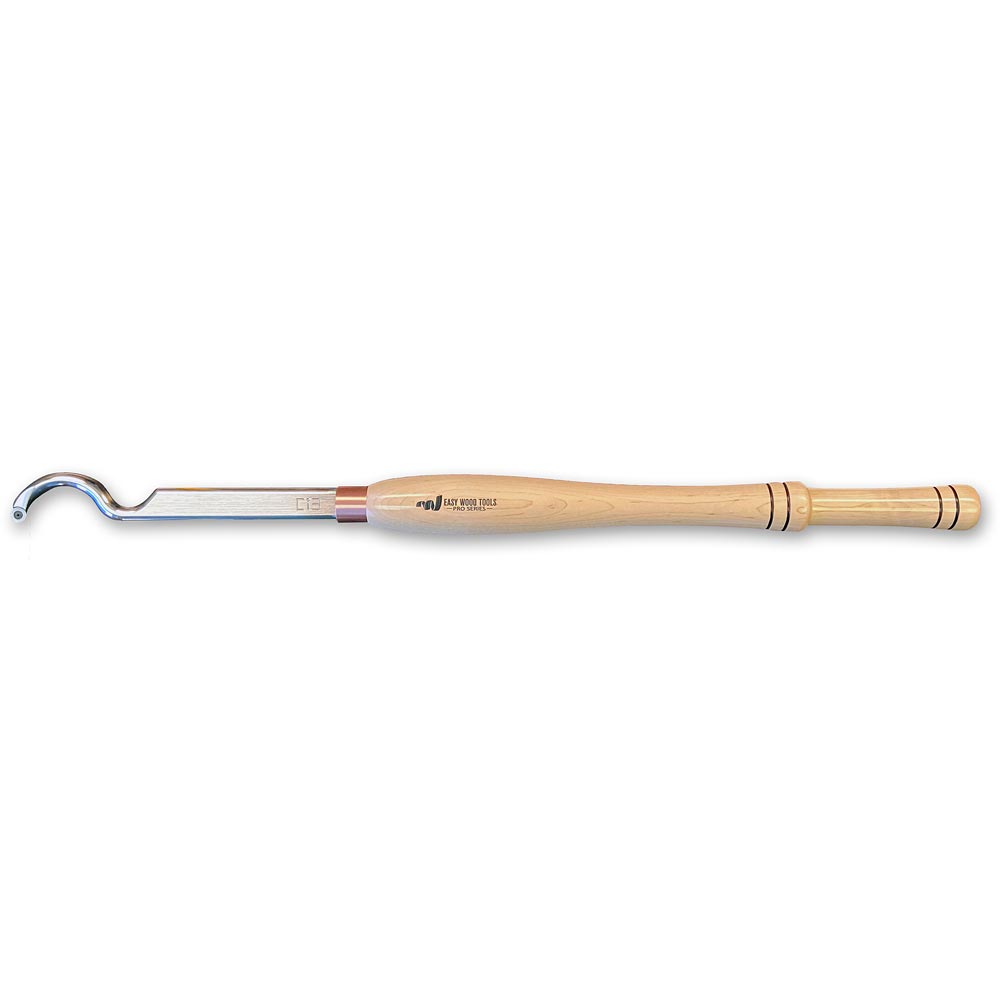

  • Hollower #3 for deep interior shaping and final refinement
  • Best for large hollow forms, deep vases, and substantial sculptural pieces
  • 12.7mm × 19mm rectangular shaft for exceptional rigidity & reduced chatter
  • Long Pro‑grade handle gives maximum leverage and stability
  • Solid carbide cutter lasts many times longer than HSS
  • No need to sharpen; simply rotate cutter to a fresh edge
  • American Maple handle with copper ferrule for strength
The Easy Wood Tools Pro Easy Hollower™ #3 is the final‑stage, deep‑reach tool in the Pro hollowing system, designed to access deep internal cavities and perform the last stage of hollow form refinement on large vessels, vases, sculptural forms, and substantial bowls.
As part of the largest and most robust range in the Easy Wood lineup, the Pro Hollower™ #3 provides unmatched reach, leverage, and stability, making it essential for turners working on deep, enclosed, or oversized hollow forms.
Featuring a solid carbide cutter and a rigid 12.7mm × 19mm rectangular shaft, the Pro Easy Hollower™ #3 provides exceptional stiffness and reduces chatter at maximum extension—critical when shaping deep, unseen interior walls.
The 508mm straight‑grained American Hickory handle offers superior leverage, balance, and comfort during long sessions, supporting smooth, controlled cutting even in the deepest parts of a vessel.
And, as with all Easy Wood Tools, no sharpening is required—simply rotate the cutter for a fresh edge.
Engineered for deep interior shaping and final surface refinement, the Pro Easy Hollower™ #3 excels when working far from the tool rest or inside narrow openings. Its rectangular shaft provides the rigidity needed for long‑reach cutting, helping to maintain wall thickness, refine contours, and achieve smooth interior surfaces before sanding.
Used parallel to the floor at centre height, the tool remains stable on the rest and helps minimise catches and snatches, even when cutting inside invisible cavities.
Hollower #3 brings the form to its final interior finish after the waste removal of Hollower #1 and the mid‑stage shaping of Hollower #2.
All Pro hollowers use long‑lasting carbide cutters that require no sharpening and outperform HSS by a significant margin.
They can be used on dry or green wood, acrylics, and resin, and are 100% made in the USA.

Solid carbide cutter fitted as standard
508mm American Hickory handle with copper ferrule
12.7mm × 19mm rectangular shaft for maximum rigidity
Colour‑coded handle for fast identification
Shaft engraved with the cutter reference number
Specifications
Overall length: 812mm
Handle length: 508mm
Shaft profile: 12.7mm × 19mm rectangular
Deep‑reach capability: approx. 200mm
Optional upgrade
Negative rake carbide cutters are available separately and provide enhanced control and a smoother finish on acrylics, resin, polyester materials, and difficult grain patterns—ideal for final interior refinement.
