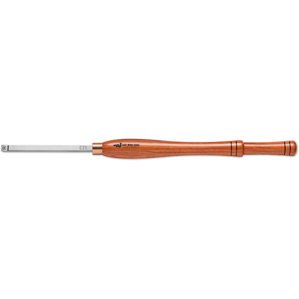

The Easy Wood Tools Pro Easy Rougher™ is a carbide woodturning tool designed for rapid, controlled material removal when turning large bowls, oversized platters, long spindles, table legs, and other substantial projects.
As the largest and most robust tools in the Easy Wood range, the Pro series provides maximum leverage, reach, and stability, making it ideal for heavy‑duty turning and extended sessions at the lathe.
Equipped with a square replaceable carbide cutter featuring a 100mm corner radius, the Pro Easy Rougher™ delivers smooth, predictable cutting with no sharpening required.
The substantial 12.7mm square section bar keeps the tool flat and steady on the rest, while the extra‑long 508mm American Hickory handle provides exceptional control, power, and reduced fatigue when working on the largest workpieces.
The Pro Easy Rougher™ is engineered for heavy stock removal, making it easy to shape large, dense, or deep blanks with confidence.
When used parallel to the floor at centre height, the flat bar design ensures the tool remains stable, helping to minimise catches and snatches even during demanding cuts.
Its weight, reach, and mass make it exceptionally efficient for rough shaping of big forms before switching to Pro finishing or detailing tools.
With no sharpening needed, simply rotate the cutter to a fresh edge when dull.
Easy Wood Tools’ premium solid carbide outlasts HSS many times over and works effectively on dry or green wood, acrylics, and resin.
What you get
Square carbide cutter with slight 100mm radius
Hex key for easy cutter rotation or replacement
508mm American Hickory handle with copper ferrule for strength
12.7mm square section bar for maximum tool‑rest stability
Colour‑coded handle for quick recognition across the Pro range
Shaft engraved with the carbide cutter reference number
