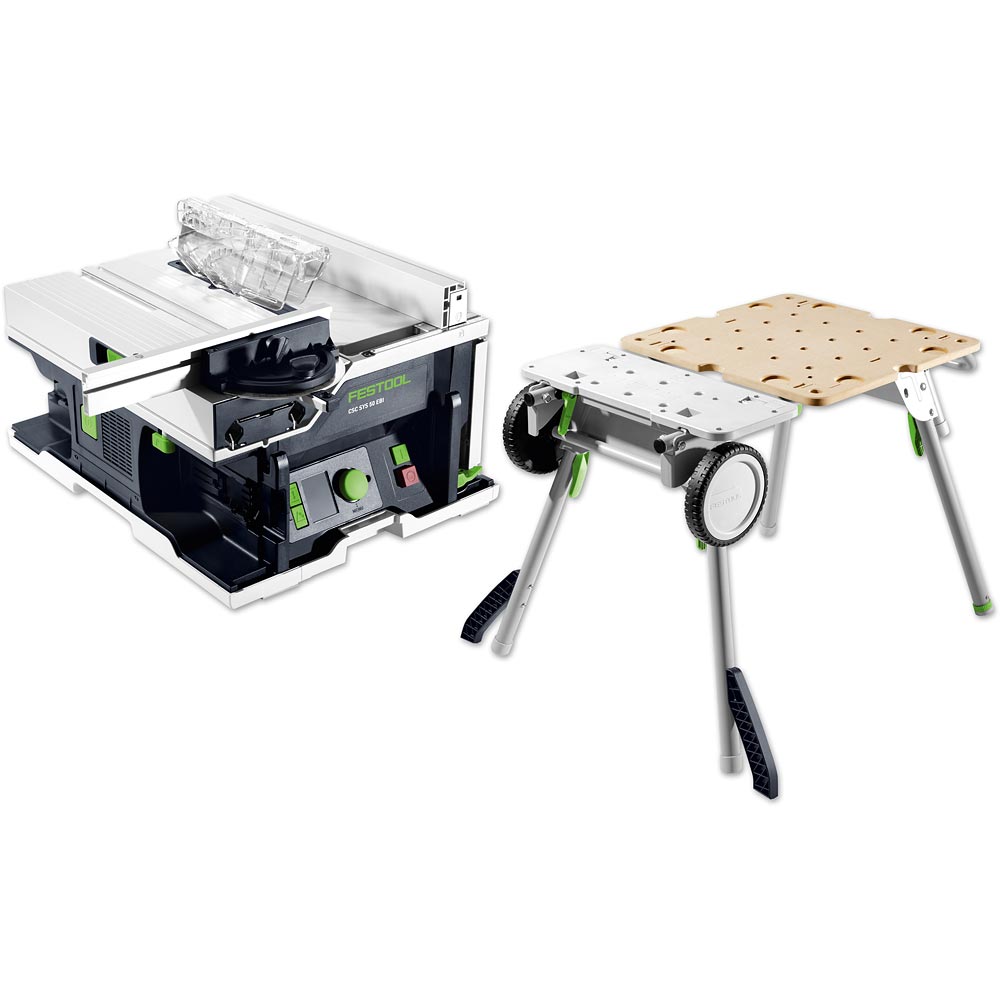

  • A table saw and trolley/leg stand for easy transport
  • A cordless saw with mains power performance
  • Digital display for both blade height and blade tilt
  • Set the depth of cut to within 0.1mm
  • Set blade angle to within 0.1
  • Low maintenance, powerful EC-TEC motor
  • Systainer lid features storage for the fenc

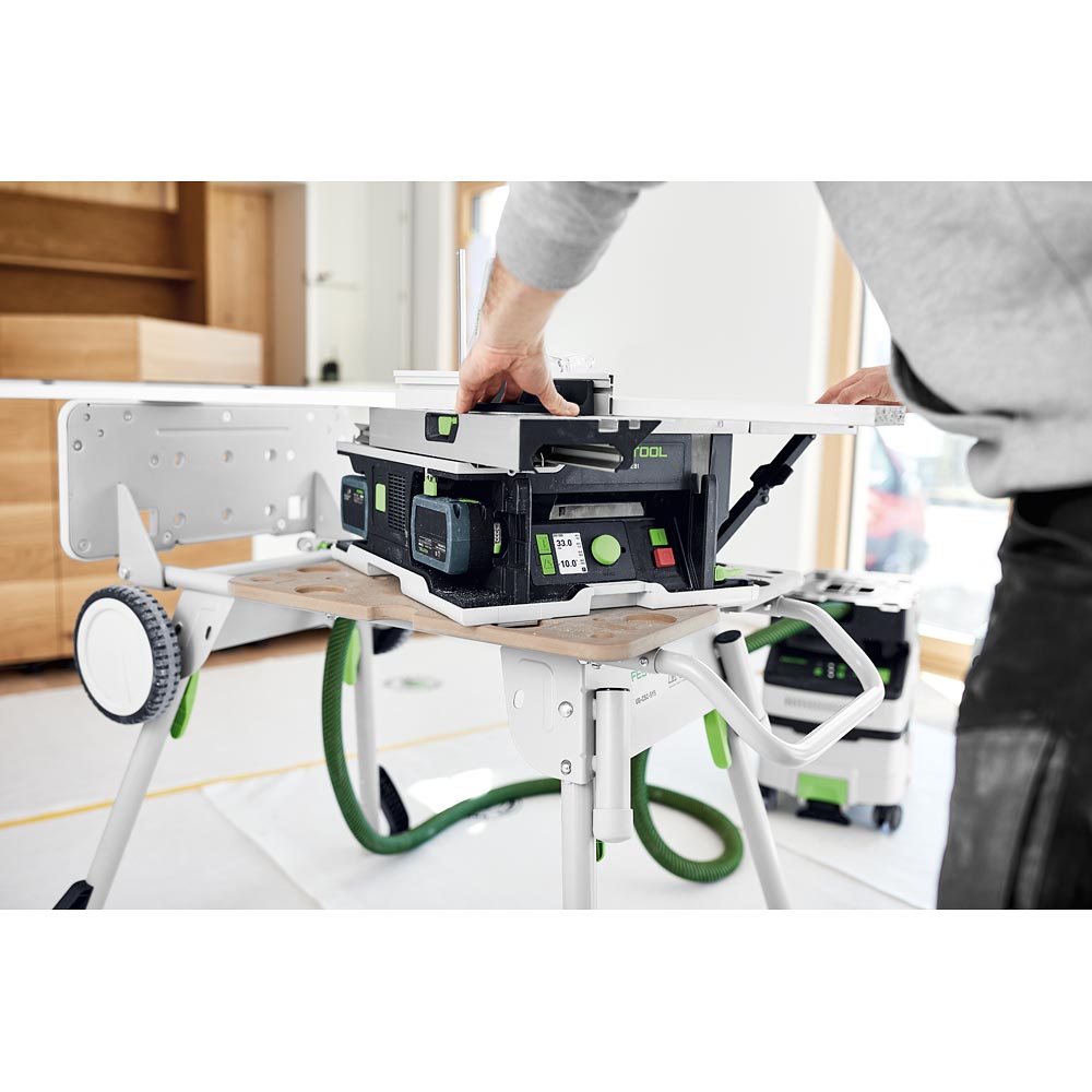

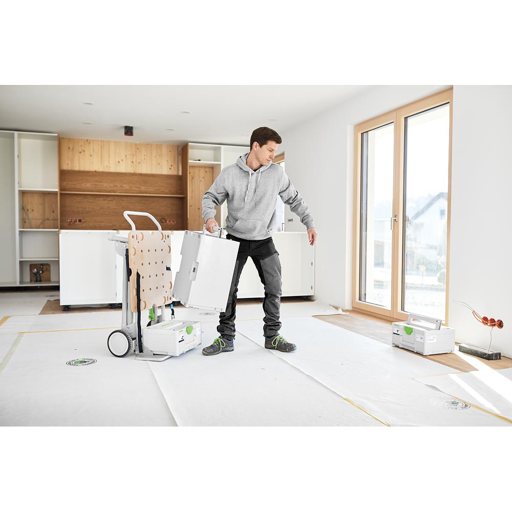

The CSC SYS 50 cordless table saw and the UG CSC SYS Underframe is the perfect combination, offering mobility, stability and great functionality. The CSC SYS 50 with its Systainer format along with the large wheels on the UG CSC SYS makes transportation a breeze.

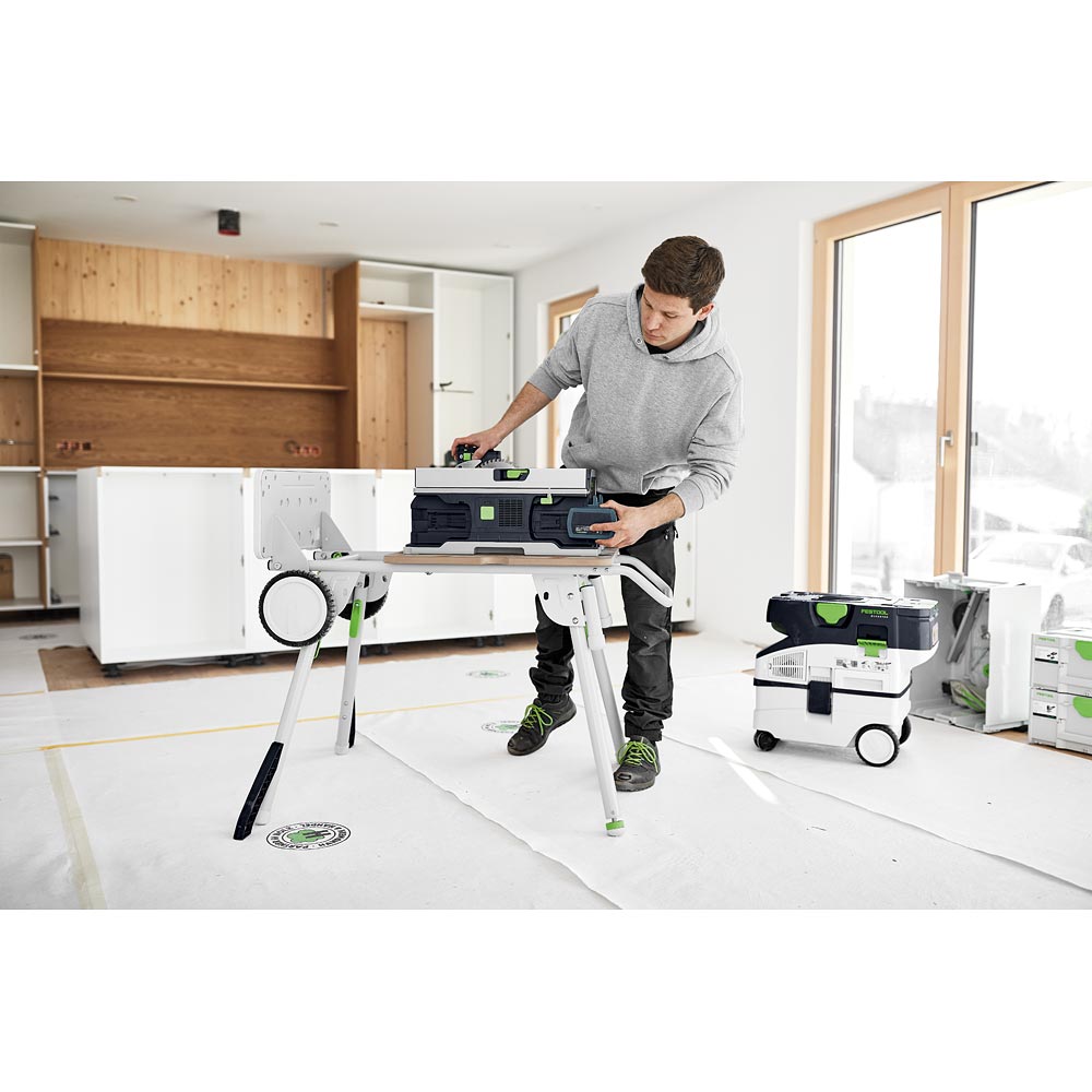

When you arrive on site, the UG CSC quickly turns into a dual height leg stand; with the legs deployed, the working height with the saw is a comfortable 900mm. Alternatively, in cases where working closer to the ground is preferable, such as floor laying, with the legs folded, the working height is 245mm.
The CSC SYS 50 Saw is fully compatible with the entire Festool Systainer system. Power comes from two 18V batteries (from 4.0Ah upwards) in combination with a brushless EC-TEC motor, resulting in performance more than comparable to a mains-powered machine. NOTE: this is a body only machine supplied without batteries or charger.
The outstanding feature has to be the digital display for both blade height and blade tilt. Select the function, then turn the knob to set the depth of cut to within 0.1mm or the blade angle to within 0.1°. Reproducing cuts couldn’t be more accurate, the digital display ensures precise results. Four saw blade positions can be saved and selected via the digital display. The height and angle are electrically adjusted at the press of a button.
The brushless EC-TEC motor with high speeds of 6,800 rpm guarantees fast sawing progress. The CSC SYS 50 allows you to make parallel rip cuts of up to 280mm wide and cross-cut widths of up to 450mm. The maximum depth of cut is 48mm and the blade tilt; from -10° to 47°.
On the left hand side the super smooth sliding table and mitre crosscut fence allow cutting up to 450mm in front of the blade and mitre angles from -70° to +70°. On the right hand side a fold down table extension and rip fence allow cuts of up to 280mm wide. The rip fence locks front and back with a single clamping lever.
Supplied with 42 tooth TCT saw blade and chip collection bag. Alternatively, it can be connected to a suitable vacuum dust extractor.
