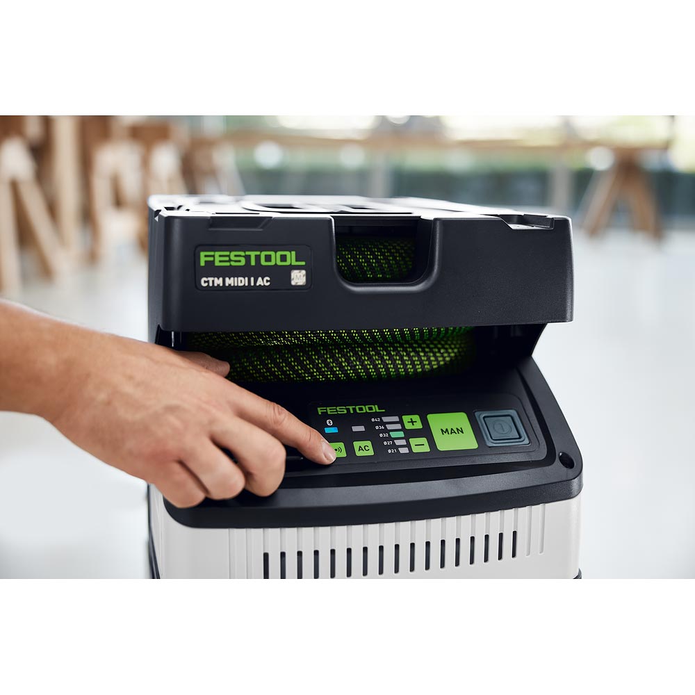

It features variable suction and manual filter de-dusting for maximum efficiency. Hose detection automatically adjusts suction to the diameter of the hose in use. An innovative and intuitive touch control panel makes operating the controls extremely simple, even when wearing gloves. Fitted with integrated Bluetooth technology; it allows you to use the extractor in conjunction with a remote control or a Festool Bluetooth battery pack for automatic switching-on. Unique access to the main filter from the outside makes changing the filter quick, easy and tool-free.

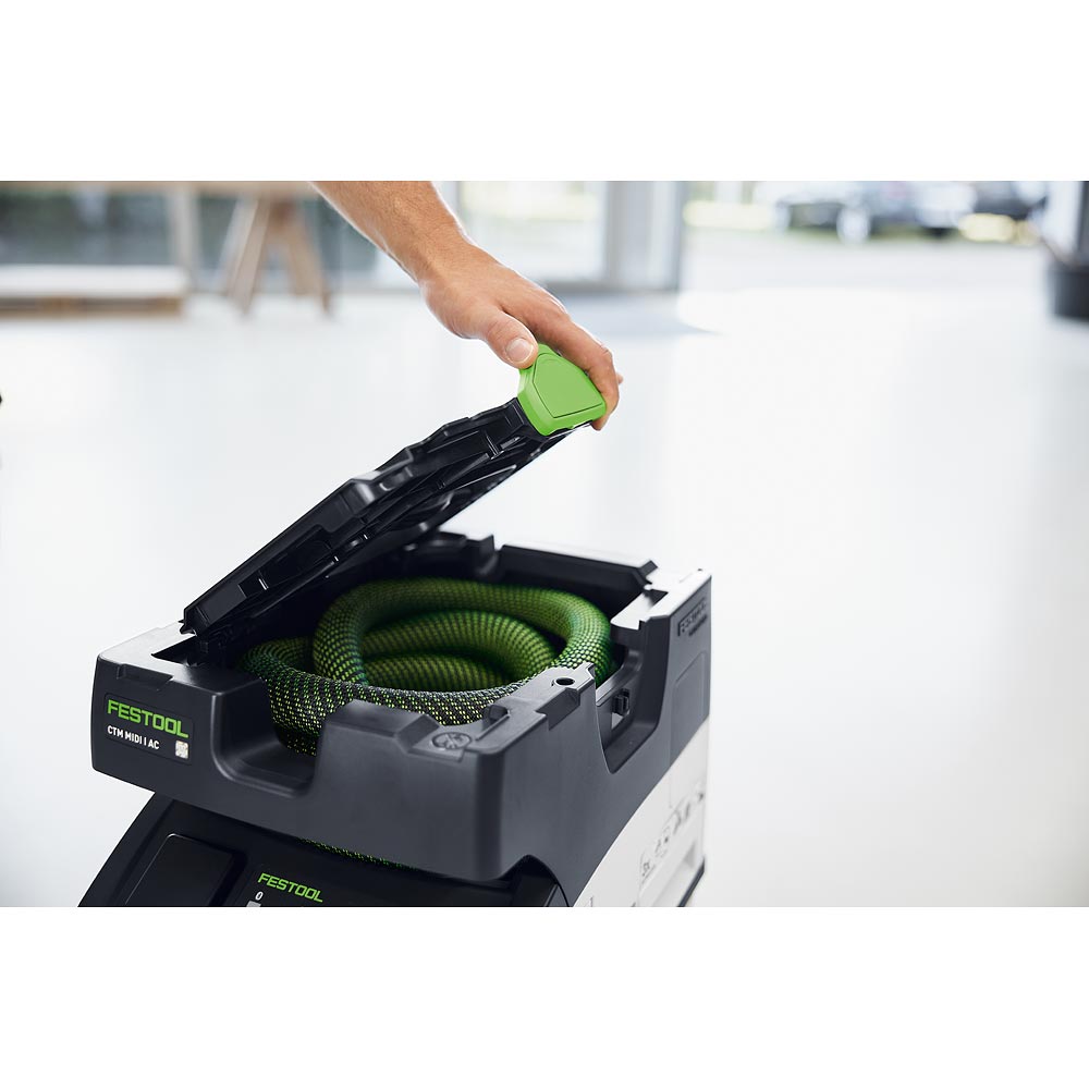

The extractor has a flat top, providing space for tools and SYSTAINER cases. The top is T-LOC compatible; SYSTAINER cases lock and stack, for transporting of your other Festool power tools. The castor wheels are lockable. On-board storage for both the hose and power cable keeps everything neat for easy transportation.
