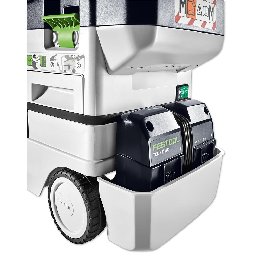

Low weight, compact and full of innovation. The CTMC MIDI cordless dust extractor frees you from the constraints of mains power. Cordless tools with a cordless extractor; makes complete sense. The CTMC MIDI is a 36V machine, power is provided by using two 18V batteries, (note this is a body only tool, batteries not included). It boasts 15 litre capacity for class L dusts and plenty of suction power to cope with or sanding or sawing.

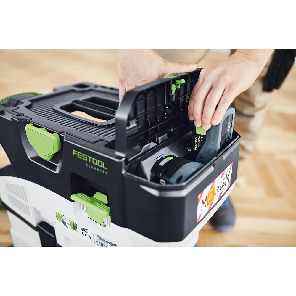

The hose stores very neatly in the top of the extractor, so you don’t need to carry it separately. The top of the CTMC MIDI is compatible with T-LOC Systainers, allowing you to connect your power cases, for easy transportation.

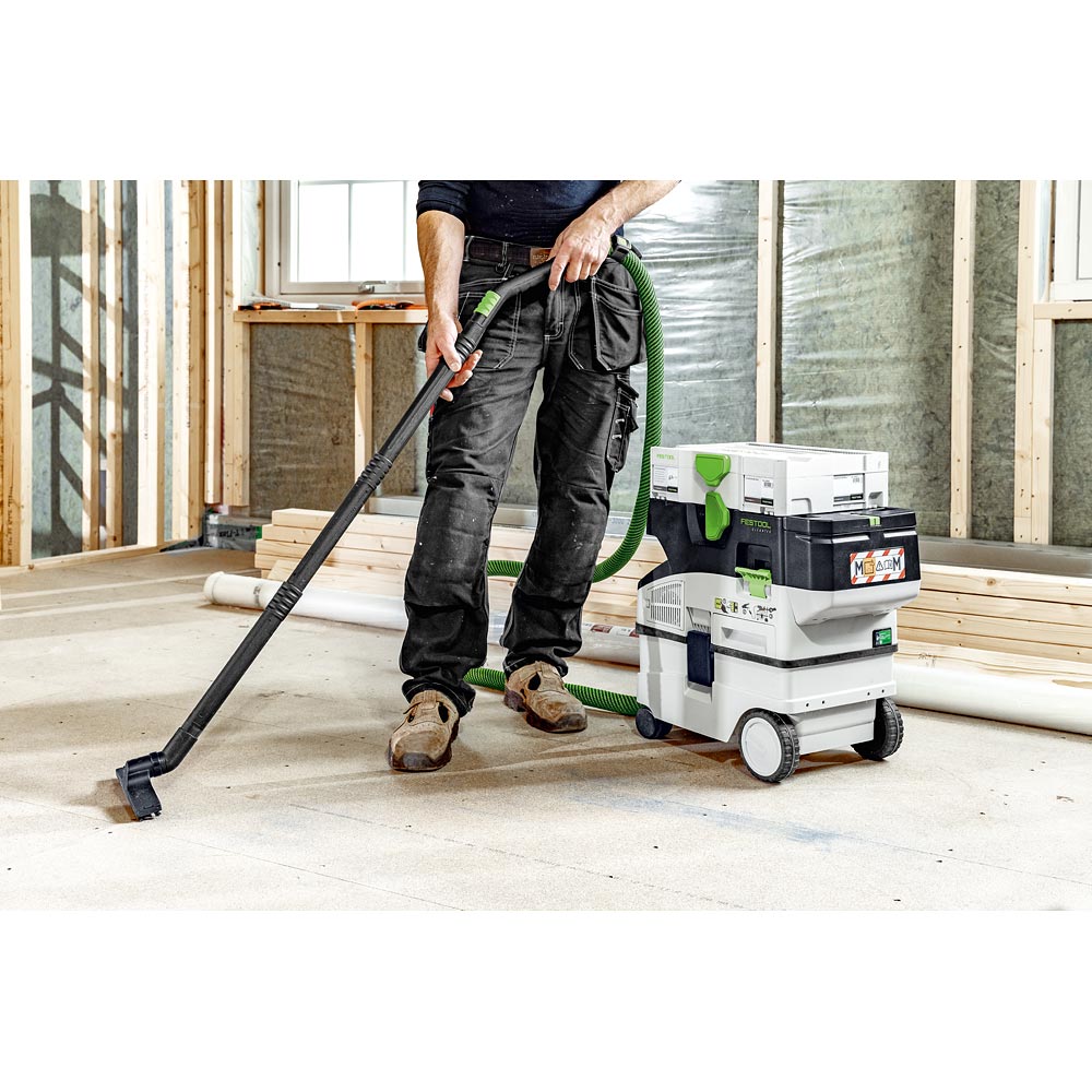

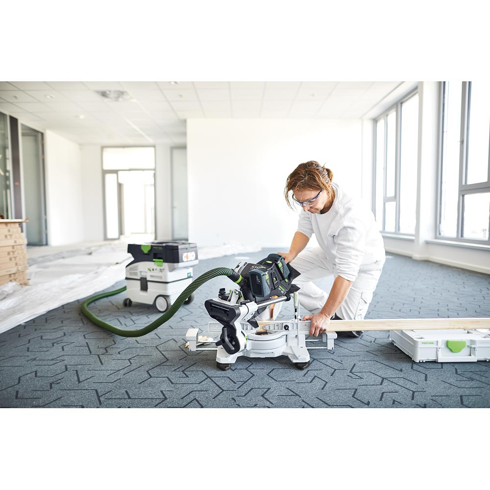

The 3.5m smooth hose means you no longer need worry about hose snagging on edges or inadvertently damaging a workpiece. The CLEANTEC bayonet fitting ensures a secure connection to your power tool and a quick disconnection.

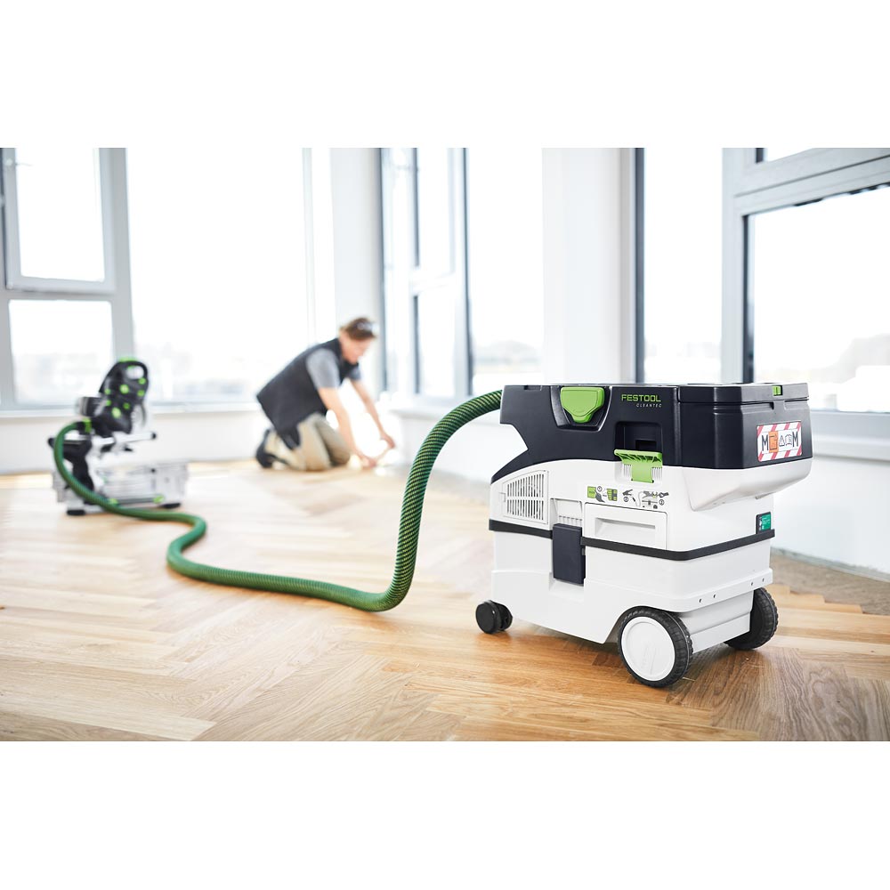

The CTMC MIDI includes a CT-F I Bluetooth remote control, which communicates Festool Bluetooth battery packs for auto switching the extractor on when the tool is switched on. Access to the main filter is from the outside for easy cleaning to maintain maximum efficiency. The CTMC MIDI compact dust extractor fits perfectly into the Festool 18V system.
