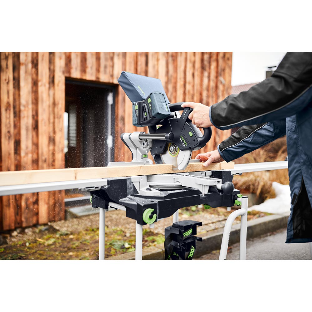

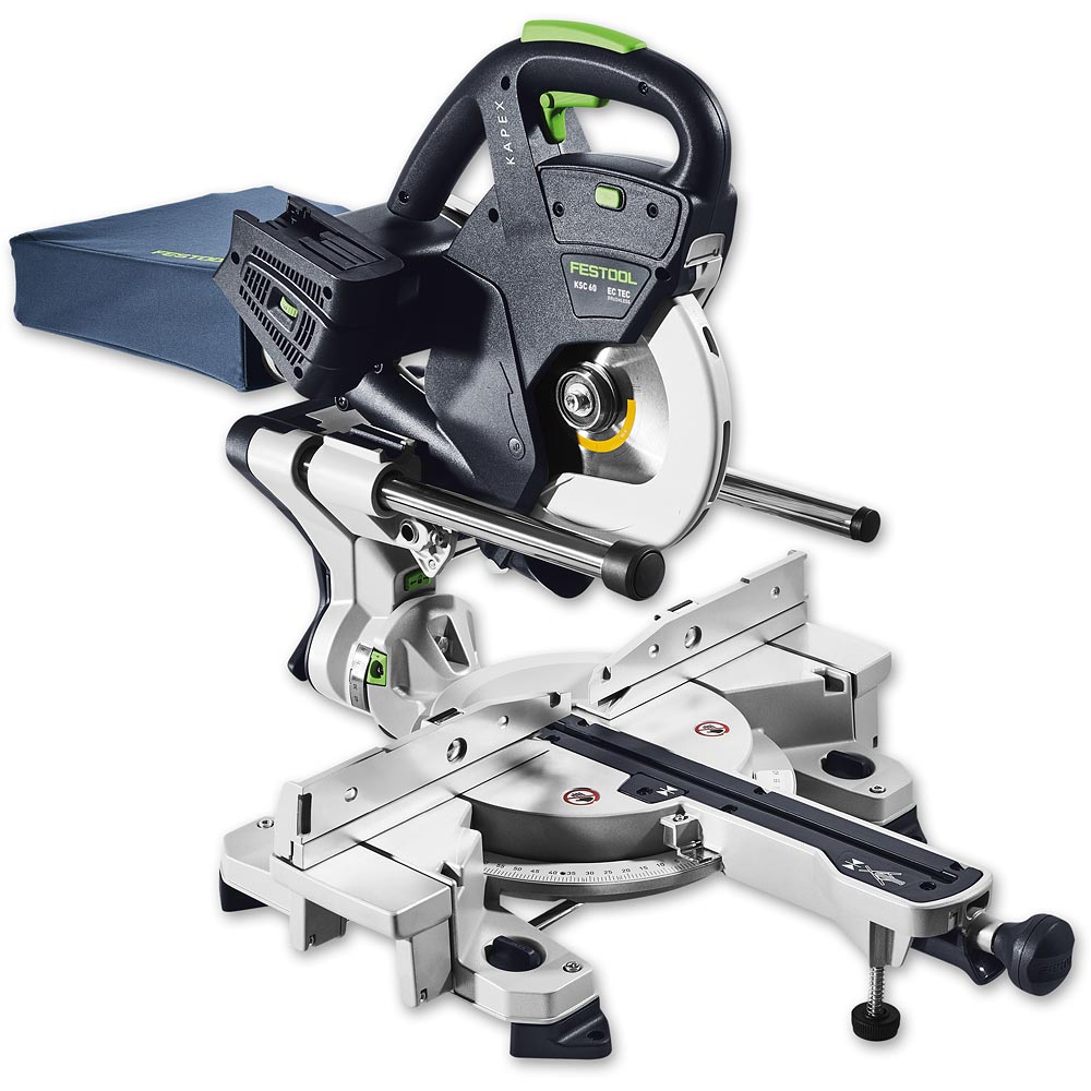

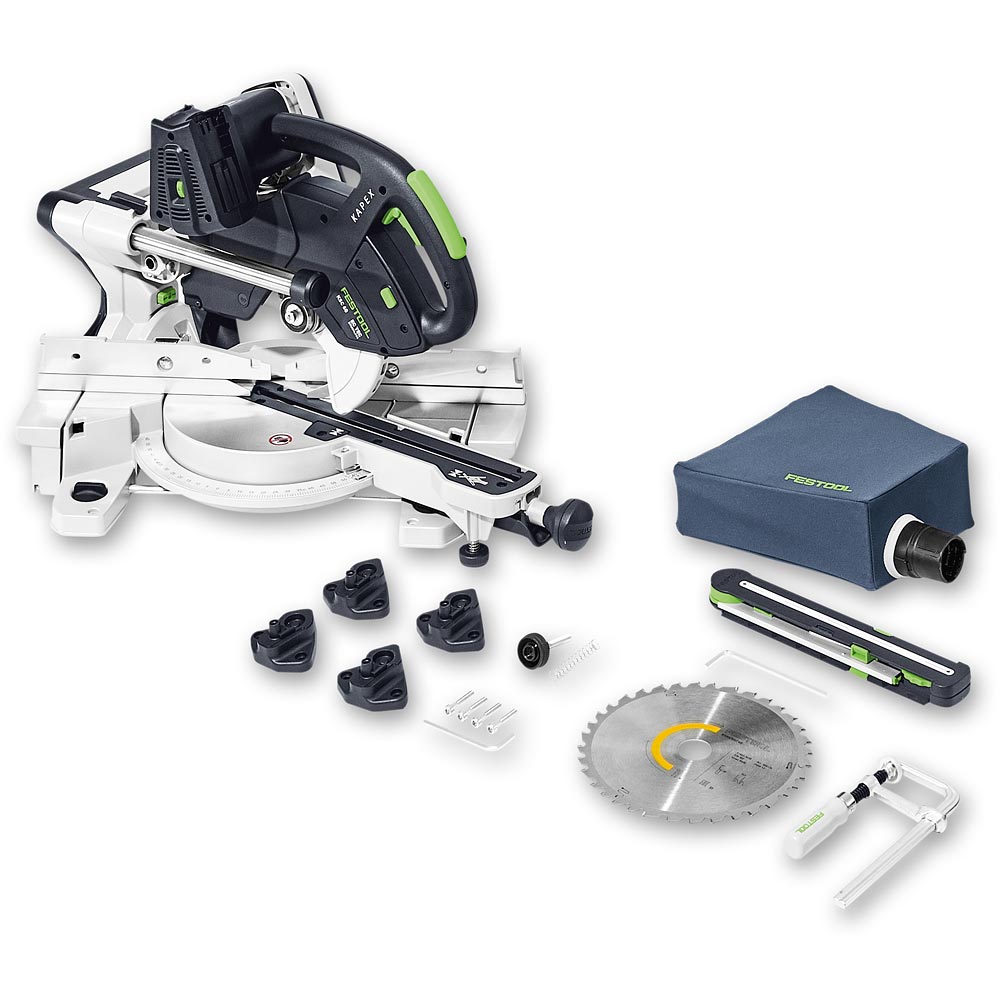

The Festool KAPEX KSC 60 cordless sliding compound mitre saw combines the freedom of a battery powered tool with the performance of a mains powered machine. The brushless EC-TEC motor coupled with dual 18V battery power can provide enough runtime for a typical full day's work. The KSC 60 produces unbeatable precise crosscuts. Mitre angles of up to 60 on each side with indents at common angles and bevel angles 47 L and 46 R, with stops at 45 for fast setup.
The twin guide bars with two bearings each ensure that the saw blade moves smoothly and precisely at every angle; making every cut perfect. The variable speed can be preset for the best results for the material in use. The low weight, compact design and convenient handles make this easily portable for work on site. An LED spotlight highlights the cutting line ensuring good visibility of a scribed cutting line. A large dust bag is supplied making for a cleaner workspace even without a mobile dust extractor. Pull out extension tables on each side provide support for longer workpieces.
The additional feet bring the height of the KSC 60’s table to the exact same height of an SYS 3 M 112 or SYS 1 Systainer case.
Includes a Festool bevel which transfers interior or exterior angles to the saw for a perfect mitre every time.
Supplied with; dust bag, clamp, additional feet, 36 tooth TCT blade and Bevel SM-KS.
Please Note; this is a body only machine supplied without batteries or charger.
Part of the Festool 18V family.
