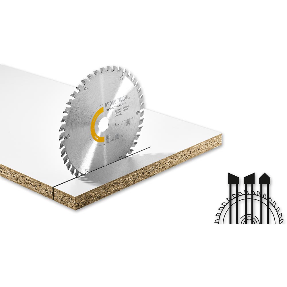

  • 1.8mm thin kerf saw blades for maximum performance
  • Cut faster and achieve a perfect result
  • Rapid cutting with exceptional clean finish
This high tech, high spec blade ensures the job gets done faster and with a better result. These new generation of thin kerf saw blades are designed to give maximum performance. The 1.8mm thin kerf saw blade and tooth geometry allows you to work faster, reduces the load on the machine.
The blade teeth are high-quality carbide resulting in a long service life. The tooth format is alternate bevel with a raker tooth (ATBR) producing rapid progress with a very clean finish.
These blades fit the Festool TS 60 plunge-cut saws.

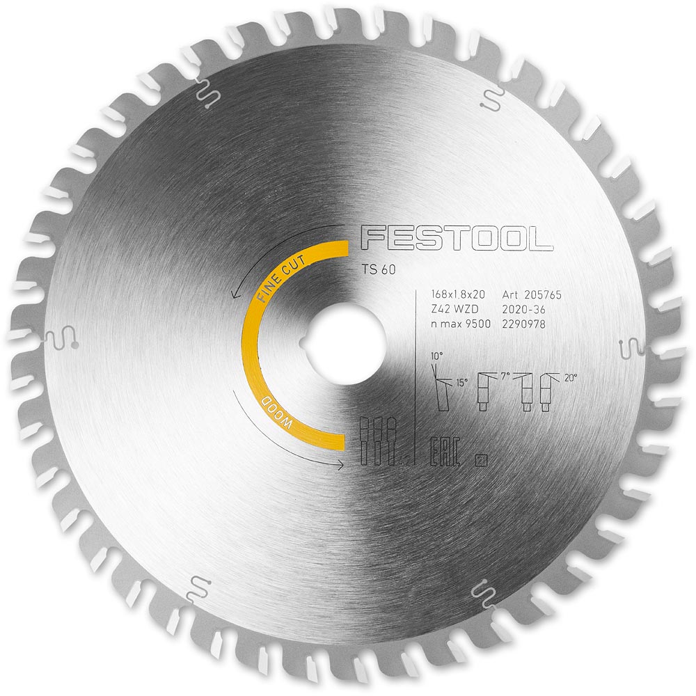

Blade Diameter 168 mm
Maximum RPM 9,500 rpm
Manufacturer Part Number 205765
Kerf 1.8 mm
Teeth 42
Tooth Format ATBR
Plate Thickness 1.2 mm
Hook Angle 10
Bore Size 20 mm
