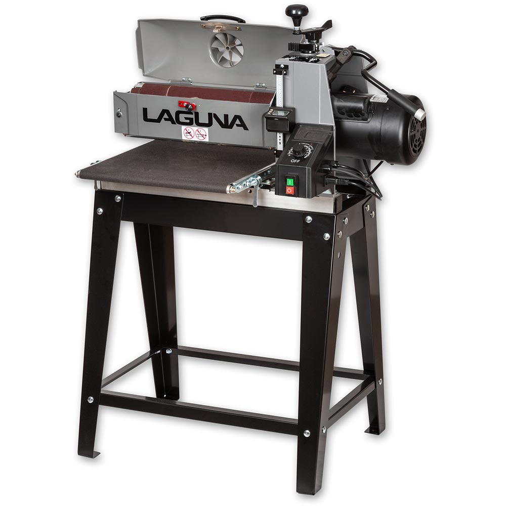

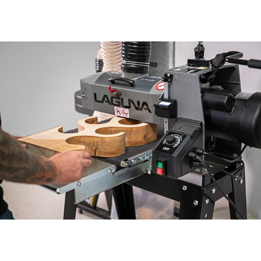

  • Open-ended drum, allows 800mm sanding width in two passes
  • Patented quick adjust lever reduces set-up time and boosts productivity

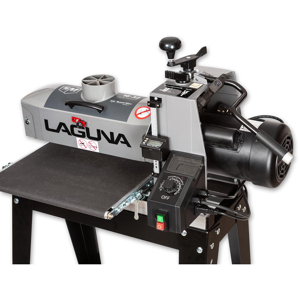

  • Built-in digital readout (DRO) ensures consistent thickness
  • Variable speed conveyor table automatically adjusts for a consistent finish

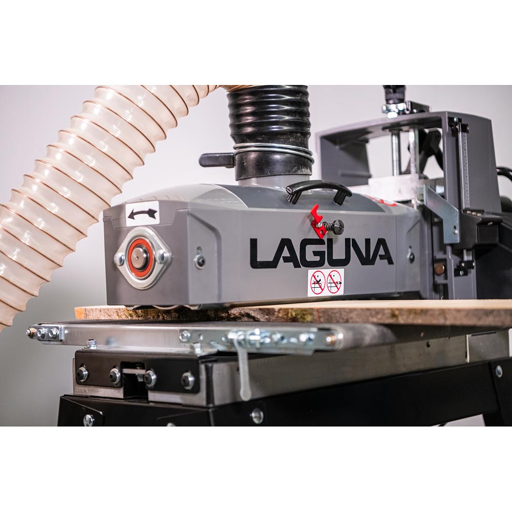

  • Turbo vented dust port increases airflow to a dust collector
  • Drum carriage is bolted to the base, eliminating movement
The Laguna Supermax 16|32 Drum Sander is a compact powerhouse, meticulously engineered for top-tier efficiency and precision, delivering professional-grade sanding performance. This sander is brimming with innovative features that guarantee accuracy, productivity, and user-friendliness.
The open-ended drum design allows for 400mm in a single pass and an impressive 800mm maximum sanding width in just two passes, making it perfect for larger projects and enhancing the sander's versatility. The patented quick adjust lever enables full height adjustments with a single pull that can then be finely adjusted with the handwheel, significantly reducing set-up time and boosting productivity.
For consistent thickness and superior quality of output, the sander is equipped with a built-in digital readout (DRO). The INTELLISAND technology features a variable speed conveyor table that automatically adjusts to maintain a consistent finish, accommodating varying grain patterns and densities.

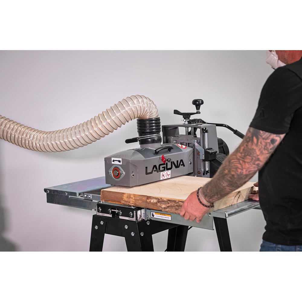

Dust management is a breeze with the 100mm diameter turbo-vented dust port, which increases airflow to a dust collector by 15%, enhancing dust removal when connected to a suitable dust extractor. Perfect feed alignment ensures that the drum carriage is bolted to the base, eliminating any movement or alignment issues. Additionally, a simple adjustment feature allows the conveyor to be quickly and easily aligned to the sanding head with just one nut.
When sanding stock wider than 400mm and making two passes, the index lever will adjust the conveyor to give a seamless finish. Built to last, the robust construction of the Laguna Supermax 16|32 Drum Sander includes a floor stand and comes with a 1 x 80G wrap, ready for immediate use. Experience the ultimate in sanding performance and efficiency with this exceptional tool.
