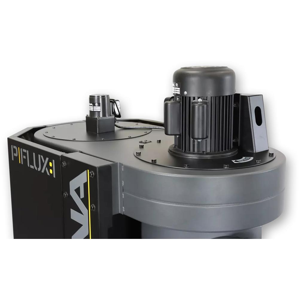

The Laguna P|Flux 1 Cyclone Extractor HEPA is designed to revolutionise your workspace. This advanced extractor combines powerful cyclone technology with two-stage separation of chips, shavings and dust particles, ensuring a cleaner, healthier environment. Designed for efficiency, convenience, and performance, this extractor is the perfect addition to any serious workshop. Smaller in size compared to the P|Flux 3, this cyclone extractor has a more condensed capacity of 95 litres and a 1.1kW motor to suit smaller workshops. Invest in solutions that elevate your workspace with Laguna.
One of the standout features of the Laguna P|Flux 1 is its cyclone technology. This powerful cyclone system effectively separates fine dust from larger waste chippings, preventing clogging and maintaining consistent suction power. The result is a cleaner workspace and improved efficiency in your dust collection process. This system not only improves the performance of the extractor but also extends the life of the filters. A small drum is located underneath the HEPA canister which collects very fine dust. Check the viewing window periodically and empty if needed.
The high-efficiency particulate air (HEPA) filter is another key component of this extractor as it allows even the smallest dust particles, down to 0.4 micron, to be captured. Previously, HEPA material was too delicate to incorporate an internal paddle cleaning system. However, a recent innovation has introduced a Teflon membrane on the inner wall of the HEPA material. This membrane improves the inner surface of the filter, enabling dust to move down more smoothly and quickly, reducing dust build up on the wall. As a result, the filter's efficiency and lifespan are extended, and it becomes durable enough to accommodate the cleaning system.
The upkeep is effortless with the fully automated paddle cleaning system. During operation, cleaning automatically begins every 10 minutes and every time the cyclone is stopped. This maintenance-free feature ensures your filters remain clean and operate at peak performance, reducing downtime and ensuring consistent performance. The 0.4 micron pleated filter ensures that even the finest dust particles are captured. The filter is easy to clean and maintain, providing long-lasting performance. A further enhancement is the riveted steel fan with a backward curved fin design. This robust fan delivers powerful suction while maintaining energy efficiency, ensuring that your extractor operates at its best.
Noise levels are kept to a minimum thanks to the swing-away doors with acoustic foam liner. This design feature reduces the noise generated by the extractor, creating a quieter and more pleasant working environment at just 70dB.

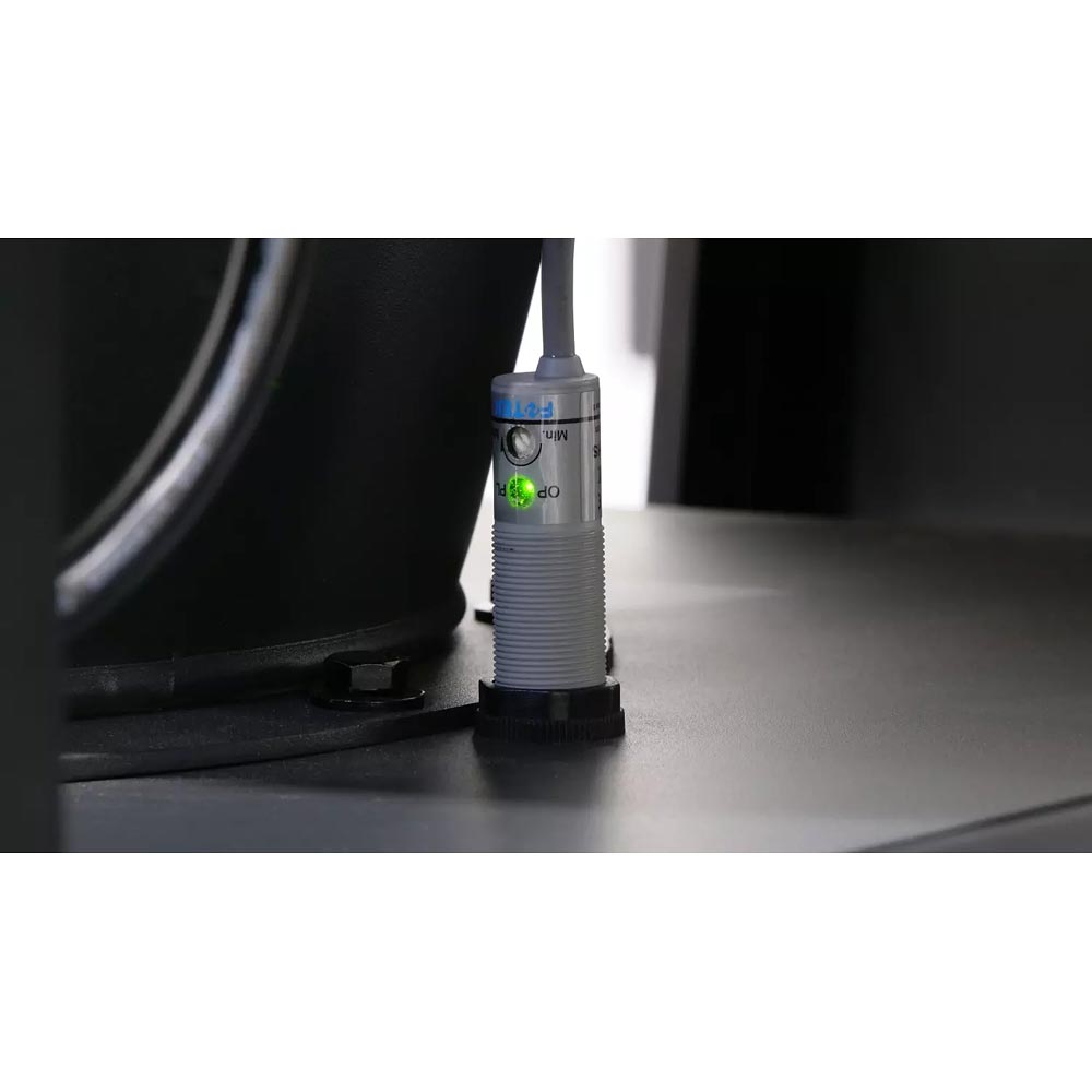

Convenience is at the forefront of the P|Flux 1 design, with a remote control that allows you to start and stop the extractor from a distance. Operator signals, including a warning light and audible alarm, alert you when the collection drum is full. This feature ensures that you never have to guess when it's time to empty the drum, preventing overflows and maintaining optimal performance. The LED drum illumination provides clear visibility inside the collection drum, alongside the inspection window, making it easy to monitor the dust levels and ensure timely emptying. The semi-automatic emptying system allows for no-mess disposal of fine dust collected in the canister drum, keeping your workspace clean and tidy.
Ease of use is another key consideration of the Laguna P|Flux 1. The collection drum instantly detaches for quick and easy emptying, while the simple connection hose inlet with splitter and rubber blanking caps makes setup effortless. The 150mm main inlet is provided with a splitter which converts to two 100mm outlets. The machine is highly portable, with four swivel castors that allow you to easily move it around your workspace. This feature ensures that you can position the extractor exactly where you need it, providing maximum flexibility and convenience.
