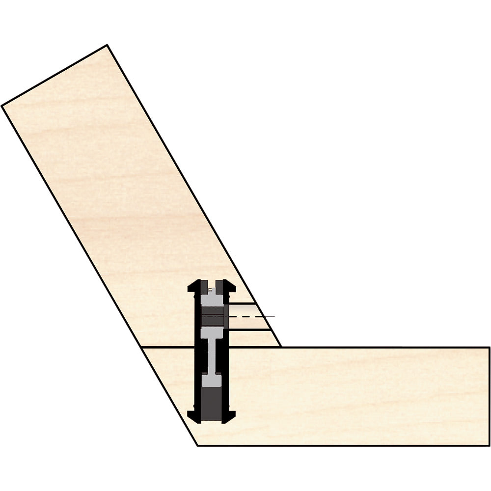

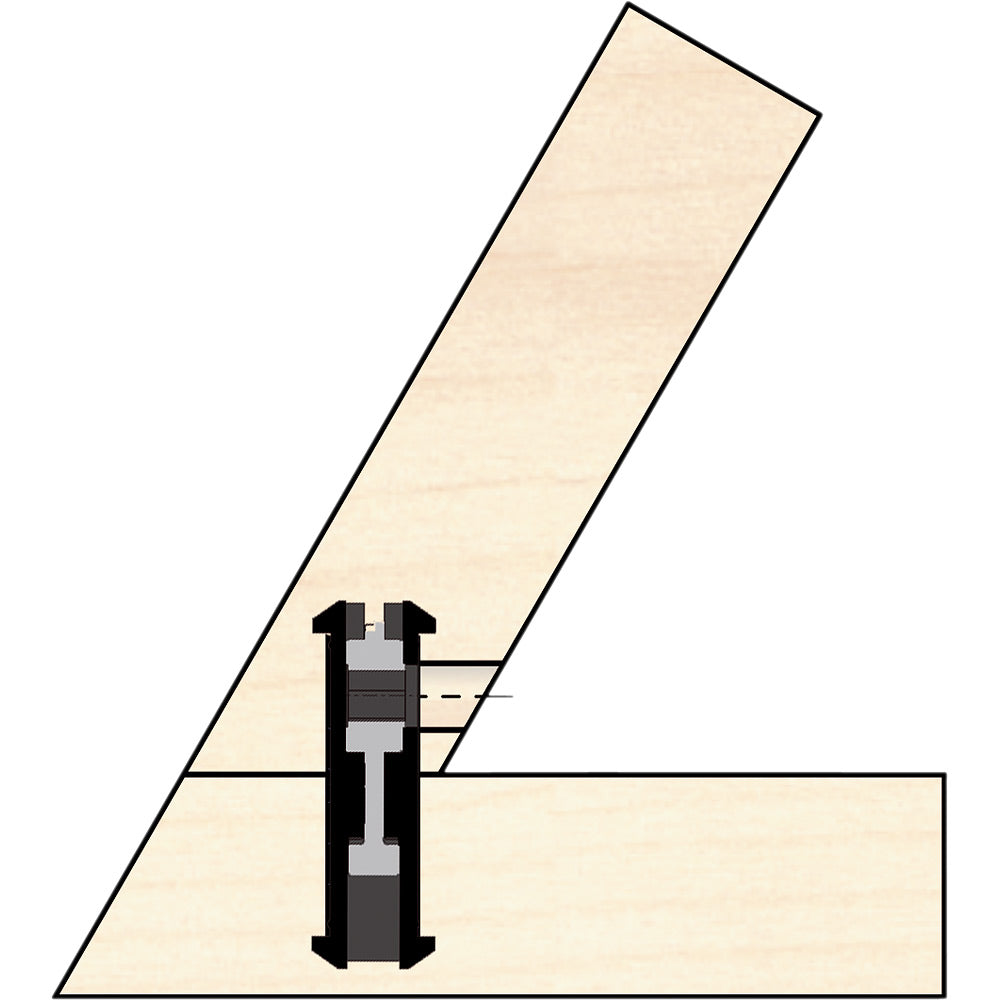

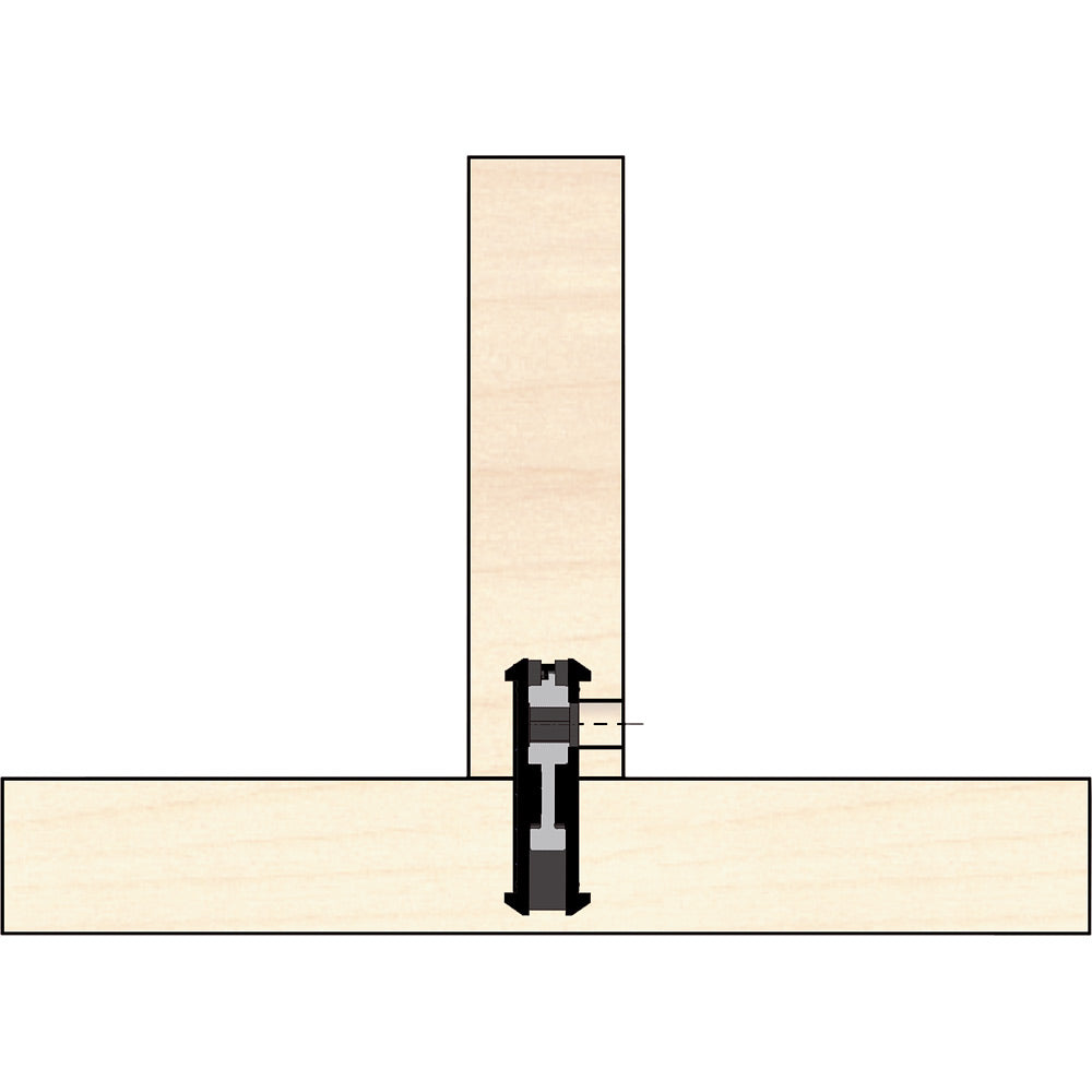

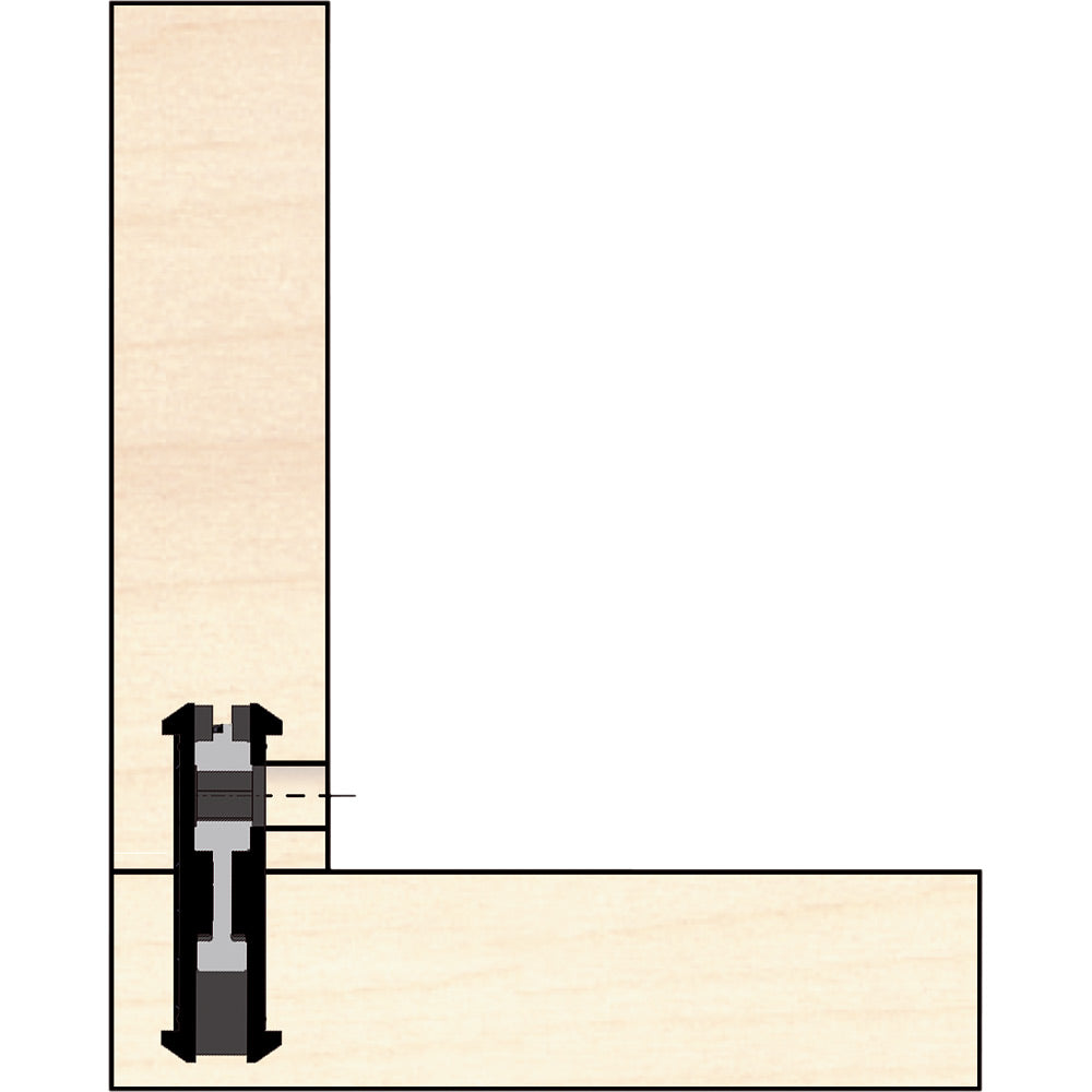

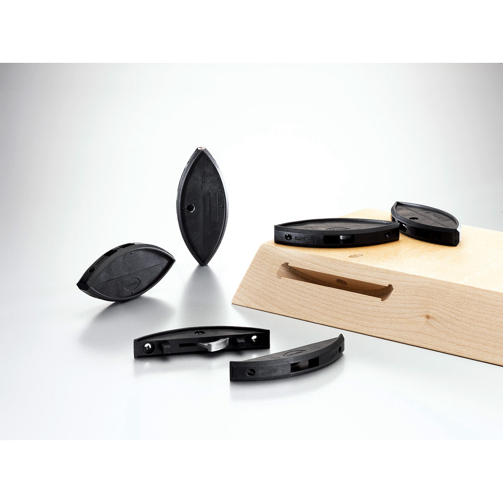

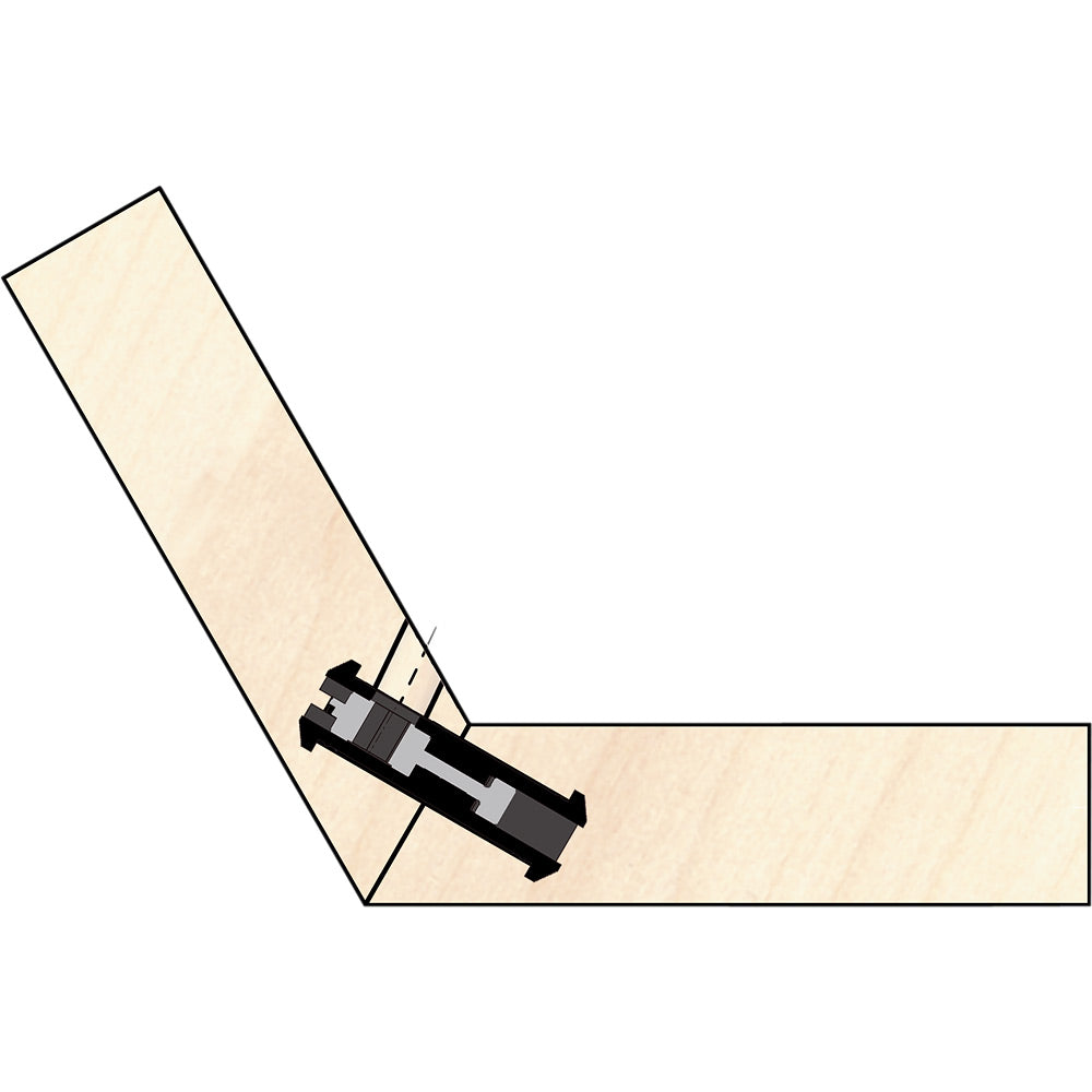

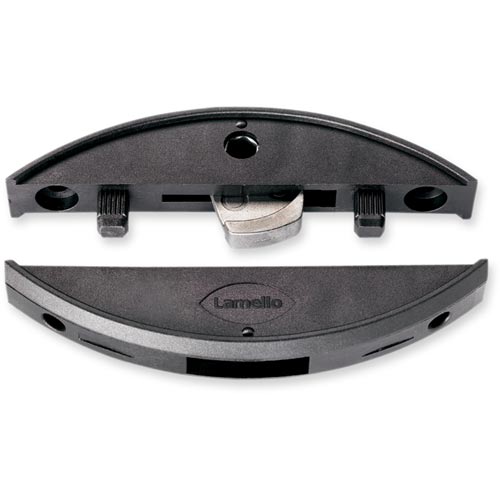

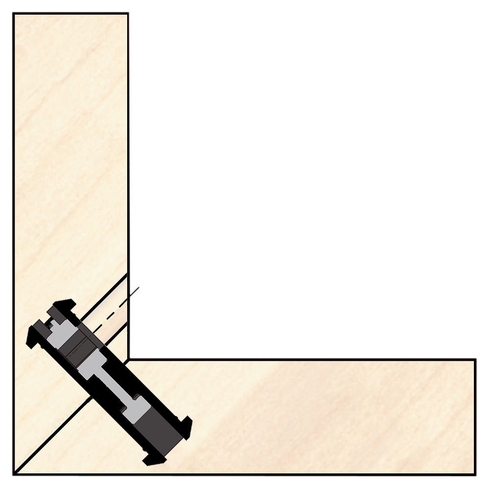

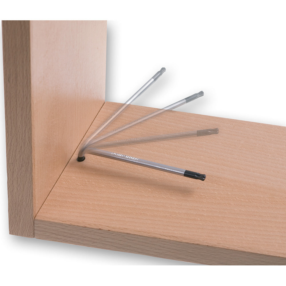

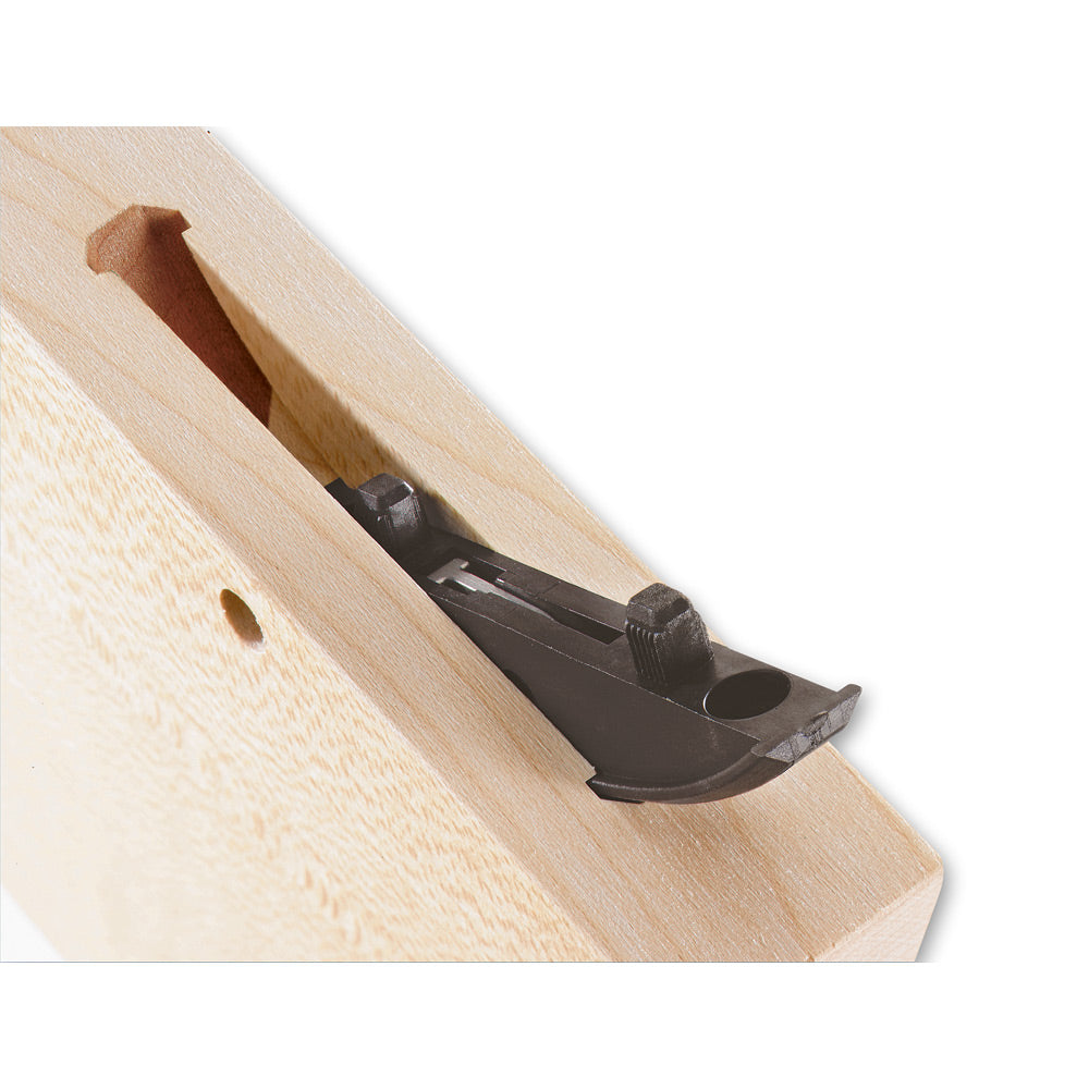

Part of the Lamello Zeta range of connectors, the P-10 is small for connecting 13mm panels. Designed to overcome many design assembly problems, this clamping connector is almost totally invisible with only a single 6mm hole showing on the finished joint. The P-10 is biscuit in shape with a special 'T' profile, one side is fitted with a pivot lever and two alignment studs, this can then be clamped to the other mating piece and locked. The lever is driven using a hexagon key though the 6mm hole. The pocket for the P-10 needs to be cut with a Lamello Zeta machine specially developed for this application, cutting the slot and adding the 'T' to the bottom using a unique vertical mechanical drive. Once cut, the connector simply slides in place, no screws or glue are needed. Made from fibreglass reinforced plastic for strength. Overall length is 52mm x width 19mm, each half has a depth of 9.7mm, it is 7mm in width (9.7mm o/a with 'T'). Requires P-10 drill guide.
