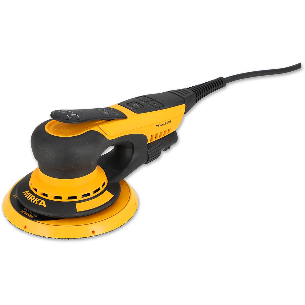

The DEROS II 5650CV is supplied with both 125mm and 150mm pads for greater versatility. It is one of the most compact random orbit sanders on the market today. With its ergonomic design and low weight (only 1kg), it is perfect for all prolonged use in almost any position - flat, overhead or vertical.
The sander features upgraded power compared to previous models; the body of the machine houses a 400W high performance, smooth running brushless motor for increased service life, and maintains constant speed even under load. The DEROS II 5650CV is fitted with a soft start and electronic brake. The sanding speed is adjustable, with the range covering 4,000 - 10,000rpm. The updated design makes it easy for the operator to change the speed; LED indicators are located on the speed selector, together with a separate on/off switch and lockable speed for optimum control. The DEROS II 5650CV has a closed construction so that no dust can enter the machine. One of the key features of the Mirka DEROS II is the enhanced Bluetooth low energy technology, which allows you to monitor vibration levels, in real-time on a smartphone or tablet via the myMirka app.
The 125mm and 150mm backing pads can be exchanged quickly to suit your application; both pads have a universal hole pattern to enable the fitting of many different makes and types of abrasive disc.
The DEROS II 5650CV comes in a T-LOC storage case along with 150 Abranet discs (150mm diameter, 80 to 180 grit).
