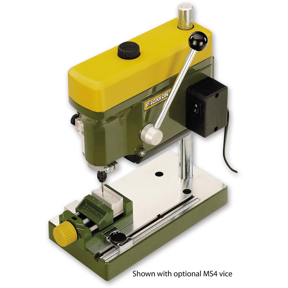

&#149 Machined worktop of high quality, ribbed die cast aluminium &#149 Adjustable fence with scale &#149 Depth gauge with scale &#149 Extremely high rotational accuracy
The machined worktop is of high quality, ribbed die-cast aluminium (220 x 120mm), featuring an adjustable fence with scale and a solid, hard-chromed steel column, 280 high x 20mm diameter. The super stable die-cast head comes with a VDE approved 230V, 85W motor. Power transmission is by aluminium pulleys and flat belt. There are three spindle speeds of 1,800, 4,700 and 8,500 rpm. Chrome feed lever with adjustable depth scale. The spindle is supported by three high quality sealed bearings. The recessed spindle is for insertion of MICROMOT steel collets, but also threaded for drill chucks 3/8" thread giving extremely high rotational accuracy with 30mm feed. The quill diameter is 32mm, with return spring. Throat depth, column to drill spindle, 140mm. Quick coarse height adjustment of headstock is with clamp levers. Maximum height 140mm. Supplied with six triple slit precision collets (1.0, 1.5, 2.0, 2.4, 3.0, 3.2mm).
Collets Supplied 1.0, 1.5, 2.0, 2.4, 3.0 and 3.2 mm
Overall L x W x H 320 mm x 240 mm x 130 mm
Rating Home/Light Trade
Chuck Capacity 1 mm to 3.2 mm
Chuck Type collet
Throat Depth 140 mm
Motor Power 85 W
