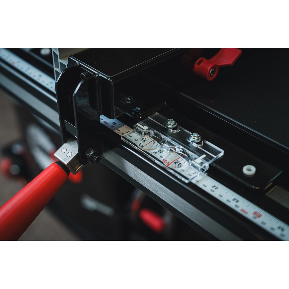

  • Hi-lo fence for thin cuts

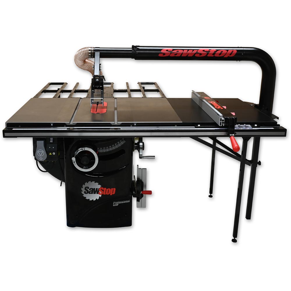

The SawStop Professional Cabinet Saw combines uncompromising safety with exceptional accuracy, making it an excellent choice for serious enthusiasts and professional makers alike. Equipped with SawStop’s innovative AIM safety technology, it allows you to focus fully on your work while maintaining the highest level of protection. Designed to adapt as your skills and workshop grow, this is a saw built to deliver consistently precise results for years to come.

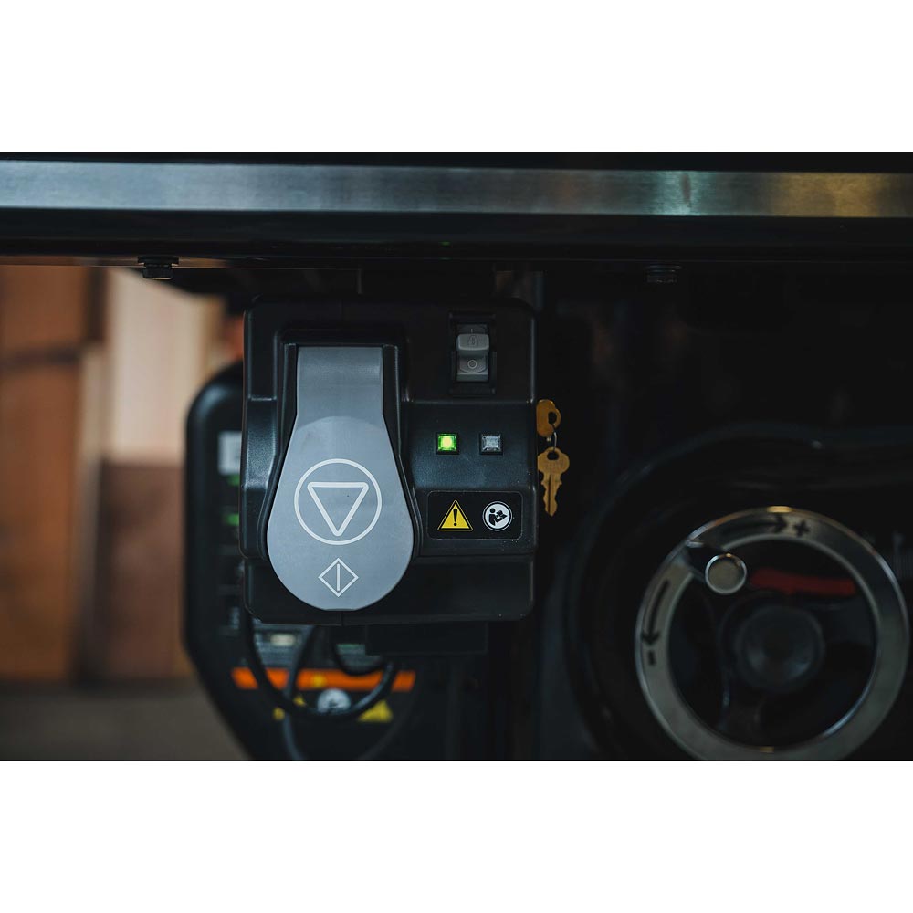

At the core of the machine is SawStop’s patented safety system. In the event of accidental contact with skin, the blade stops and retracts below the table in under five milliseconds, reducing the risk of serious injury to a minor cut. The control box houses the on/off switch, large safety paddle, onboard computer and an additional residual current breaker, continuously monitoring the system to ensure reliable operation.

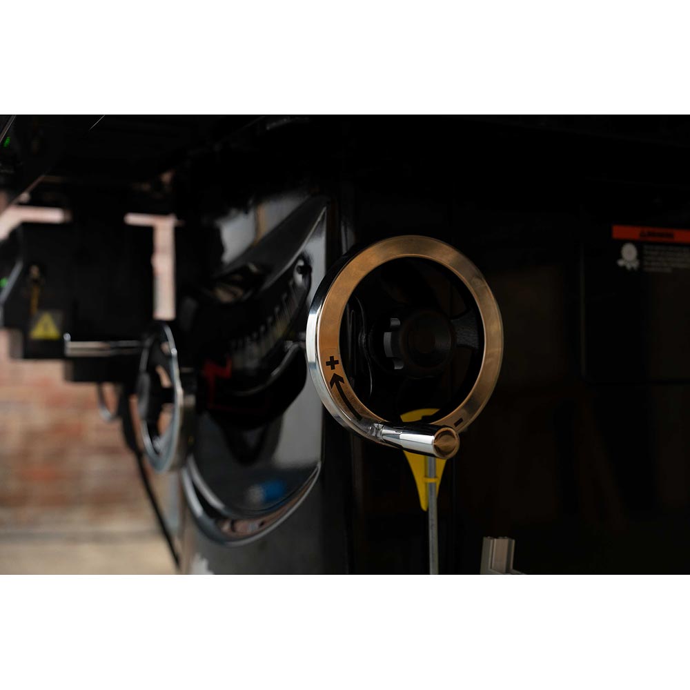

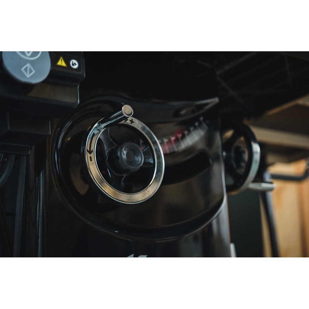

At its heart is a powerful 3HP motor, delivering smooth, controlled power and ample torque, to rip cleanly through hardwoods, softwoods and sheet materials with ease. The heavy-duty trunnion and precision-ground arbor provide exceptional strength and stability, while the gas-assisted piston elevation ensures smooth, effortless height adjustment. Table flatness is measured diagonally to a maximum gap of just 0.010, contributing to vibration-free running and dependable, repeatable cuts. Micro-adjustable controls further enhance precision, making this saw a trusted tool for demanding work.
Supplied with either a 914mm (36) or 1,320mm (52) T-Glide advance fence system, the aluminium fence offers silky-smooth movement, accurate measurement and excellent rigidity. The quick-adjust Hi-Lo fence design adds an extra margin of safety when working with thin or narrow stock.
Dust collection is equally impressive. Above the table, the included floating overarm dust collection system and micro-guard capture up to 99% of airborne dust at source, while below the table, advanced blade shrouding directs waste efficiently into the 100 mm (4″) extraction port.
The Professional Cabinet Saw is supplied with a compact outfeed table as standard, providing additional support and control when working with larger pieces of timber. For even greater capacity, an optional folding outfeed table is available, offering extended support while folding neatly away to save valuable workshop space.
The Dado+ package includes the accessories required to carry out Dado cuts safely and under regulations. It includes the floating arm dust collect guard, secured dado lock down zero-clearance insert, table saw brake cartridge for 203mm (8) dado sets and 203mm (8) premium dado set 15.9mm, 5/8 arbor.
For increased versatility, the saw can be paired with the SawStop 48 Sliding Table for flawless cross-cuts up to 1.25 metres, or the Revolution Mitre Gauge for fine, detailed joinery work. To maximise workshop flexibility, SawStop’s mobile base options are available, with the hydraulic Industrial Mobile Base recommended for effortless repositioning of even fully configured saws while maintaining excellent stability in use.
Included components: 2 x Cast Iron Extension Wings, 1 x Floating Overarm Dust Collection Assembly, 1 x Dust Collection Blade Guard, 1 x Outfeed Table, 1 x Mitre Gauge, 1 x Riving Knives (for 254mm and 250mm blades), 1 x Blade Wrenches, 1 x Push Stick, 1 x Push Block, 1 x 10” / 254mm 40T Combination Blade, 2 x Arbor Washers (for 30mm and 5/8 bore blades, 1 x Zero Clearance Lockdown Insert, 1 x Standard Brake Cartridge, 1 x Owner’s Manual, 2 x Hardware Packs, 1 x 3mm Hex Key, 1 x 5mm Hex Key, 1 x 8mm Hex Key, plus the Dado+ accessories.

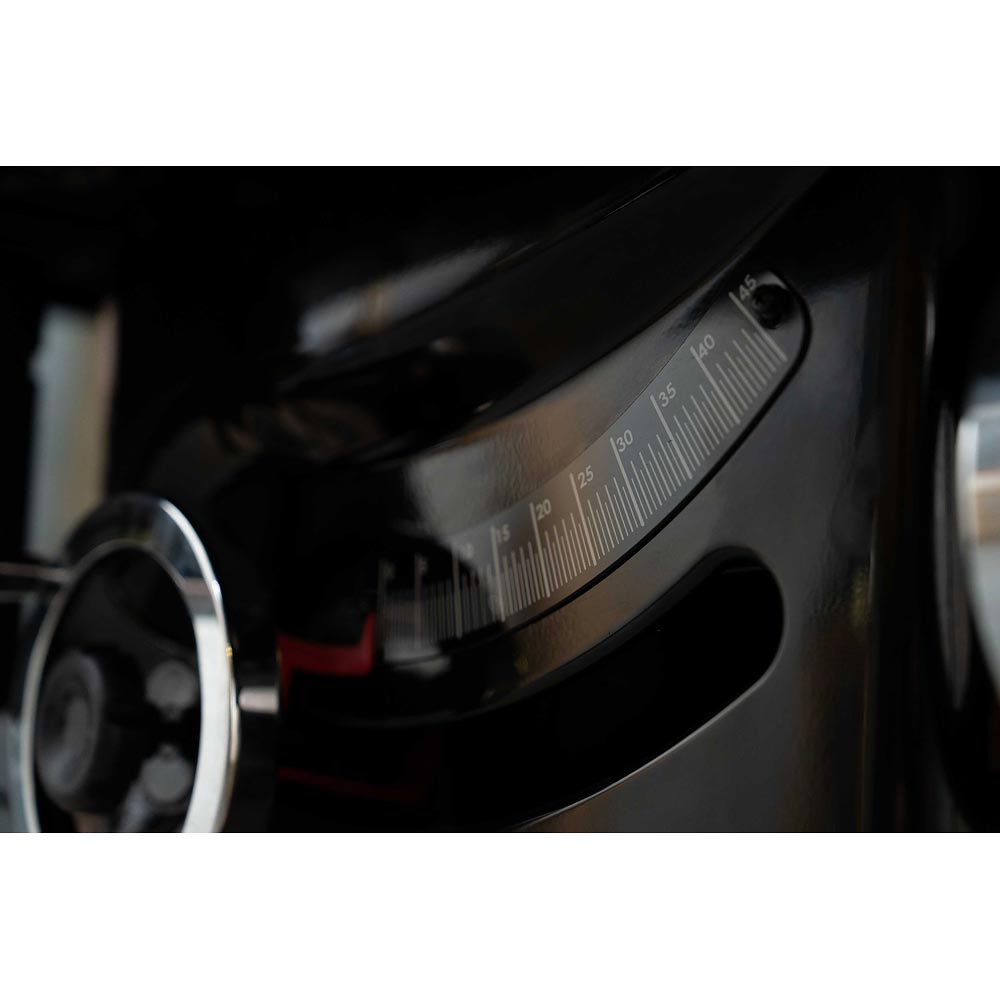

Blade Tilt 0 to 45
