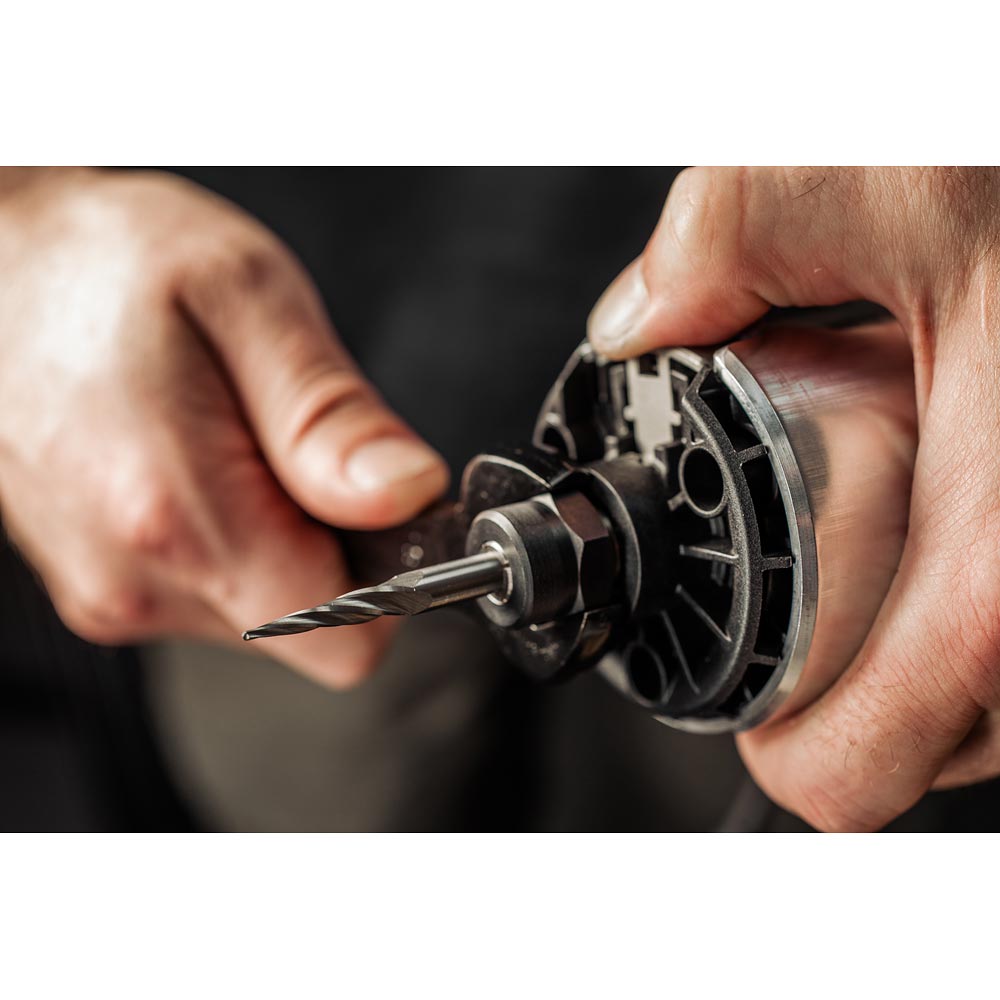

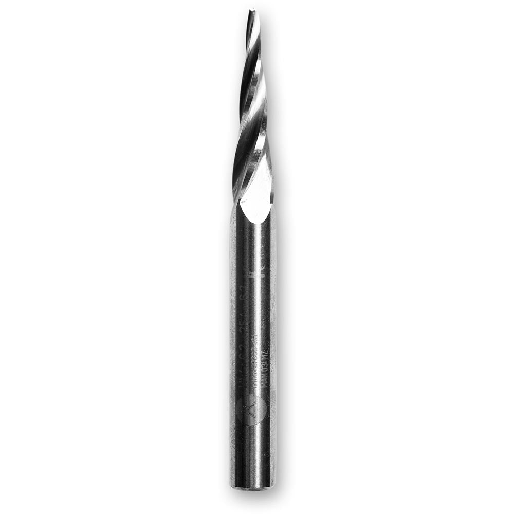

The 11 Tapered Ball Nose Bit is solid carbide making it ideal for a wide variety of specialty applications that require tapered cuts. The small ball nose end 1.6mm at the tip tapers to 6.35mm at its full cutting depth of 25.4mm.

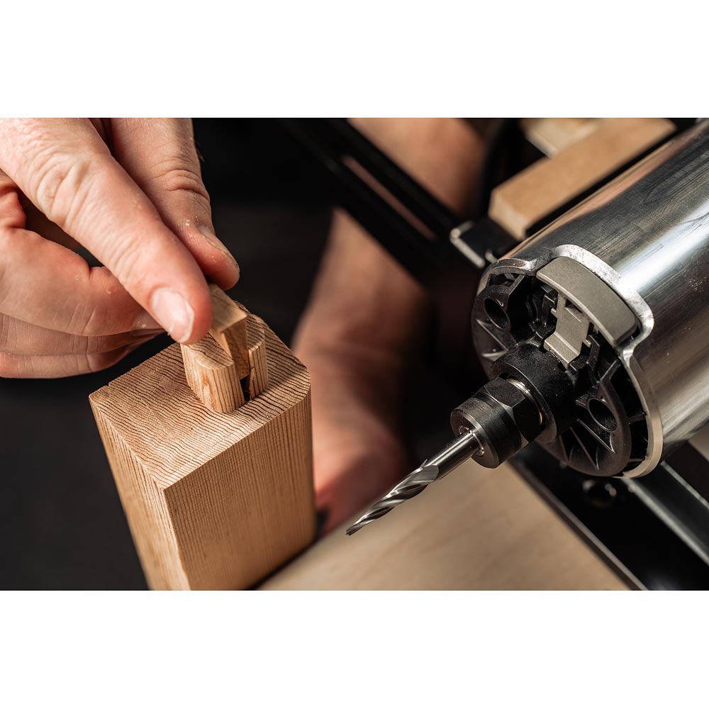

It offers good chip extraction and durability and can handle a wide range of cuts, from deep profile contouring to cutting wedged tenons for custom joinery. The ball nose end leaves a smooth rounded channel finish and the four-flute geometry and solid carbide composition help to ensure cutter longevity.
Overall Length: 63,5 mm (2.1/2)
Shank Diameter: 6,35 mm (1/4)
Cutter Angle: 11
Cutter Length: 25,4 mm (1)
Geometry: Conical, Spiral, Ball Nose
Material: Solid Carbide
Cutter Diameter: 1,5875 mm (1/16)
