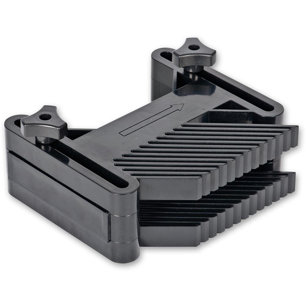

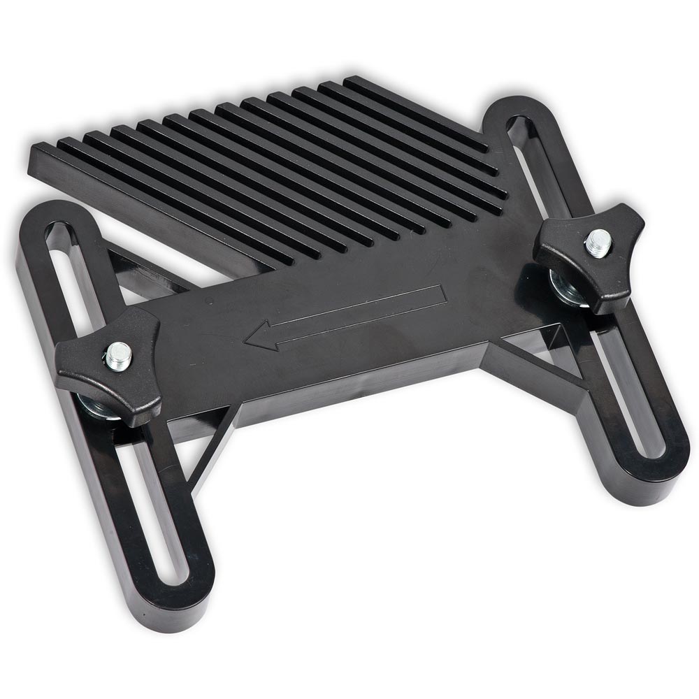

  • UJK Double Horizontal Featherboard
  • Holds workpiece against fence
  • Excellent for safer routing
  • Use as singles or stacked for more support
  • The UJK feather boards set is designed to fit The UJK router tables
  • Will fit other machines and track but may need fettling

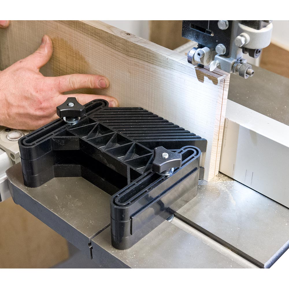

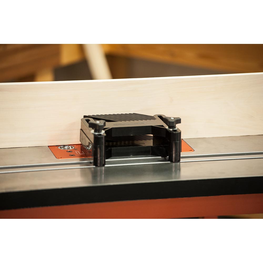

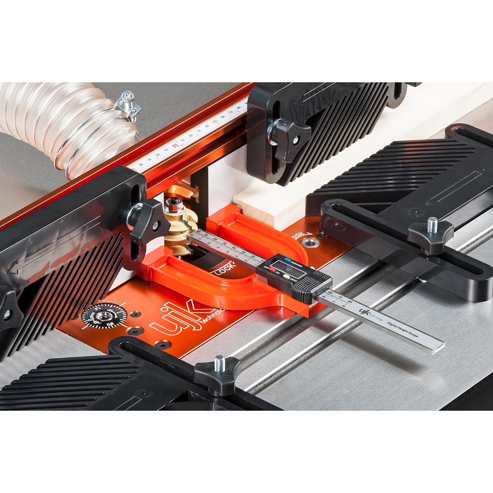

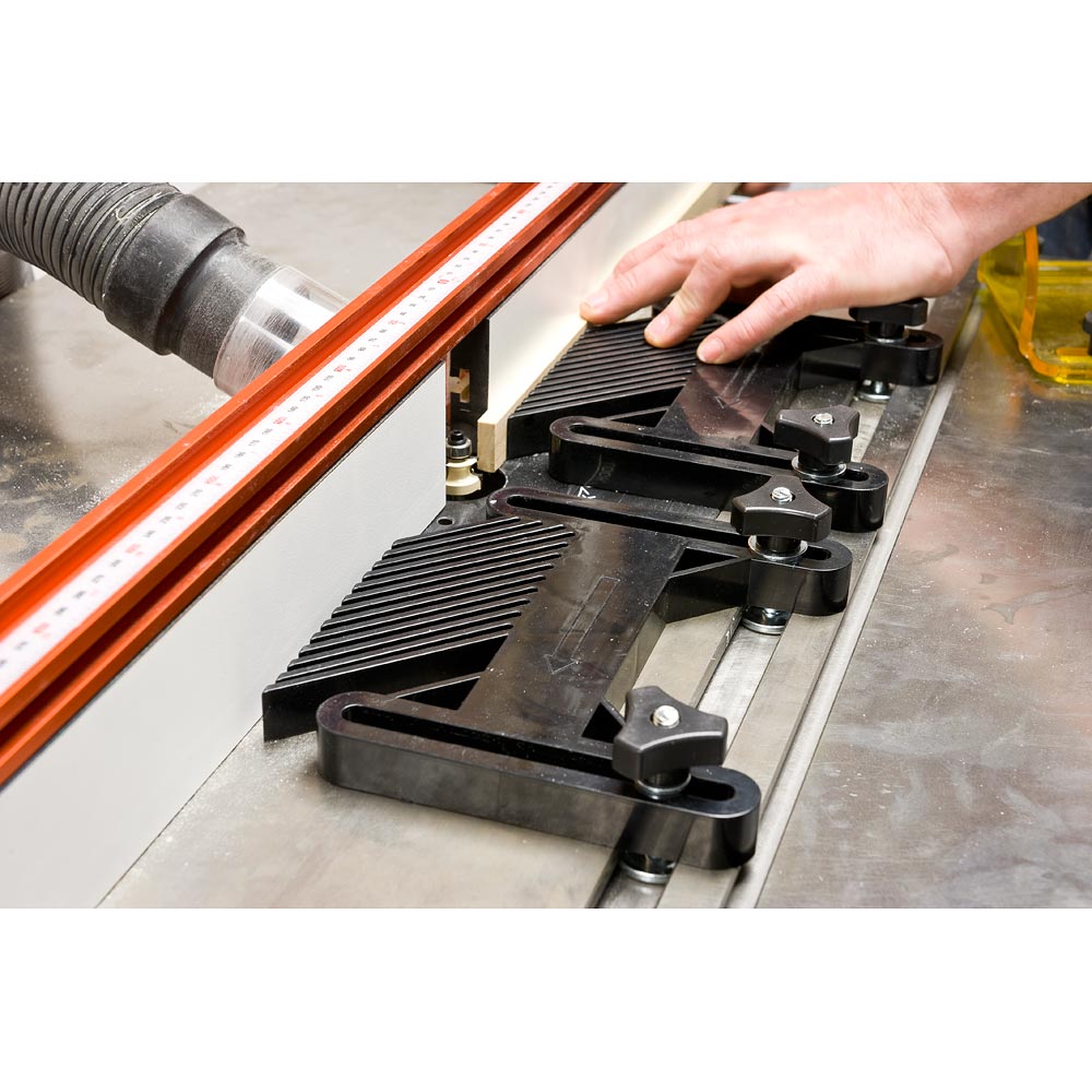

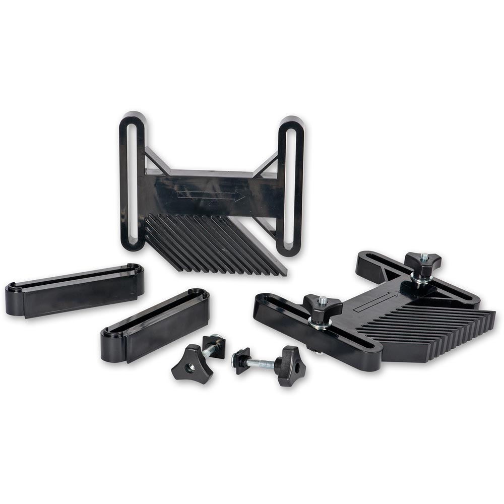

Featherboards are an excellent accessory for safer routing, spindle moulding, bandsaw or circular saw work. The UJK feather boards set is designed to fit The UJK router tables. They can fit other machines and track but may need fettling.The T-bolts come in two lengths, 53mm and 96mm, and for each length a pair are provided for 13.2mm T-track and a pair for standard sized 19mm T-track commonly found machined for mitre fences on the tables of many machines. These featherboards provide vital extra support for the workpiece as it is being passed across the cutter. The amount of applied pressure is sustained over a wide area so you are less likely to experience breakout or chatter on the workpiece. The UJK horizontal featherboards can be used as singles at either side of the cutter or doubled up for extra support when machining a larger section of timber. Each featherboard offers 20mm depth of support and when stacked together, using the supplied spacers, the depth increases to 66mm.
T-bolt head sizes 12.7mm x 22mm(1/2 x 7/8) and 22mm x 30mm(7/8 x 1.3/16).
