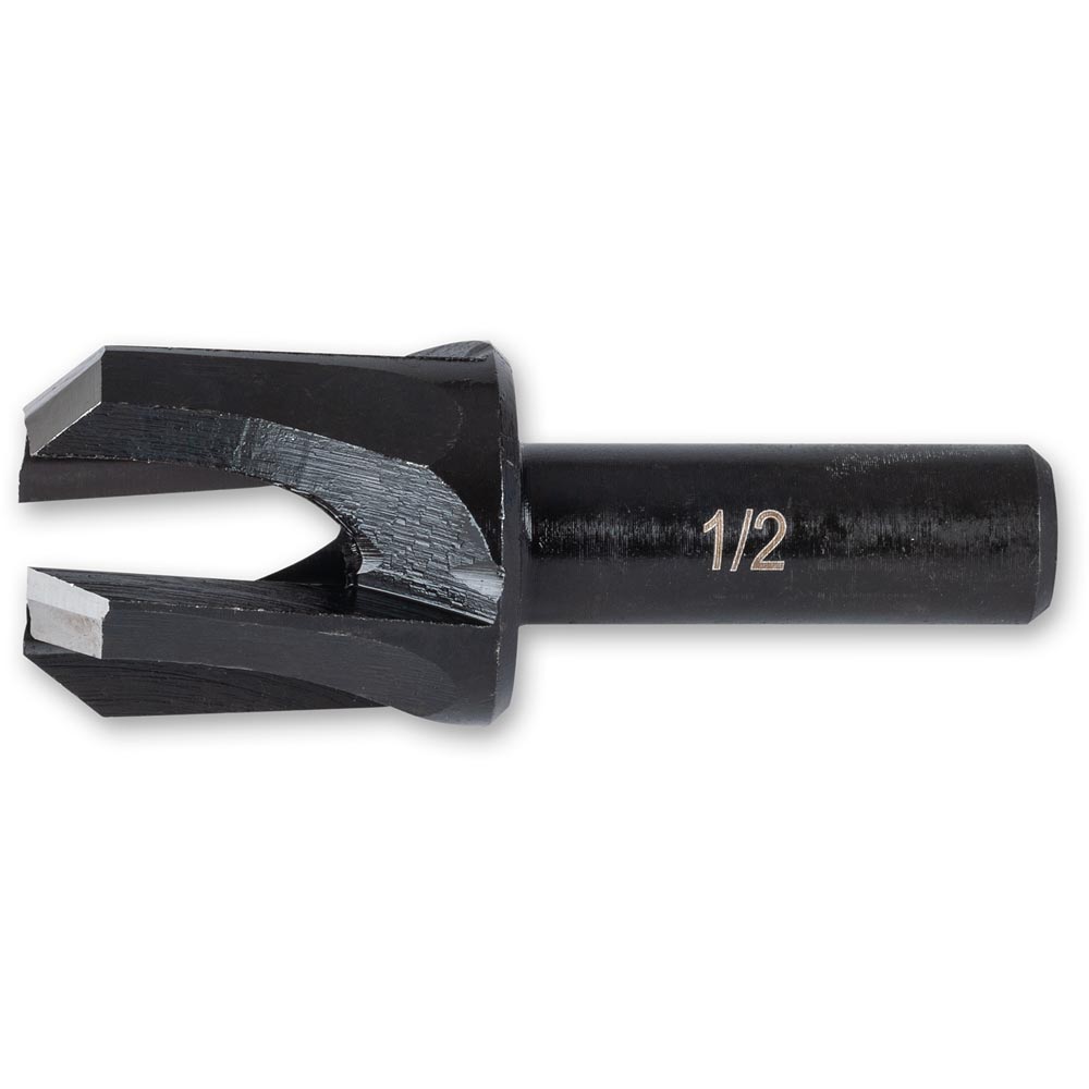

  • Make tapered plugs for a perfect fit every time
  • Use to hide screw heads of to add decoration
  • 4 cutting edges for smooth sided plugs
  • For use in pillar drill or drill stand
  • Cutting depth 18mm, 10mm shank

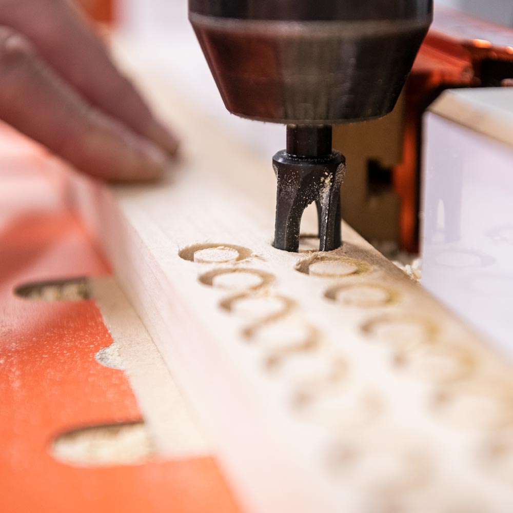

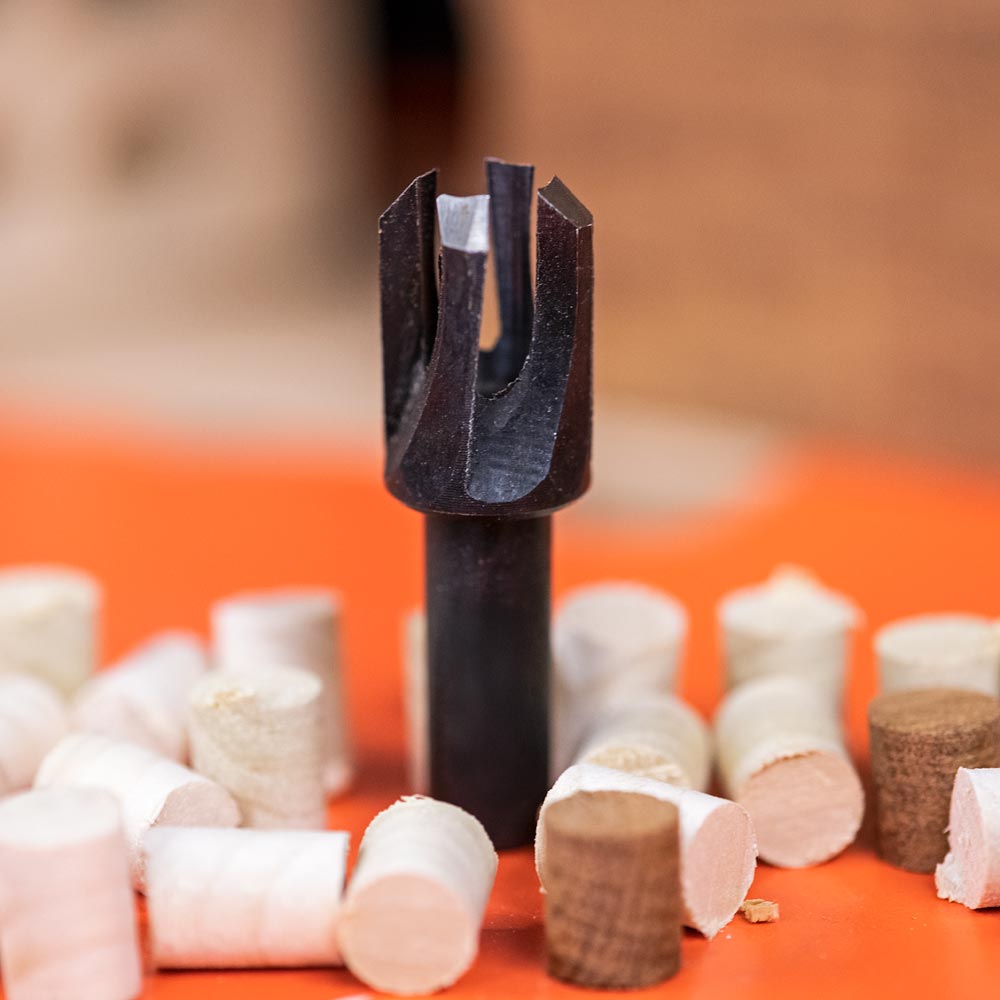

Achieve a perfect fit every time with the UJK Plug Cutter. Even the most carefully drilled holes can be fractionally oversized, the UJK four flute plug cutters ensure a snug fit by cutting plugs that taper in their length. The slight taper ensures a snug fit by eliminating slack, allowing you to tap the plug into place and trim any excess with a flush cut saw.
Matching timber and grain direction creates an almost seamless finish, whereas contrasting timber offers a decorative look. These plug cutters feature four sharp cutting edges that produce clean, smooth-sided plugs. Made from Chrome Vanadium tool steel, they offer a long tool life.

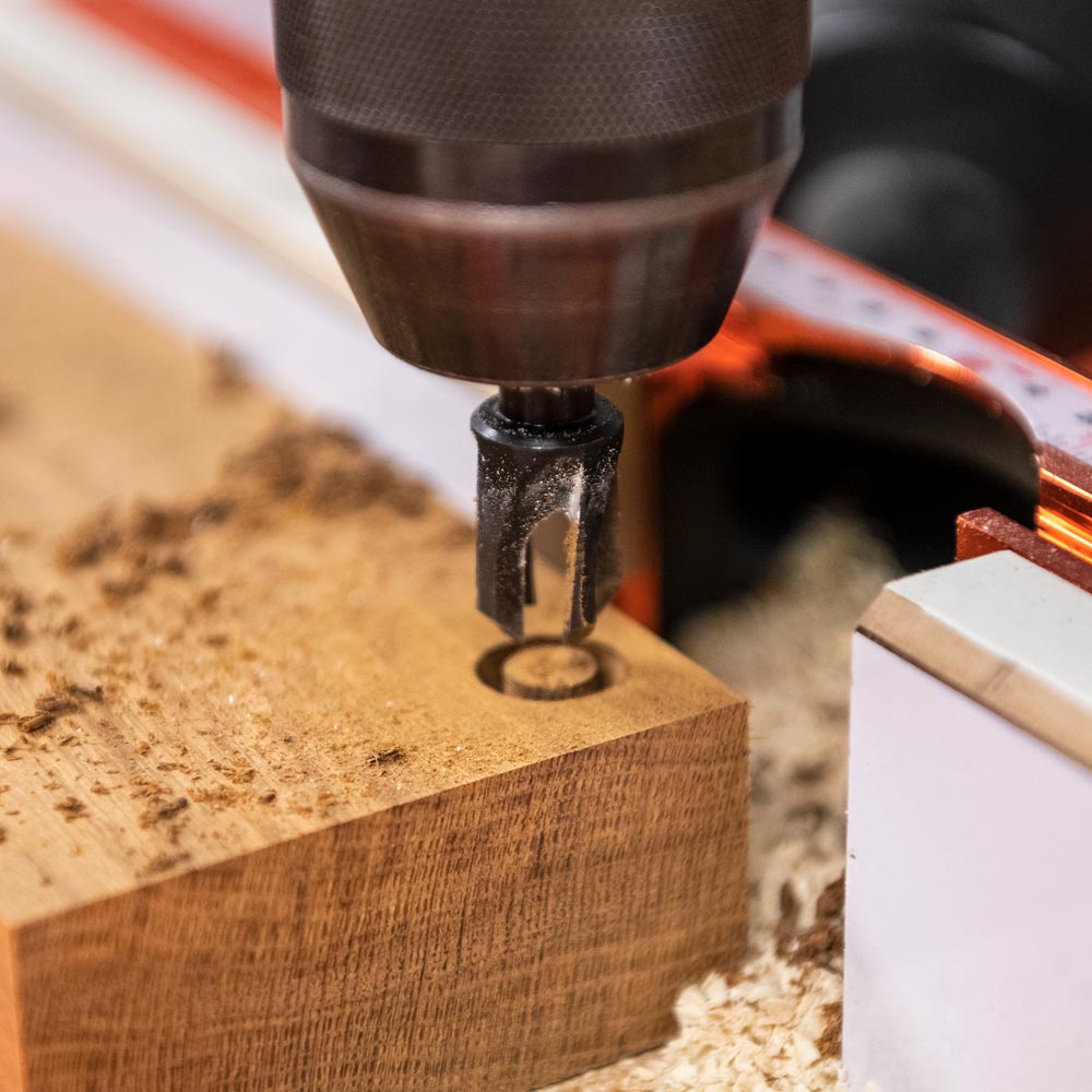

For use a drill press or drill stand. The optimum speed is 1,000 rpm for softwood and 500 rpm for hardwood, with a cutting depth of 18mm.
Plug Diameter 8 mm
Intended Use Used to product wooden plugs that are used to hide screws.
