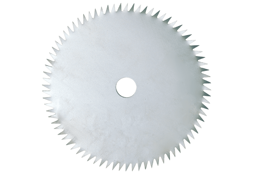

Super-Cut Crosscut Blade
85mm diameter x 0.5 x 10mm bore, 80 teeth. For use on hard wood, soft wood and plastics. View blade

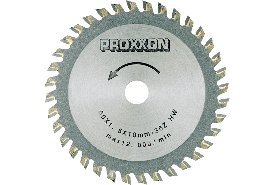

Tungsten Carbide Tipped Blade
(TCT) 80mm diameter x 1.5 x 10mm bore, 36 teeth. For use on hard wood, soft wood, plastics and aluminium. View blade

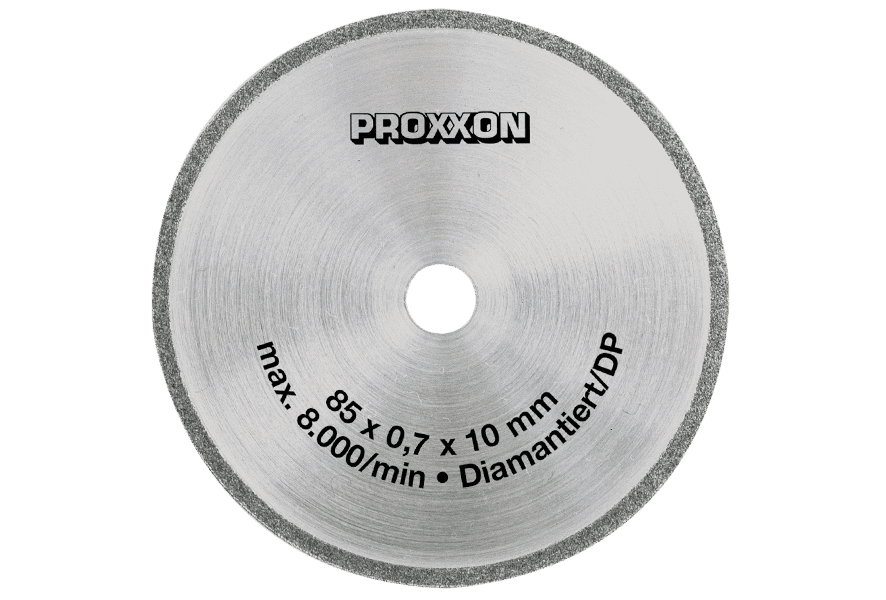

Diamond Coated Blade
85mm diameter x 0.7 x 10mm bore. For use on glass, stone and tiles.  View blade
