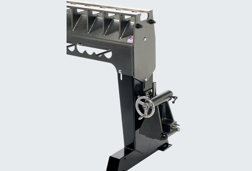

Tilt-Away
Robust’s patented Tilt-Away moves the tailstock out of the way for easy turning.

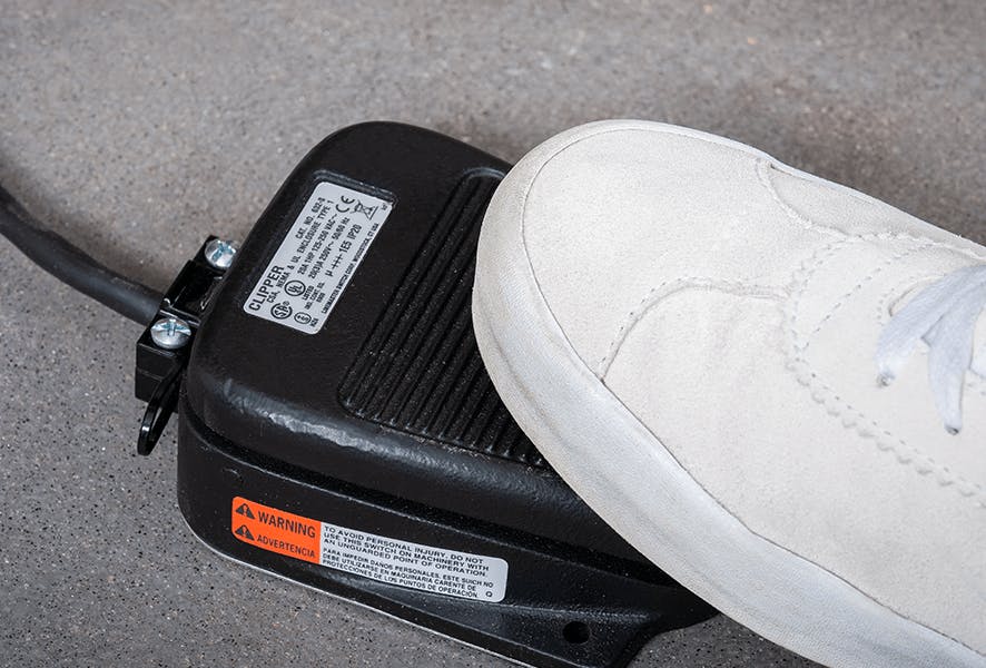

Remote Foot ‘Off’ Switch
A useful safety feature when your hands are full. Simply turn off the lathe using your foot. Note this is an ‘off’ switch only.
