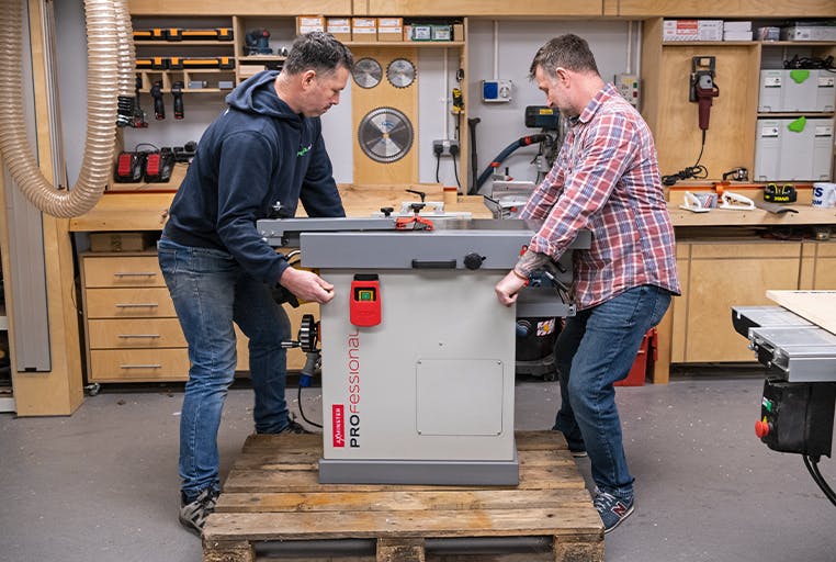

Lifting Handles
With the addition of lifting handles, you’ll be able to move the machine around easier and more safely.
