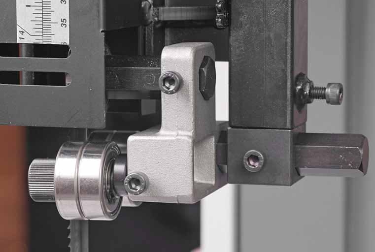

- Heavy duty blade guide bearings

The twin roller bearing guides are easily adjustable, allowing you to adjust them to suit either wide or narrow blades.

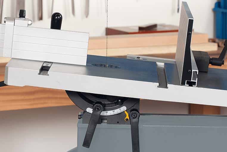

The full size, solid cast iron table has an easy rack and pinion adjustment, allowing for smooth tilt adjustments and maximum support for the workpiece.

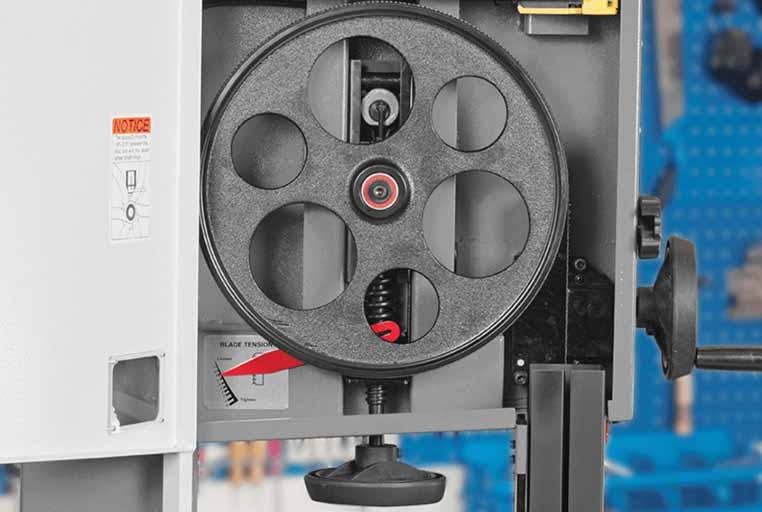

Balance cast iron wheels minimise any vibration when cutting allowing you to achieve a cleaner, smoother cut and finish.

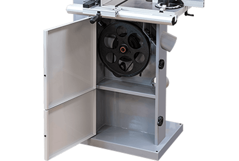

A storage compartment at the bottom of the machine allows you to store away items including your mitre fence and spare blades.

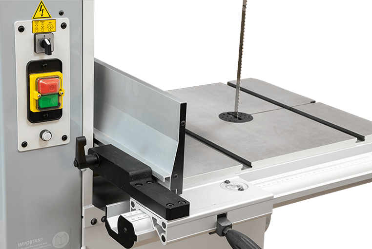

The AP3086B is fitted with a key released emergency stop switch and interlocked doors for safe operation. There is a convenient tool and accessory storage cupboard in the lower half of the chassis. Plus, it comes fitted with a standard 3 pin plug, so you’re all ready to go.
The electro-magnetically braked motor is smooth and powerful. The AP3086B features balanced, cast iron wheels, heavy duty bearing blade guides and a very rigid, full size cast iron table with tilt adjustment from -5° to +45° on a rack and pinion mechanism for ease of adjustment.
Blade changing is done using a quick release blade tensioning lever, which greatly speeds up the process. The rip fence has a cast iron bracket and features a Hi/Lo fence rail for tall or thin work. A cam lock clamps the fence to the guide rail securely and a magnifying lens makes the scale easy to read. The mitre fence is a precision unit, fitted with an indexed position stop pin for easy and precise angle setting. Dust extraction is via 2 x 100mm ports, enabling dust-free use when connected to a suitable extractor.
