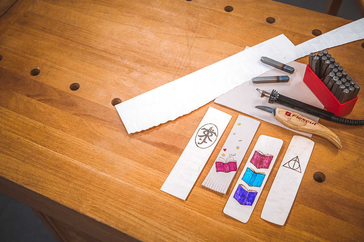

Pyrography is a simple way to elevate any project. In this How To we show you how you can use pyrography to decorate almost anything including these leather bookmarks.
We show you how to cut and shape your leather bookmark and how to decorate them using metal stamps and pyrography techniques. As well as leather bookmarks, we also show you how to make a veneer alternative.

Cut your bookmark to size
For the leather bookmark we are using a vegetable tan leather. This is important if you are burning with pyrography as other tans can give off a toxic smoke. Cut your leather to size using the steel rule and cutting knife.

Create your design
Draw your design out on the leather, lightly with a pencil. This will rub off with a pencil eraser later.

Turn the pyro unit down. It is good to start below half with the power setting as leather burns at a lot lower temperature than wood. Burn your chosen design in with the pyrography unit.

Decorate using the stamps. It may be worth testing on some scrap leather. You want to strike the back of the stamp with a firm whack being careful not to let the hammer bounce. This may cause the image to appear twice.

Finish by picking out details with pyrography and add colour to suit.
