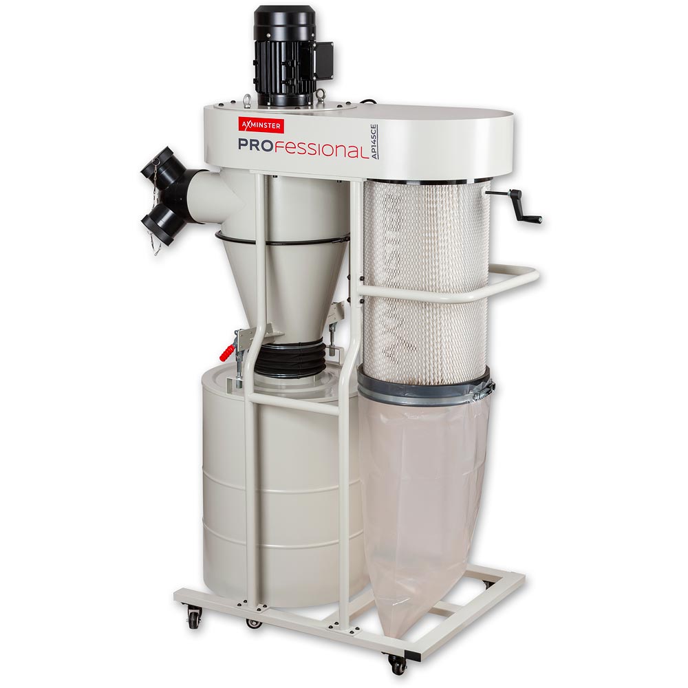

  • 118 litre cyclone extractor for small professional workshops

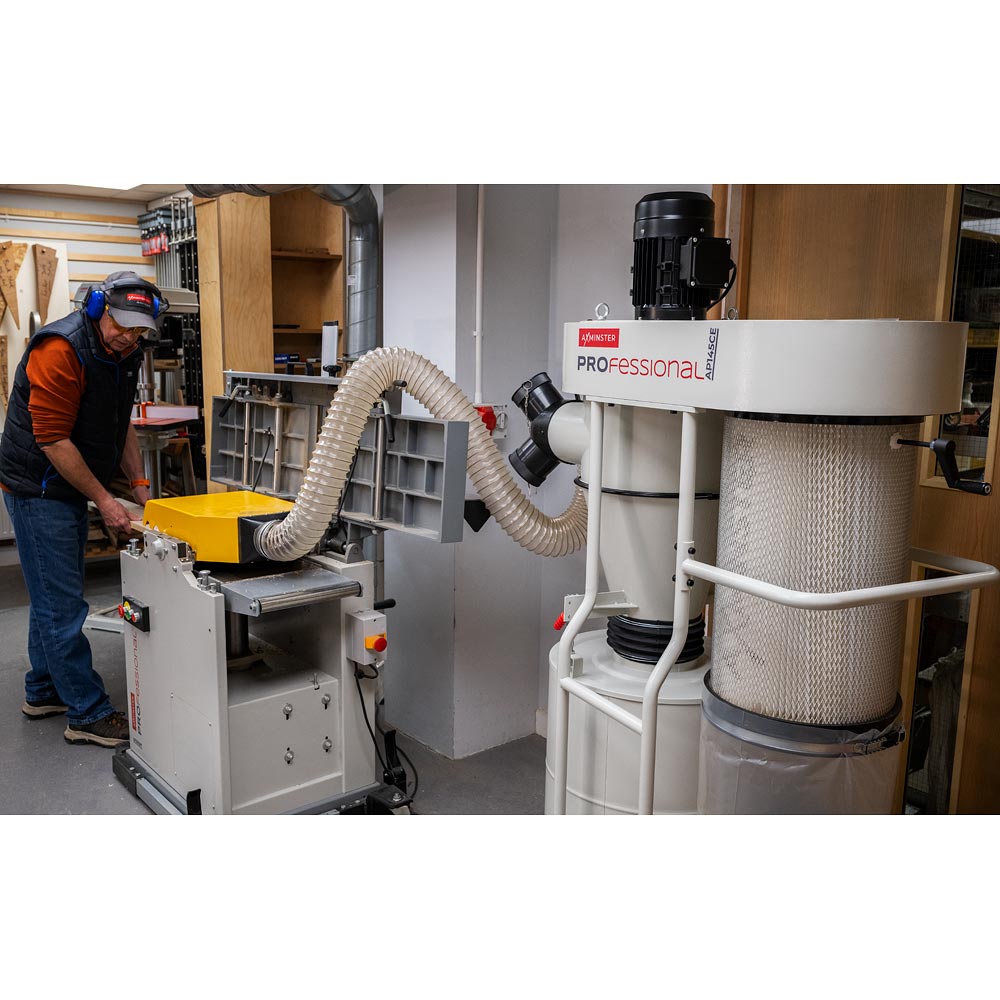

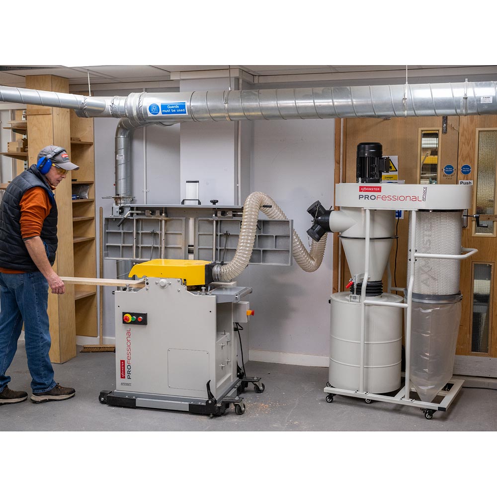

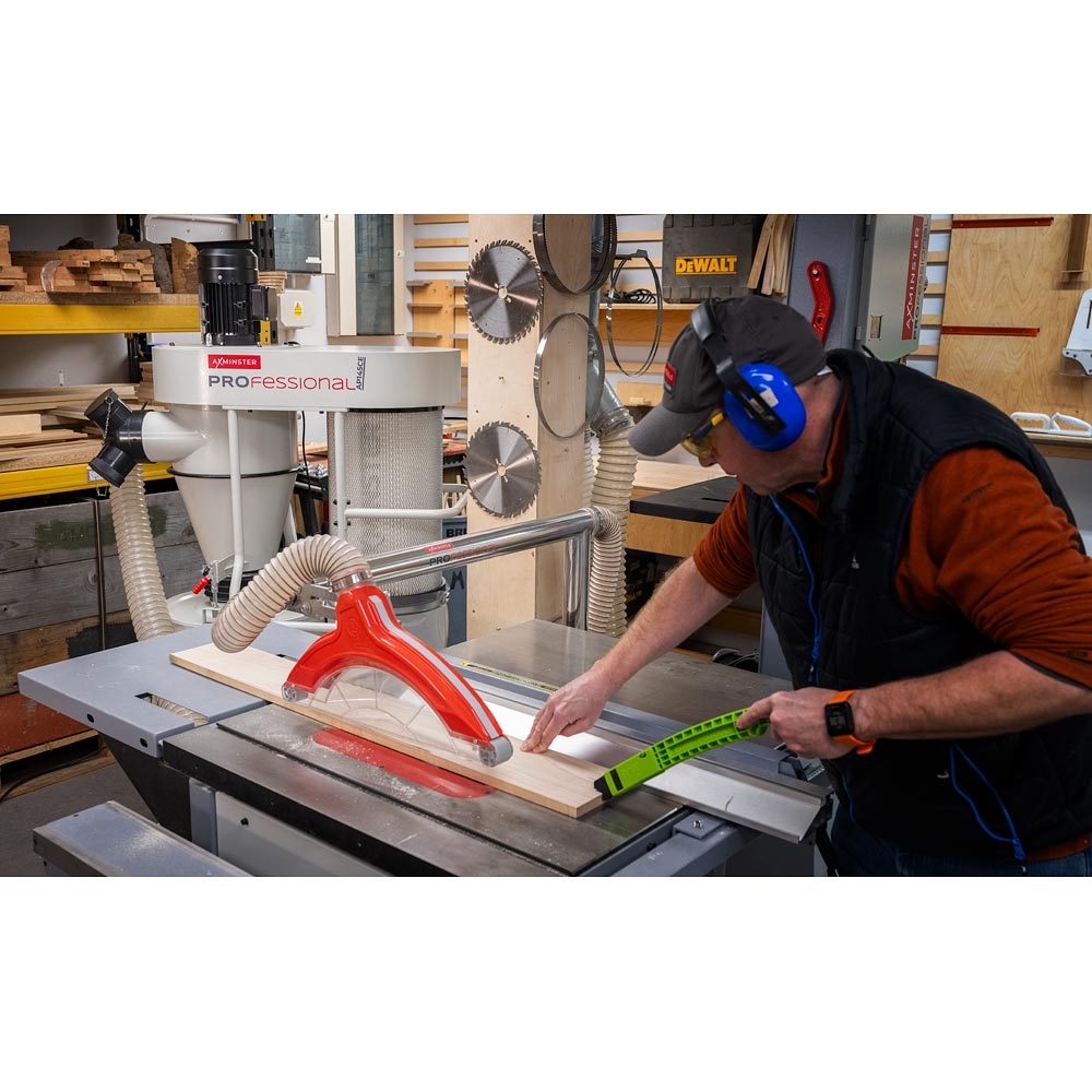

  • Connect up to 3 machines using the 3 x 100mm adaptor
  • Powerful 1.5kW induction motor
  • Mounted on wheels for easy portability

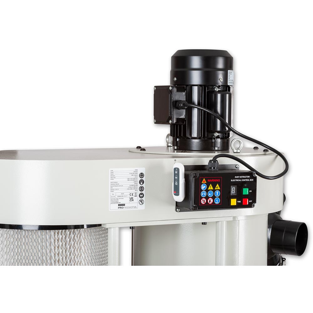

  • Supplied with a remote control
The Axminster Professional AP145CE Cyclone Extractor is perfect for small professional workshops. Before the airflow passes through the extractor's fan, the cyclone separates the larger waste particles from the finer dust, meaning the fan operates more efficiently compared to other types of extractor. Only a small amount of fine dust will reach the cartridge filter, therefore less mess is created, so less cleaning is required.

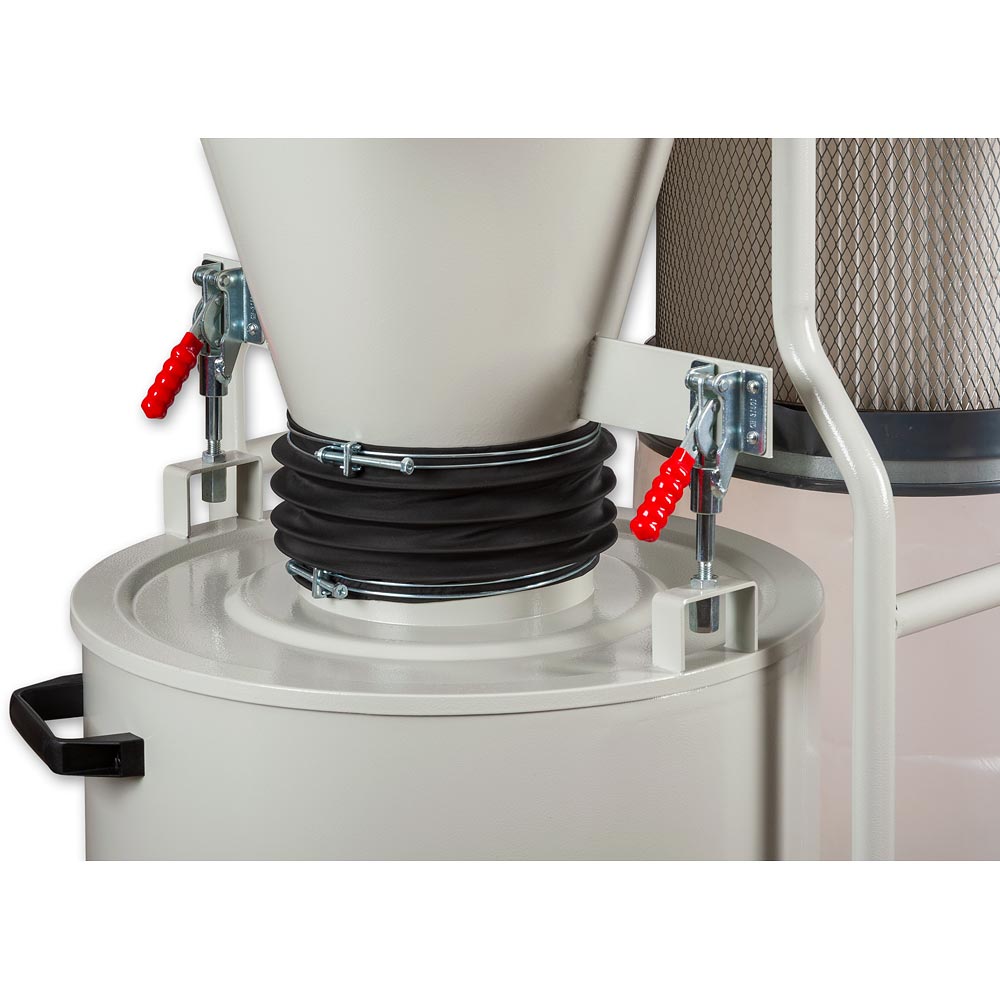

The cyclone, body, filter, and collection bag are all supported by a durable tubular steel frame. Power comes from a 1.5kW induction motor, delivering strong suction and reliable performance. A cartridge filter with a manual cleaning system ensures consistent efficiency, while the 118 litre main waste bin, mounted on wheels, allows for easy removal and mobility around the workshop. Fine dust is collected separately in a bag beneath the filter cartridge, which requires emptying only occasionally. For versatility, the unit offers a choice of either three 100mm inlets or a single 150mm inlet.

The cyclone extractor is supplied with a remote control so you can switch on or off from anywhere in the workshop.
Please note: the hose size should not be reduced to less than 75mm, otherwise a marked drop in performance will occur.
