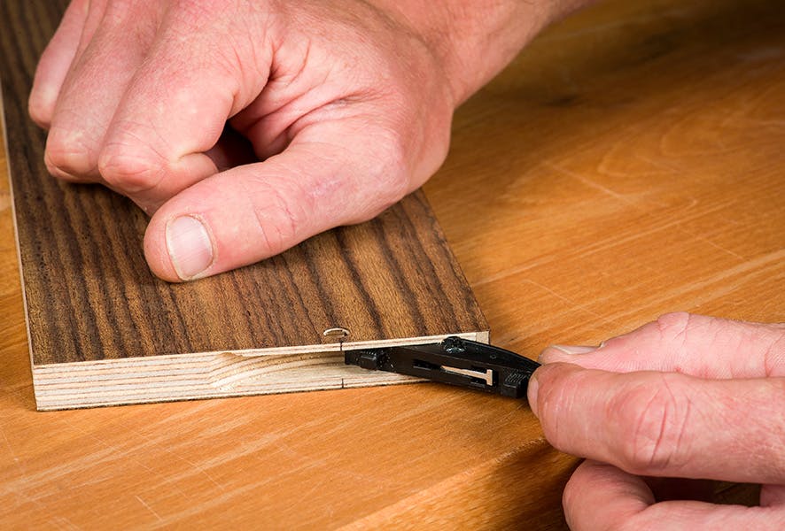

A unique feature to Lamello, the Zeta P2 jointer has a special vertical mechanical drive (VMD). Engaging when the jointer is at full plunge, it moves the cutter up and down in one full turn and only then disengaging to produce the ‘T’ slot, to accept the connectors. This means no glue or screws are required to hold the connector in place.

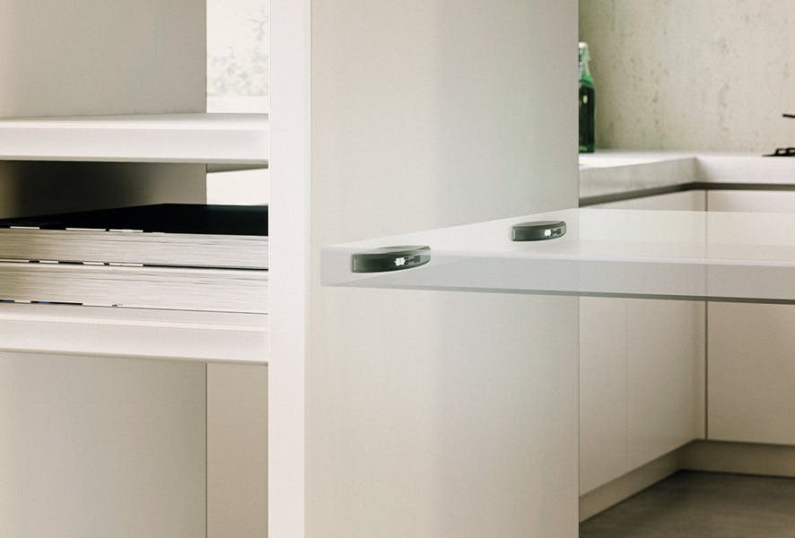

Expand your possibilities with Lamello’s unique connector system. Being self-clamping, it requires no additional clamping to create endless joint types and angles. Achieve the desired joint that your project requires, by easily sliding in the connectors either side of the joint, without the need for glue. Some of the connectors can also be dismantled and reconnected, making for easy transportation and assembly of projects.

With such a comprehensive range of different connector types, Lamello is never short of clamping opportunities. The Clamex and Flexus connectors are self-clamping and disconnectable, with only a 6mm hole visible on the joint. Bisco biscuits are used to align and are held in the groove due to its surface structure. Divario is a self-clamping, sliding connector which is totally invisible. Lastly, Tenso is self-locking, self-clamping and totally invisible, although cannot be dismantled. There truly is a connector for every joint.
