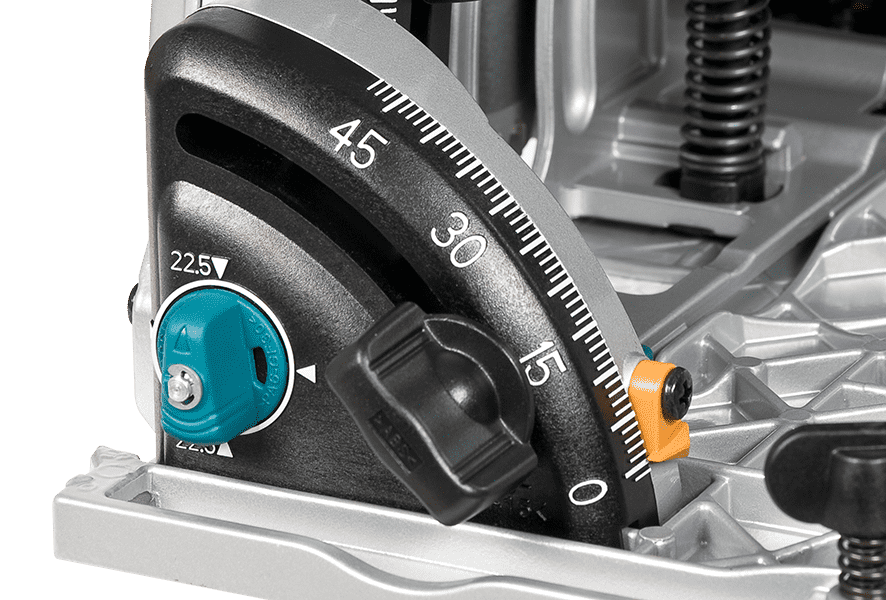

  • Clear scale for precise saw adjustment
  • -1° negative angle available, also pre-set 22.5°

The rail guides the saw perfectly, the rail has an anti splinter strip for a clean cut and the anti slip stips mean you do not even have to clamp the rail on most surfaces but additional rail clamps are available if required. The saw can also plunge for cut-outs if required. Driven by a powerful 1,300W motor (overload protected) with constant electronics to maintain speed under load for a very smooth cut. A variable speed dial allows you to select correct speed for material being cut. With a wide cut range and clear setting it can cut up to 55mm depth and 39mm at 45°, a 2mm scoring cut can quickly be made before the full depth cut, height and angles (-1° - 48°) are simply set with thumb screws, with positive stops for -1°, 22.5° and 45°.
