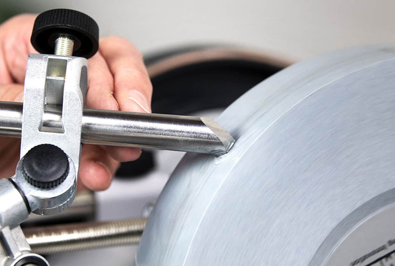

Ideal for sharpening planes, blades and chisels. Even complicated shapes are easily re-sharpened. Suitable for all types of steel, including high speed steel (HSS).

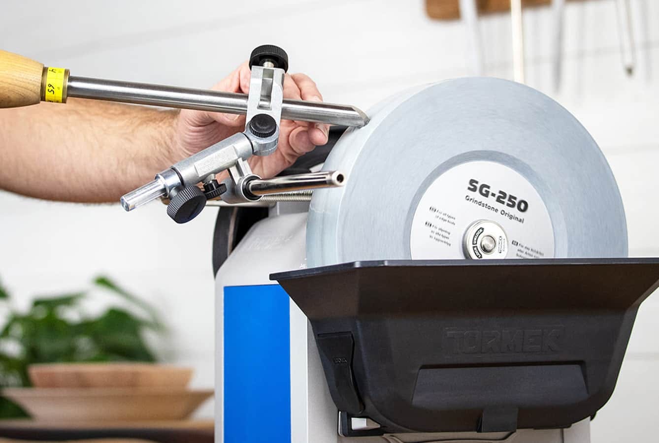

The advanced water trough features a screw lift mechanism. You can fit it, fill it and then, by simply turning the knob, raise the trough to bring the water into contact with the stone. Includes a magnetic scraper for efficient cleaning. For long tools, like chef's knives and planer blades, the enclosed water chute can be fitted to the trough.

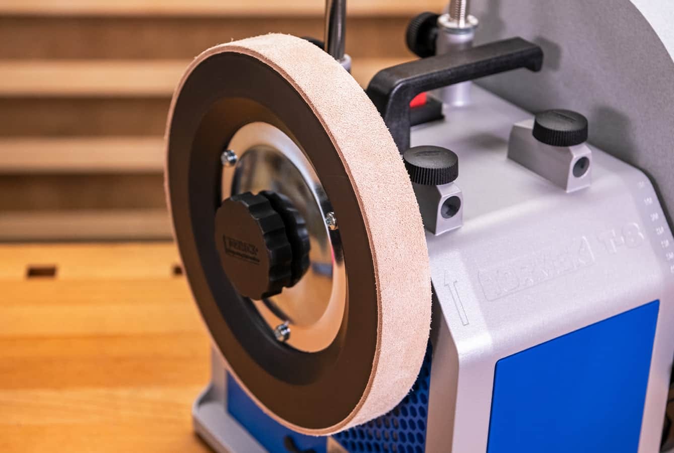

The sharpening process is finished by honing and polishing the edge on the leather wheel. The equivalent of 2,500-3,000g can be achieved. This leaves your tools with a razor-sharp edge so you're ready to produce your best work.
