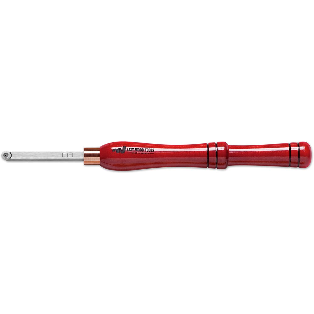

The Easy Wood Tools Mini Easy Finisher™ is a carbide woodturning tool designed for refining curves, smoothing surfaces, and final shaping on small to medium projects, including bowls, spindles, and general workshop turning. Positioned within the Mini range, it provides a balanced step up from Micro tools, offering improved capability while retaining excellent control.
Fitted with a round replaceable carbide cutter, the Mini Easy Finisher™ makes it easy to produce smooth, flowing cuts without the need for complex tool angles or sharpening.
Its compact yet more substantial design provides greater stability than Micro tools, while the flat‑profile bar sits securely on the tool rest, making it intuitive and predictable to control.
The Mini Easy Finisher™ excels at refining shapes and producing clean surfaces, both inside and outside the form. It allows you to smooth cuts left by roughing tools and create gentle curves with confidence.
When used parallel to the floor at centre height, the tool remains stable on the rest, helping reduce catches and delivering consistent, controlled finishing — ideal for progressing from small, detailed work to slightly larger turning projects.

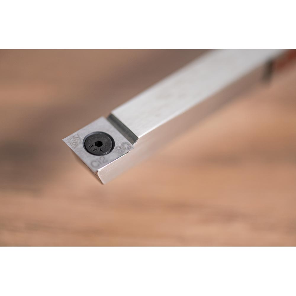

Easy Wood Tools’ long‑lasting carbide cutters hold an edge many times longer than HSS and are suitable for dry or green wood, as well as acrylics. With no sharpening needed, maintenance is simple — when the edge dulls, just loosen the fixing screw and rotate or replace the cutter.
The shaft is engraved with the corresponding carbide cutter reference number for easy identification.
