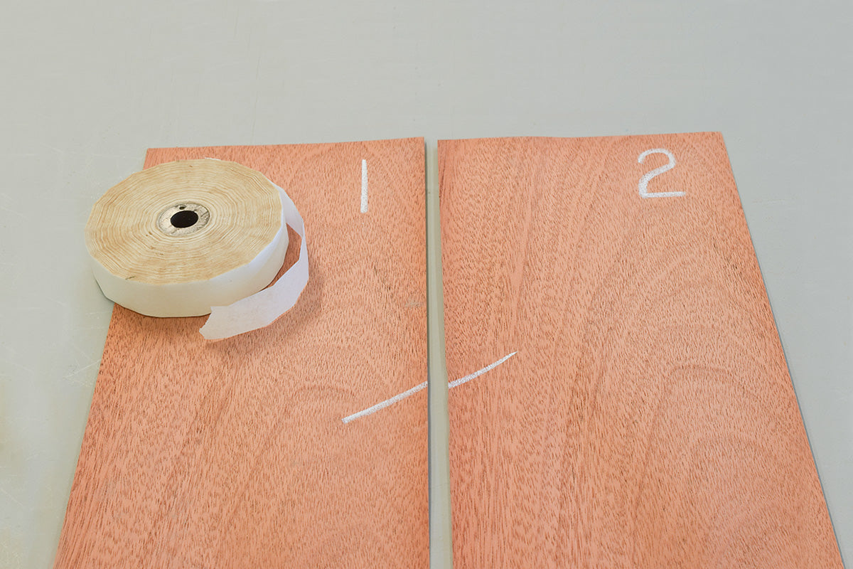

Mark the join
Step 1
On leaves 1 & 2, mark the join.
