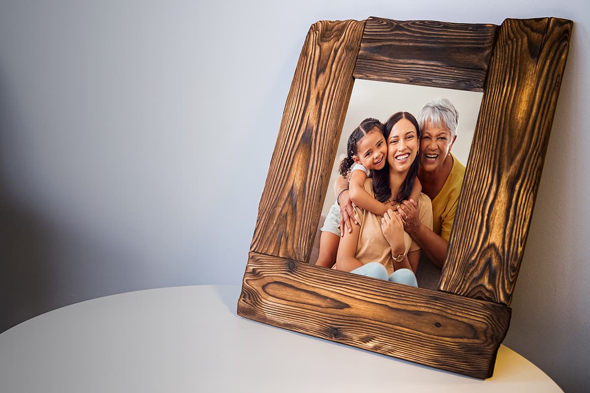

When starting out in woodworking, it is often the simplest of projects that can bring the most satisfaction. In this article we show you simple techniques and how to make a picture frame - a quick project that uses basics tools, but can be proudly displayed in your home, made for friends and families, and once perfected, could be sold at craft fairs.
For this project we used scrap pallet wood which would otherwise have ended up as kindling. You can adapt this project to any timber or any size photo. You can even finish it how you like, to make a truly unique photo frame, personal to you. We decided to create a driftwood effect by chiselling the edges to look worn. We then scorched the surface with a blow torch.
Watch Jason in our Woodworking Wisdom demo or follow our step by step guide above.

Create the textured effect
Carve away the ends to create the eroded, gnarled driftwood effect. You can make this quicker by using a carving gouge to remove the stock. This does not need to look neat as it is simply removing stock and is meant to look rugged.
How to Make a Picture Frame
Scorch the surface
Use a blow torch to burn away the softer fibres of the pine. This is best done outside and a water spray bottle is good to have on hand to control the burning. It is best to place your pine pieces on a stone surface (such as an old paving slab) when burning.
To create the effect you will need to burn the surface and then use a wire brush to brush away the charring and reveal the timber. You will need to brush way more than you think until the grain comes through and removes the softer fibre. Repeat the burning and brush out again. Burning the end grain sections will result in more contour change.
Glue and assemble the picture frame
With the burning done, the front frame can be glued onto the backing frame, lining up the overhang. Clamp in place and allow to dry. Once the glue is dry, the backing frame can be stained to match the colour of the textured front frame.
A clear Perspex sheet can be cut to fit into the rebate of the frame. To assemble simply insert the Perspex panel, your picture and then the plywood back. To hold this in place, use four penny washers and screws. A forstner bit, the same diameter as the washer, is used to drill the recess. Place the washer in the recess and then screw through the washer to hold fix in place.
