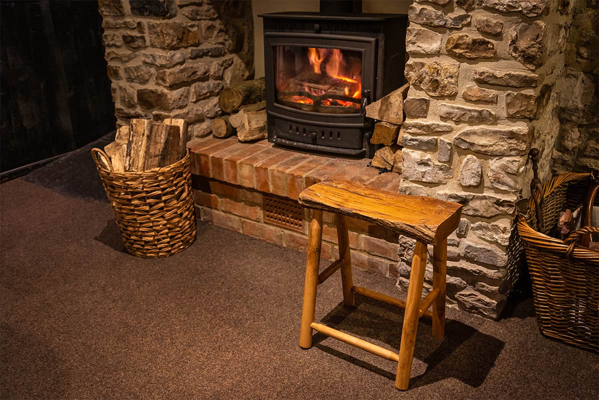

Use and develop a number of woodworking skills with this power carved rustic stool project.
Incorporating woodturning and power carving, you can master a number of key techniques with this simple stool project.
This four legged stool is perfect for the grandchildren. Don’t have a power carver? Then opt for a smooth finish and use it as a side table or footstool.
Simply watch our Woodworking Wisdom video, or follow the steps below, to make your own rustic stool with wood turned legs, stretchers and power carved seat.

You now have your finished rustic stool.
