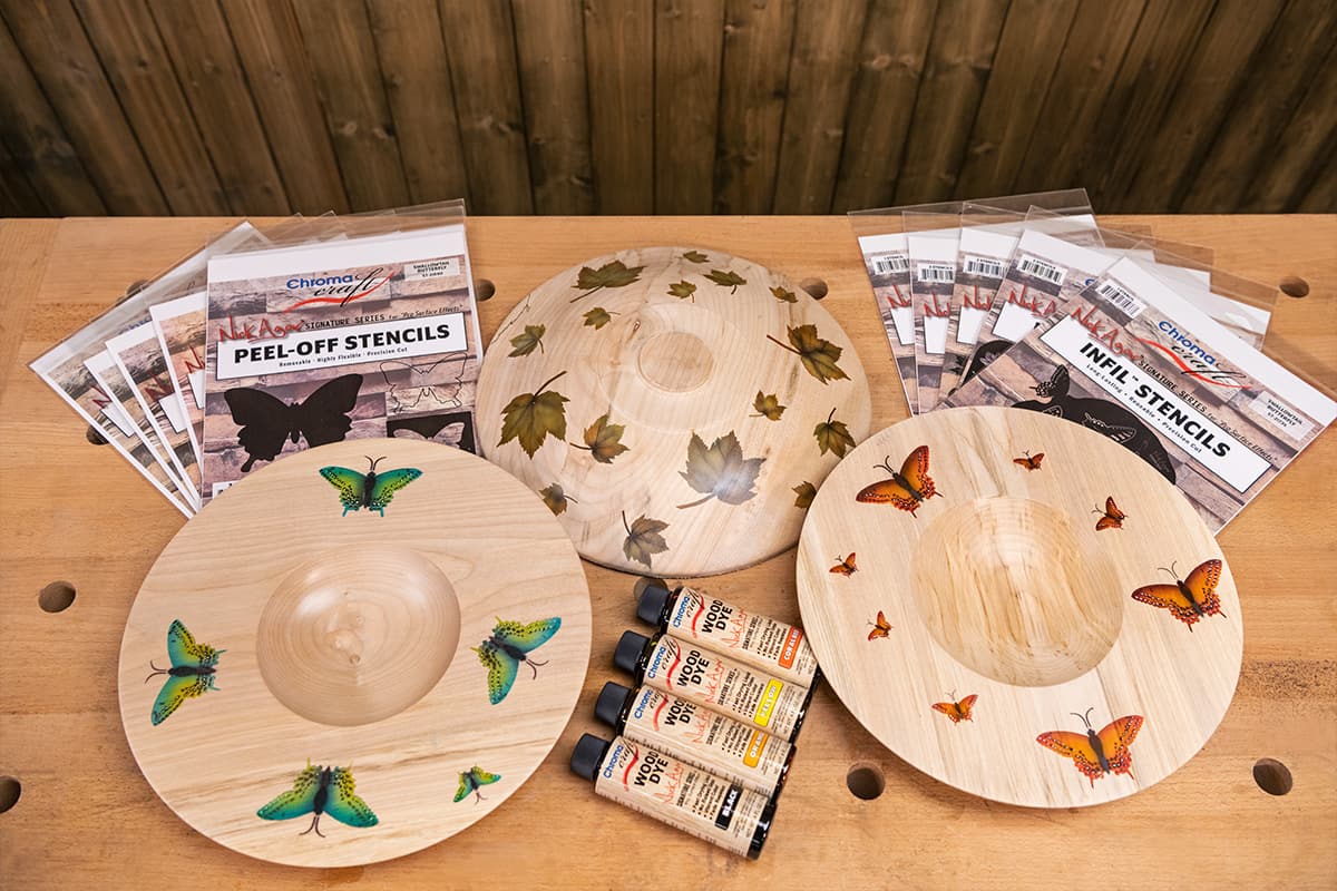

Decorating a project, especially one you have already spent time creating, can be nerve-wracking. By following our step-by-step guide you’ll see how easily you can embellish your designs using Chroma Craft Stencils. Available in a wide range of designs, the stencils are self-adhering, flexible and translucent meaning they can be used on complex shapes and allow absolute accuracy when layering colours. Part of the Nick Agar signature series of finishes, these stencils will add striking detail and texture, transforming your designs into works of art.

There you have your finished uniquely coloured bowl. And the good news is that these stencils can be used with any combination of techniques including airbrush, dauber or roller with dyes, paints and markers. And what’s more, they're reusable so you can create again and again!
