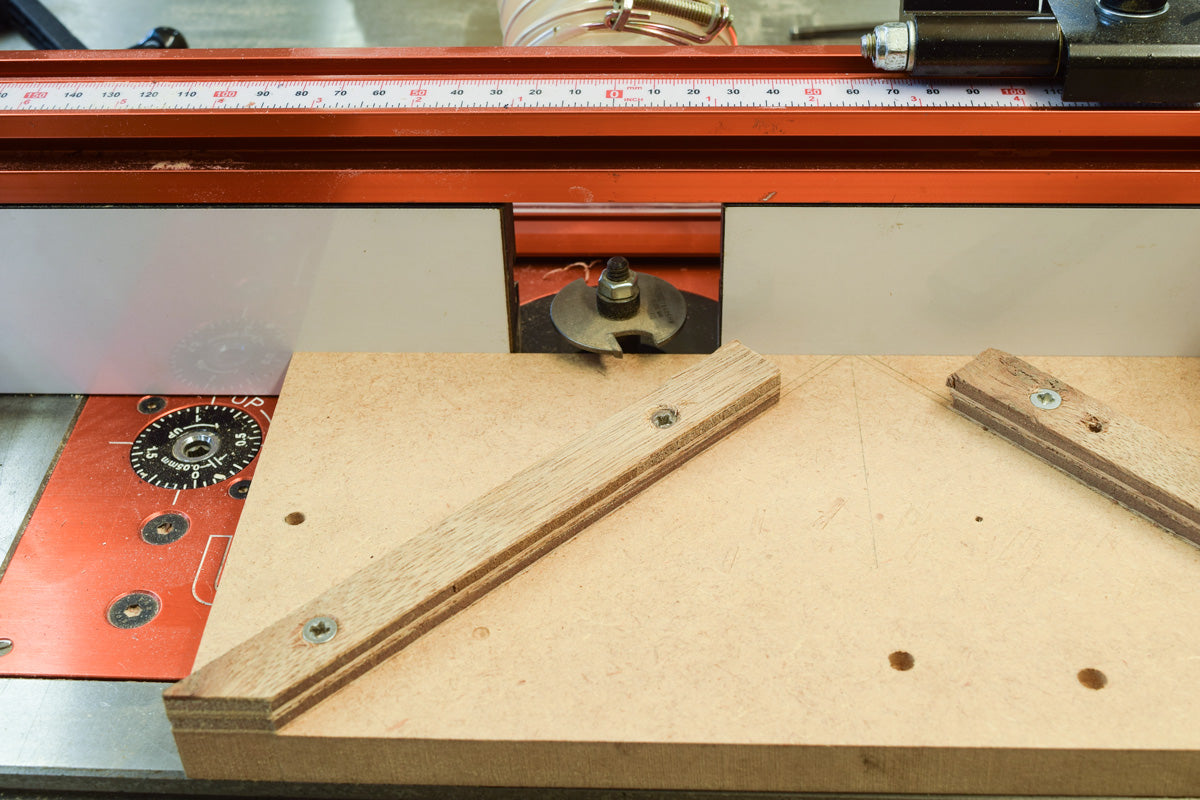

In no particular order of preference, these are the main cutters that I use (some more than others) for most of my activities in the ‘shop: • Rebate Cutters - over the years, I’ve accumulated several of these cutters which see fairly frequent use and changing the bearing allows a different size of rebate to be machined; especially useful for boxes and small cabinet backs. • Dovetail Cutter - a handy cutter to have in your collection as it enables a dovetailed keyway to be cut along with a corresponding tongue. Always remove the centre section with a parallel cutter, otherwise the depth of cut is liable to be too great for one pass. • Keyhole Cutter - one of these is useful to keep for making jigs, fixtures and fittings. The recently introduced Tee Slot Cutter for Track Clamps will enable the Axminster Trade Quick Lever Guide Rail Clamps to be used elsewhere on the bench apart from their normal use in plunge saw track. • Bearing Cutters - these cutters are indispensable for template work in the router table. Although cutters are available as either a ‘top’ or ‘bottom’ variant, it’s the top version which is used in the router table. • Twin Flute with Bottom Cut Insert - I have a fairly decent set of these cutters in many different sizes and they’re the ones that I use most of the time. If machining a groove, the insert allows it to cut the bottom which also enables it to plunge effectively when used in a hand-held router at the bench. • Slot Wing Cutter - this cutter needs to be used with an arbour and is ideal for cutting the reinforcing slots used on the mitred joints on picture frames and boxes. 2 Shown in the picture is the jig I now use with a slot wing cutter and it consists of an oddment of mdf with a couple of battens screwed onto it at 45°. When the work is placed inside the 90° angle, the corner to be machined will be level with the edge of the jig. In use, it’s important to pass the work through once; making a second cut is liable to lead to inaccuracies as the cutter may not necessarily follow the same path through the existing slot.
The 4mm slot wing cutter is an alternative method of producing the slots for biscuits, particularly if the work is quite narrow as in lipping, where it may be quite awkward to use a conventional biscuit jointer.
