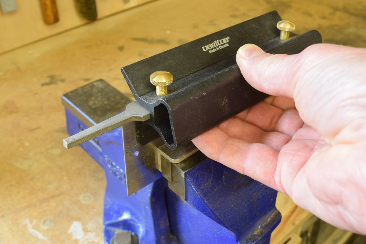

The first step is to file each edge dead square. This is difficult to do freehand but if a 6” smooth cut file is used in the Veritas Jointer & Edger, each edge is guaranteed to be dead square. cabinet_scraper_01
