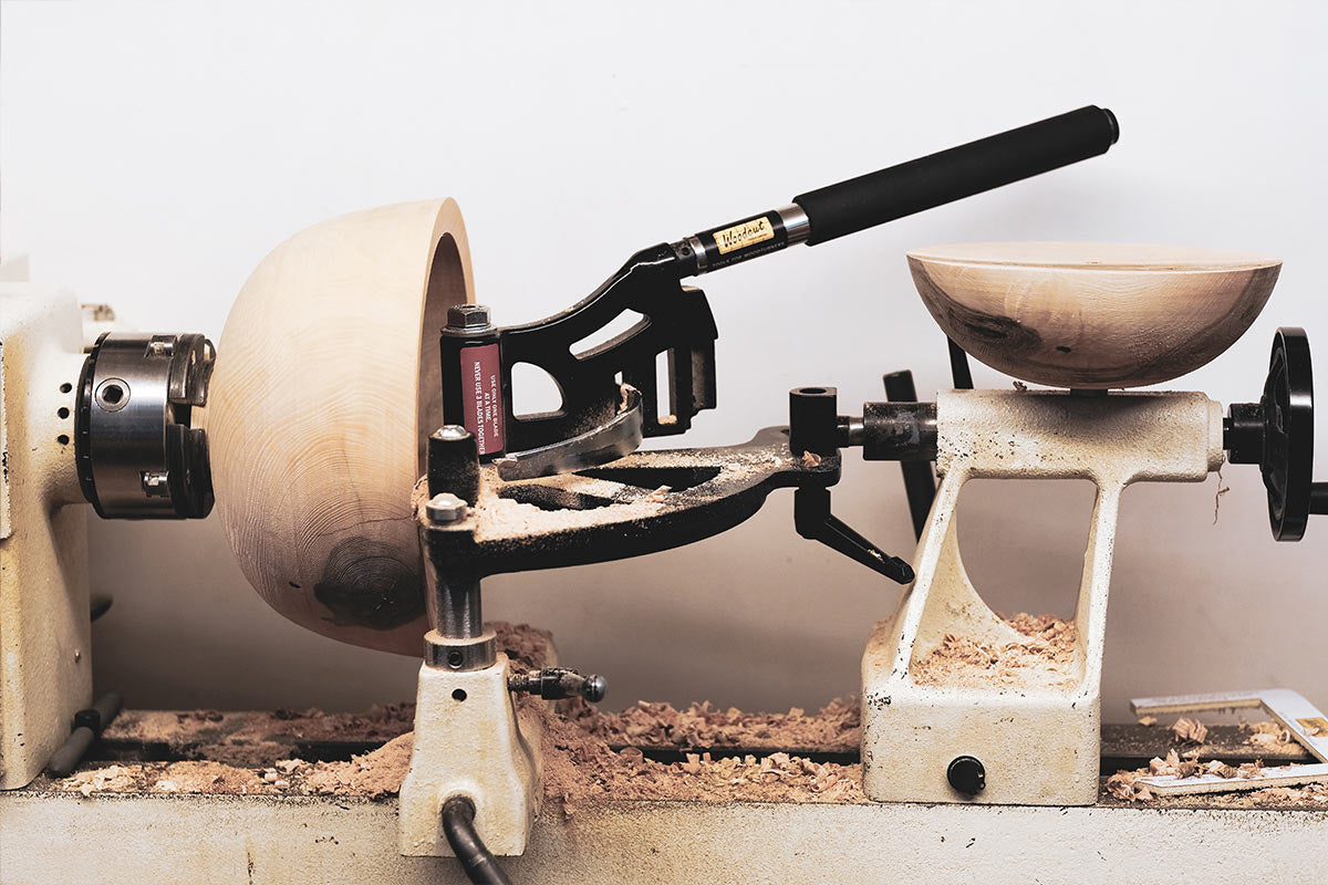

For this review, I have turned a 12 inch green ash bowl, and I will be using the smallest of the three cutters supplied to core its centre.
Mounting the Bowlsaver onto the lathe bed is straightforward. The tool post fits into the banjo on the lathe bed and the tailstock taper into the tailstock. It helps to have the drive centre inserted into the headstock to accurately set the height of the cutter. You are looking for the tip of the cutter to line up exactly with the point of the drive centre. Once they are at the same height, you can lock off the tool post, slide the collar down and lock that off too. Finally, you need to tighten the tailstock and make sure that it is securely locked off.

Now I have the Bowlsaver mounted correctly, I can secure my previously turned 12 inch bowl onto the lathe; using the Axminster Evolution SK114 chuck with Type C Dovetail Jaws. In order to do this, I turned the outside of the bowl with a shallow tenon.
The instructions give detailed directions of where the Bowlsaver should be positioned according to the size of the bowl you are working on. Here I have it just slightly past the centre of the bowl with maybe 1cm of clearance between the Bowlsaver and the face of the bowl, with the cutter set at just under an inch from the edge.

Making the first cut felt a lot more secure than I was expecting, given the size of the unit. I set the lathe speed at around 450 rpm, easing the cutter forward to make contact with the wood. I applied some downward pressure through the handle gripping with both hands and leaning slightly onto it. This gave me greater control over the speed at which the cutter met the surface of the wood. My first impressions were how clean the cut was, and how crisp and ribbon-like the shavings were.
The shape of the cutter means it creates a wide enough channel for the arm to follow without clogging. The Bowlsaver feels solid throughout the cut with very little vibration through the handle. It does become necessary to back the cutter out from time to time to remove any woodchip build up. As you get towards the end of the cut, the noise changes and you will feel a slight change in resistance. I took my time here, making very small cuts and checking how much the core was moving. I did this three or four times before enough material was removed to allow me to easily break the small tenon holding it in place and the core came away easily and cleanly.

Once I had cored the bowl, it was an easy job to remove the Bowlsaver from the lathe. The collar on the tool post conveniently remains locked in place so that when I come to use it again, it will align itself in exactly the same position making for a faster and more efficient user experience.
Woodcut Max3 Bowlsaver
After refitting the tool rest, I could then finish turning the larger bowl to the desired thickness and create a new piece from the removed core. It wasn’t until I stood back and looked at the two bowls I had made that I fully appreciated the potential this piece of equipment has in my workshop.
