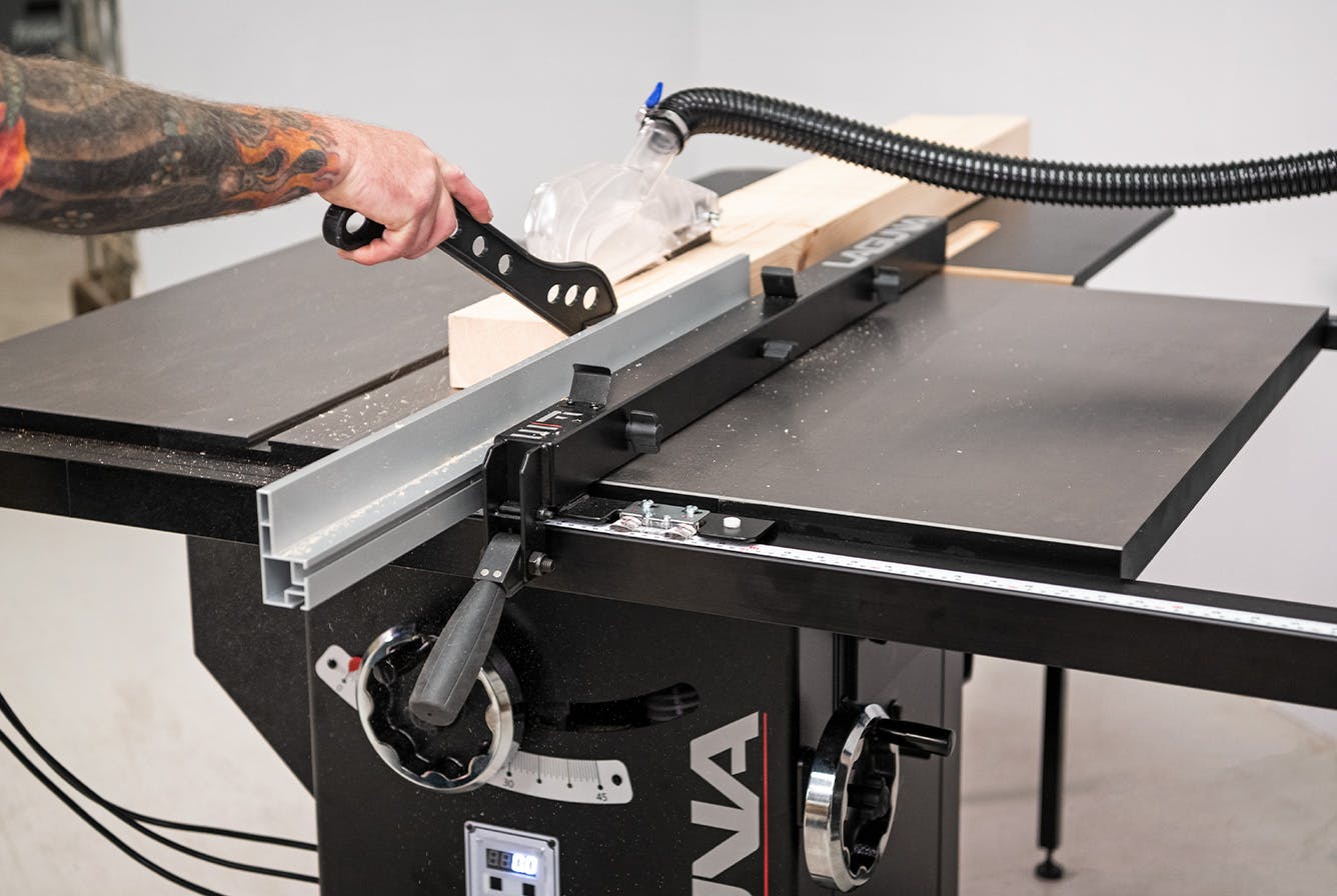

Fully adjustable T style rip fence
Enables quick and accurate settings with a solid quick lock
Hi-Lo sub fence
Two positions, high 80mm and low 10mm

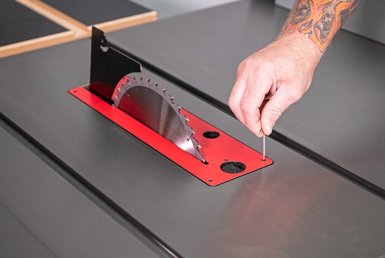

Zero clearance throat plate
With fine adjustment screws for precise alignment with the table surface

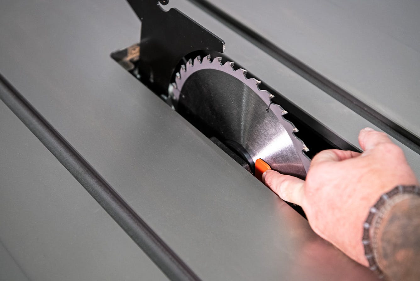

Tool-free spindle lock and a riving knife
For fast blade changes

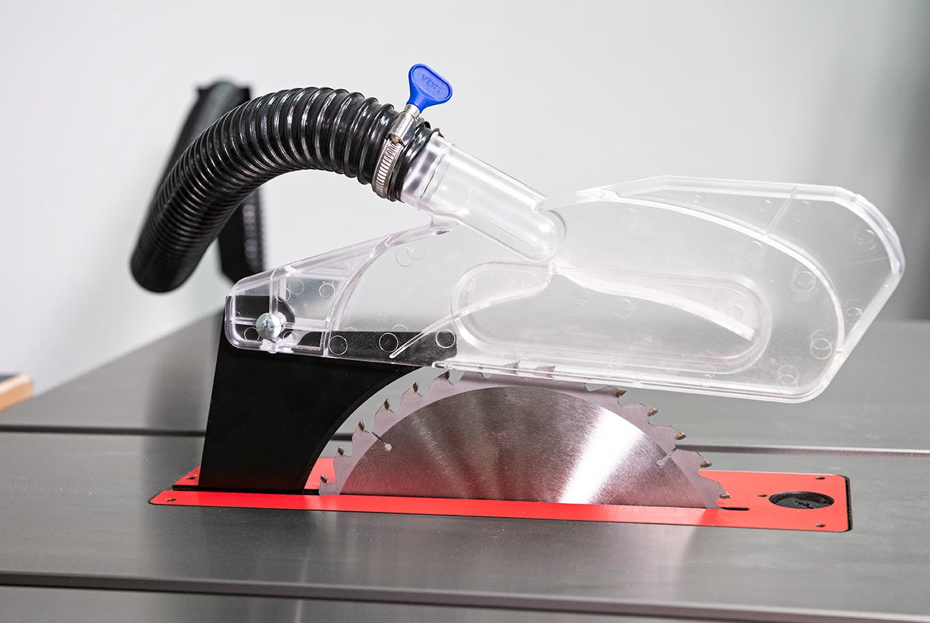

Transparent crown guard
Enhances visibility and waste clearance during operation

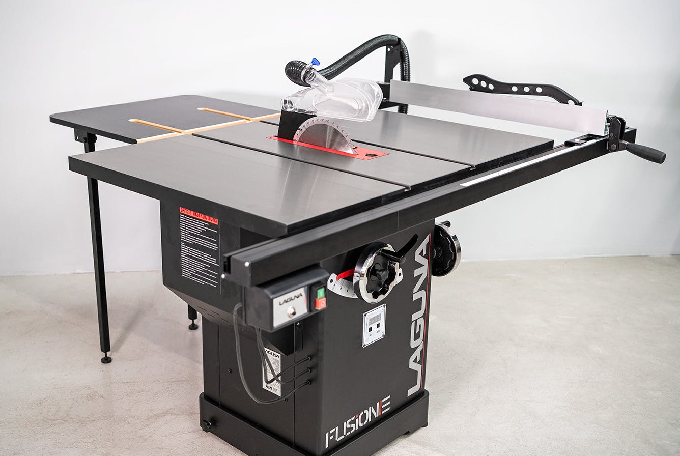

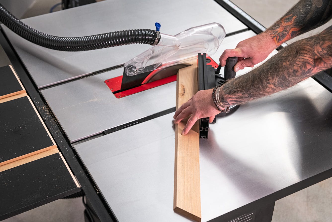

The Laguna F3 Fusion Table Saw is the ultimate tool for woodworkers who demand the highest level of precision and performance. Engineered with meticulous attention to detail, this table saw offers an array of advanced features that guarantee flawless cuts, superior safety, and unparalleled woodworking experience. Whether you're crafting intricate designs or tackling large-scale projects, the F3 Fusion Saw is engineered to deliver the precision, power, and reliability that serious woodworkers demand.
With its smooth ground cast iron table top, you can enjoy a stable, durable and low-friction work surface. The included right hand and left hand tables, allow you to effortlessly expand your workspace providing ample room for larger projects and enhancing efficiency. A rear outfeed table adds further stability when ripping long lengths. Expand your workspace further with the Rip Fence Extension (available to purchase separately). The close clearance phenolic table insert with levelling adjusters ensures a flat and even surface for optimal performance.

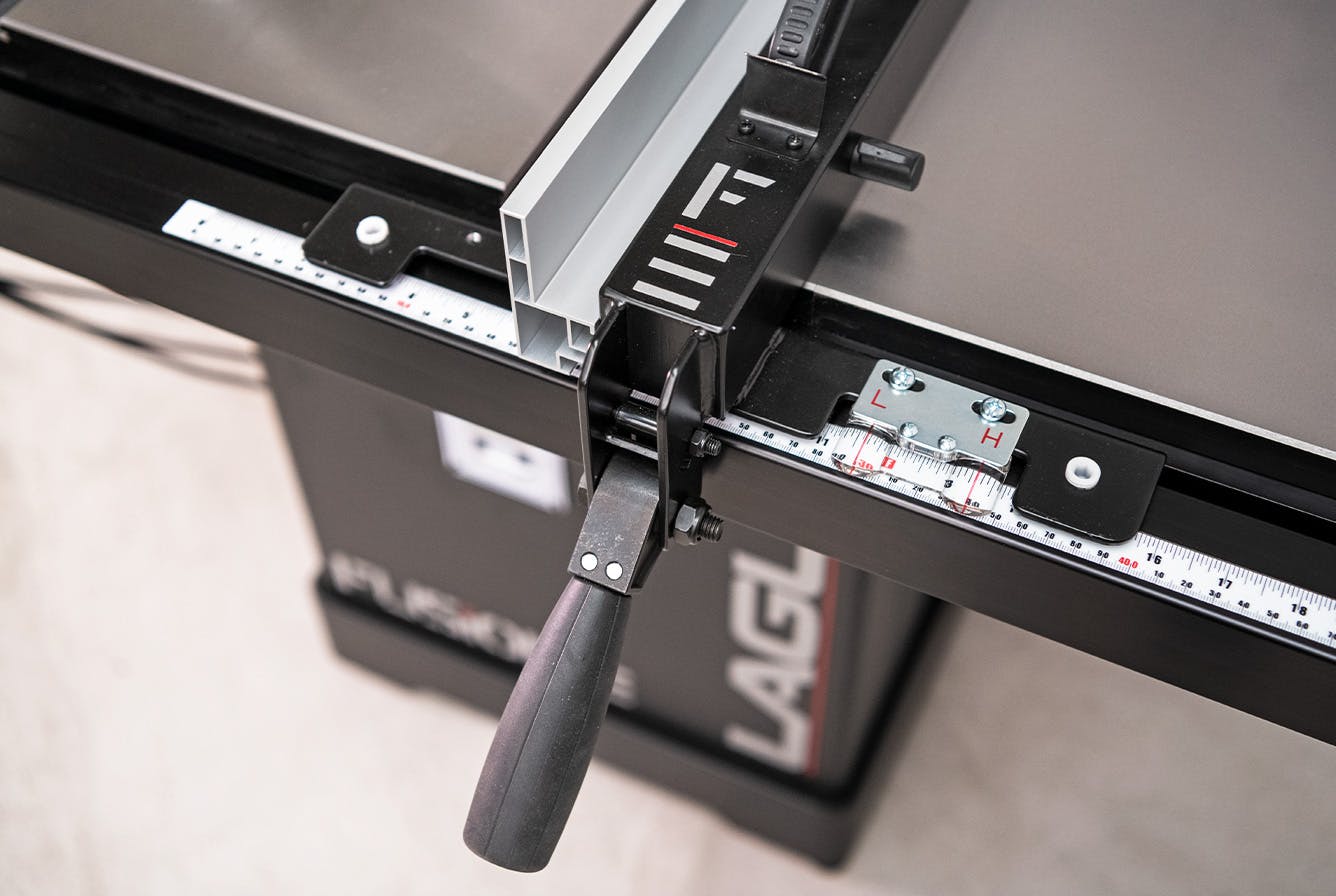

The fully adjustable 'T Style' rip fence glides effortlessly and locks securely, making it a joy to operate with its simple cam lock handle. The Hi-Lo fence design is perfect for making narrow cuts, even in thin materials. The easy-to-read measuring scale is conveniently marked in both metric and inches, allowing you to customise your cuts with ease.

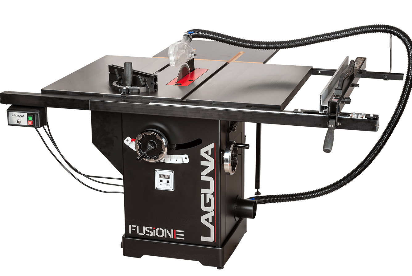

The twin mitre fence slots, accommodate various positions, allowing precise angles to be achieved. Powered by a 2.8 kW braked induction motor, the F3 Table Saw delivers a consistent performance, allowing you to power through tough materials effortlessly.
The cast polished hand wheels control the arbor, so that the rise, fall and tilt provide smooth adjustments, enabling precise cutting angles and depths. The digital readout makes it even easier to reference the exact tilt angle to a tenth of a degree. The deluxe mitre fence with rack and pinion adjustment allows for fine-tuning your cuts, while the zero-clearance phenolic table insert ensures clean cuts.
The transparent crown guard ensures a clear view and effective waste clearance, keeping your workspace clean. The onboard tool caddy keeps your tools organised and within reach, while the all-metal spindle block allows for quick and easy blade changes. The conveniently placed on-off control box ensures safe and easy operation whilst the integrated wheel kit allows for easy mobility.
With the Laguna F3 Fusion Table Saw, you can achieve excellence in every cut. Its combination of precision, power and innovative features makes it the perfect addition to any workshop.
Supplied with; a wheel kit integrated within the base, on-board storage points for all the accessories, mitre fence that is hyper accurate when travelling in the T slots, 40 tooth TCT sawblade, quick release riving knife for fast blade changes, 1.8m power cable with industrial 3 pin 16 amp blue plug. A 16 amp fixed electric supply is required to run this machine.
