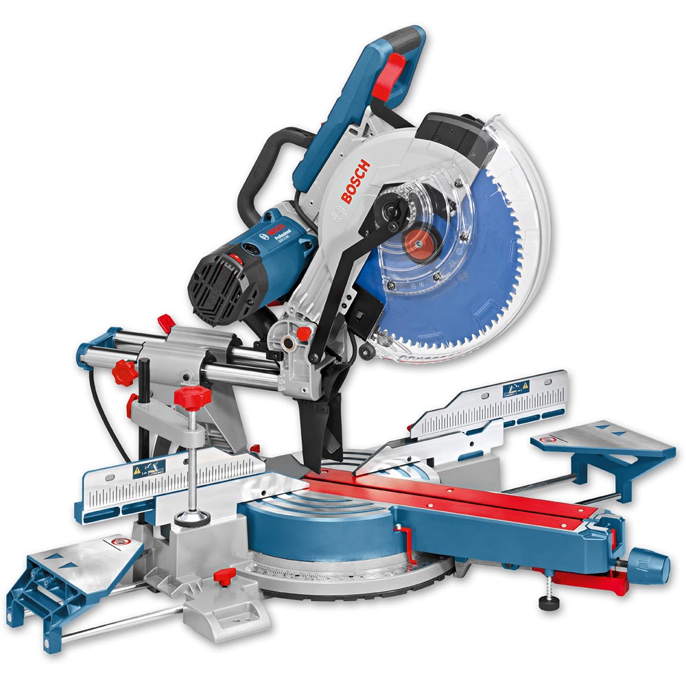

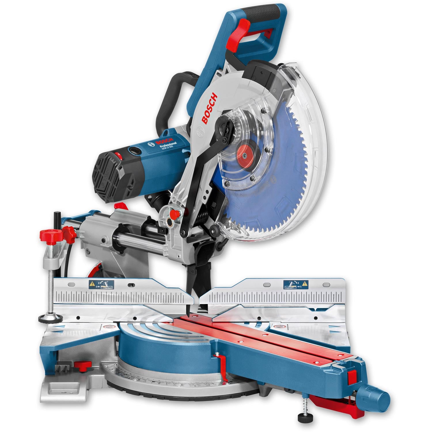

Bosch GCM 12 SDE Dual Bevel Mitre Saw
SKU: 101829
€970,00
  • Massive cutting capacity of 120mm x 400mm (with spacer)
  • Variable speed for cutting a wide variety of materials (110V is single speed)
  • SDS nut for tool free saw blade changes
  • Bevel cutting up to 47 on both sides
  • Laser line projects cut line across the workpiece
  • Pull out table extensions on both sides for extra support
  • 3 year warranty available (registration required)
The Bosch GCM 12 SDE professional dual bevel mitre saw guarantees precision and versatility. It offers a massive 120mm depth or 400mm maximum width of cut. The bevel and mitre cutting facility on both sides have indents at common angles. A laser line projects the cut line across your work-piece. Both sides of the table have pull out extensions to give extra support to longer workpieces. Variable speed control featured on the 230V option allows the cutting of a wider variety of materials. A well-designed dual dust extraction system helps keeps your working environment clean. The spindle lock combined with an SDS blade nut makes blade changes fast and tool-less. To achieve the maximum 400mm crosscut, a sacrificial base board is required. The integral carrying handle makes transportation easier and safer.
Bevel Angle Range 47 - 0 - 47
Dust Extraction 35 mm Outlet
Mitre Angle Range 52 - 0 - 60
Overall L x W x H 860 mm x 600 mm x 530 mm
Rating Trade/Professional
Spindle Lock Standard Feature
Blade Diameter 305 mm
Sound Power Level LwA [Uncertainty K] 105 dB(A) [3.0 dB]
Blade RPM 3,100 - 4,000 rpm
Sound Pressure Level LpA [Uncertainty K] 92 dB(A) [3.0 dB]
Motor Power 1,800 W
Voltage 230 V
Web Attribute Set Mitre Saws Mains Powered Globale Group: low-margin-eu
EAN Barcode 3165140769679
