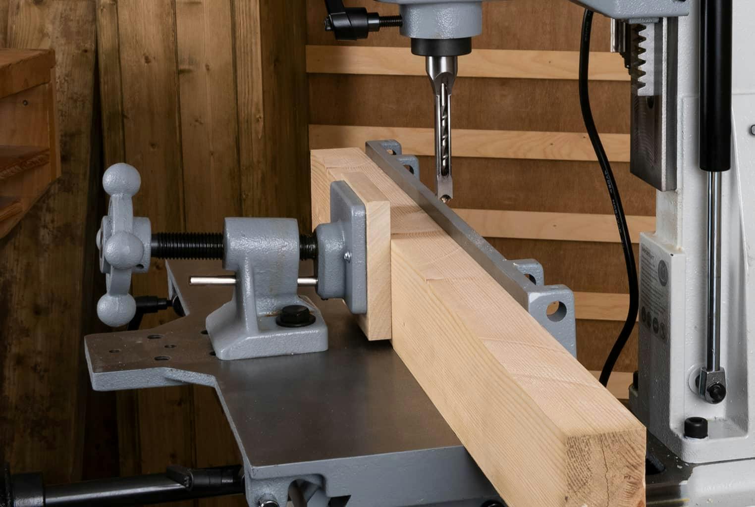

Cast iron construction
The AP25BM Bench Morticer is produced almost entirely from cast iron, making this a strong and durable machine.

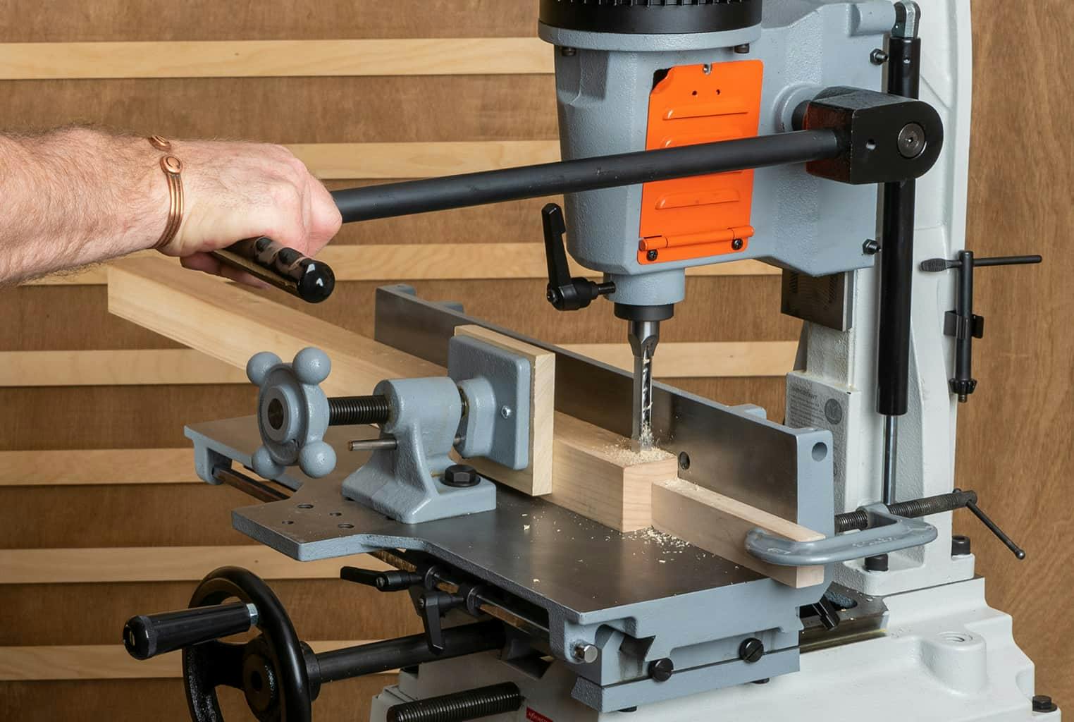

Smooth, one handed operation
Easily control the longitudinal and lateral table movement with one hand wheel.
Adjustable work stops
With lateral stops for repeat mortising and a depth stop which includes a haunch stop, the AP25BM can be used to produce a number of different joints.
Gas strut assisted head
Benefit from reduced fatigue and “parking” of the headstock in any position, thanks to the gas strut assisted headstock travel.
Effective timber clamp
The multiple position material clamp can accommodate a range of workpiece widths, enhancing the versatility further.
