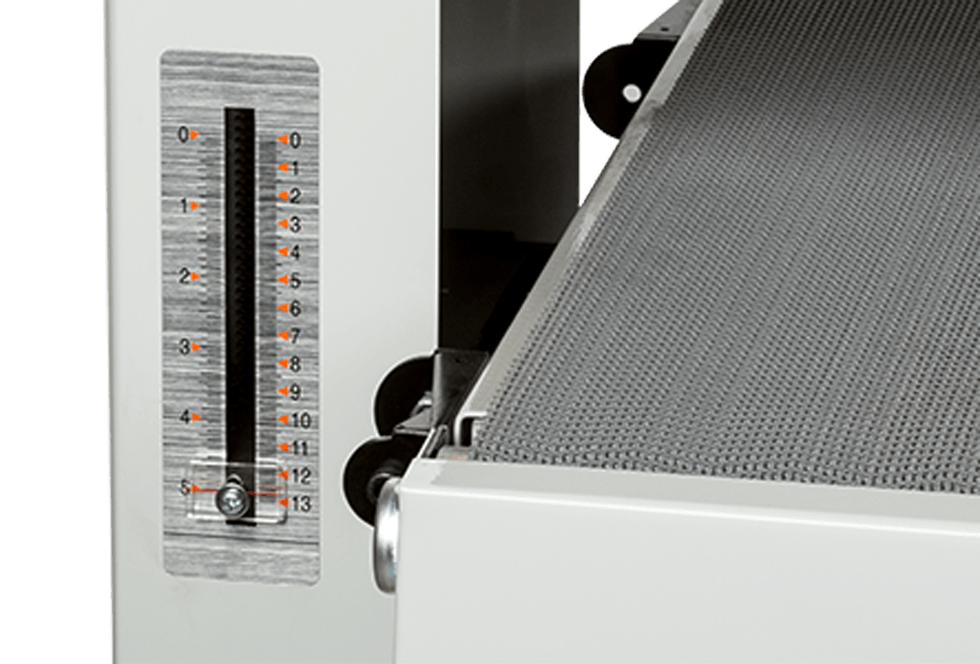

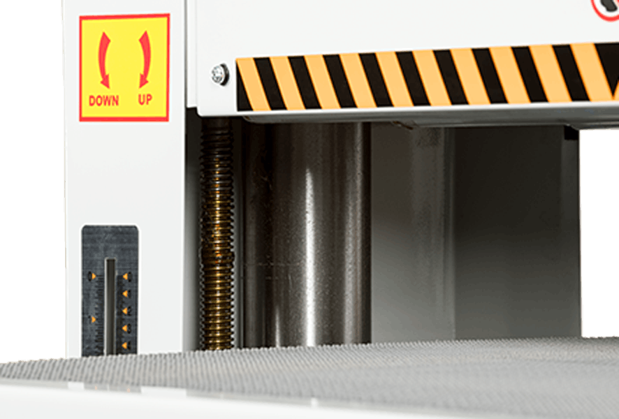

The sanding drums are aluminium, machined and dynamically balanced for smooth running. The drums are powered by a 1.5kW 230V. Being a twin drum machine, it uses a different grade of abrasives on each drum, coarse on the front, fine on the rear. The rear roller will require adjustment depending on the abrasive being used. A graduated scale for each side makes accurate setting an easy task. The abrasive is easy to change, requiring no tools. The access lid has a safety interlock switch.
A separate variable speed motor drives the conveyor, giving a wide range of feed speeds. A convenient crank handle and scale are provided for easy adjustment of thickness.
