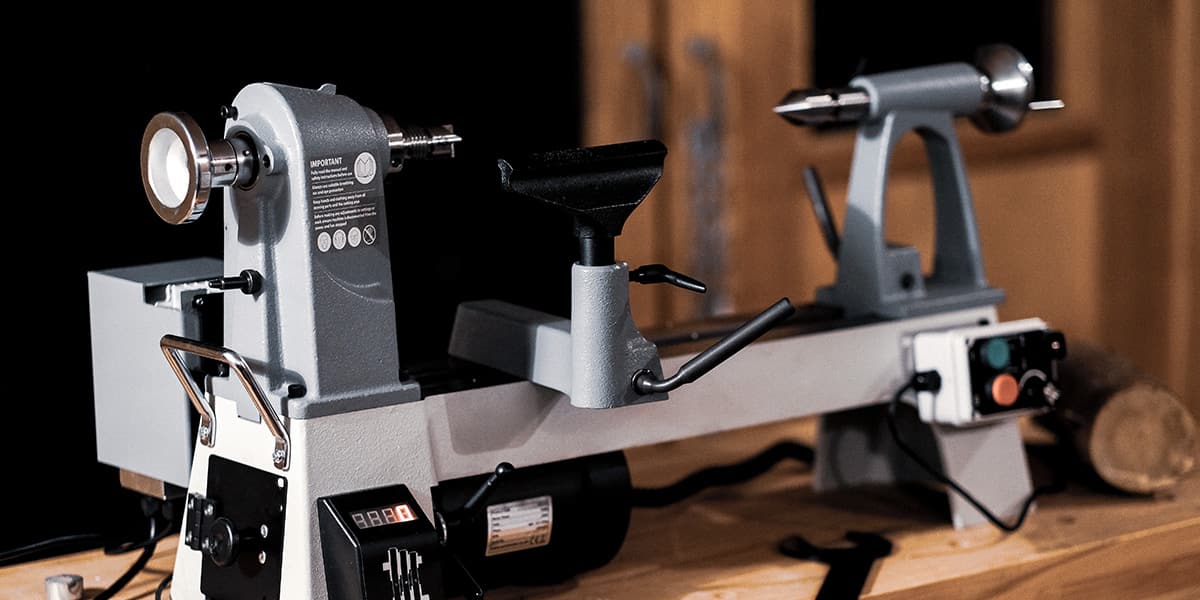

The first thing that struck me when unboxing the lathe was the size of it. It was more compact than I was expecting. At only 83cm in length, it made it easy to lift out of the box and place onto the workbench. The lathe comes with clear instructions and a separate printout. This included detailed images making the assembly a quick and easy process. I had everything attached and bolted ready to go in under 15 minutes. Assembling the lathe right out of the box gave me the opportunity to look over each component and inspect the quality. The casting of the lathe bed is excellent and the machined components were all of a high standard.

After the lathe was fully assembled I wanted to test it out straight away. Having only just arrived where I would be working I hadn’t had a chance to prepare any wood for turning; so I took a piece of birch from the firewood stack and mounted it between centres. I immediately felt right at home. The lathe I use on a daily basis is a JET 1642 which is a much larger, more powerful lathe; however, going from that to this one felt totally natural. It took no time at all to get used to the smaller tool rest and handles on the banjo and tailstock.
The first real difference was having the ability to position the speed control wherever I wanted. It has in-built magnets on the rear meaning you can position it on any part of the lathe bed as well as on the workbench. It became clear straight away that this flexibility would make for more efficient working. Giving me quicker control over the speed of the workpiece and not having to constantly change my position to reach a fixed speed control.
The second most notable feature was how much power the lathe had. The 560w motor delivers massive amounts of torque that, quite honestly, I was amazed by. When I started the lathe for the first time and made the initial cut with a roughing gouge, I was quite tentative. Making a light pass with the tool to test the motor’s ability, within thirty seconds I was making hard aggressive cuts into seasoned wood, removing waste material as if it wasn’t there. The power was maintained all the way through the cut without getting bogged down once.
