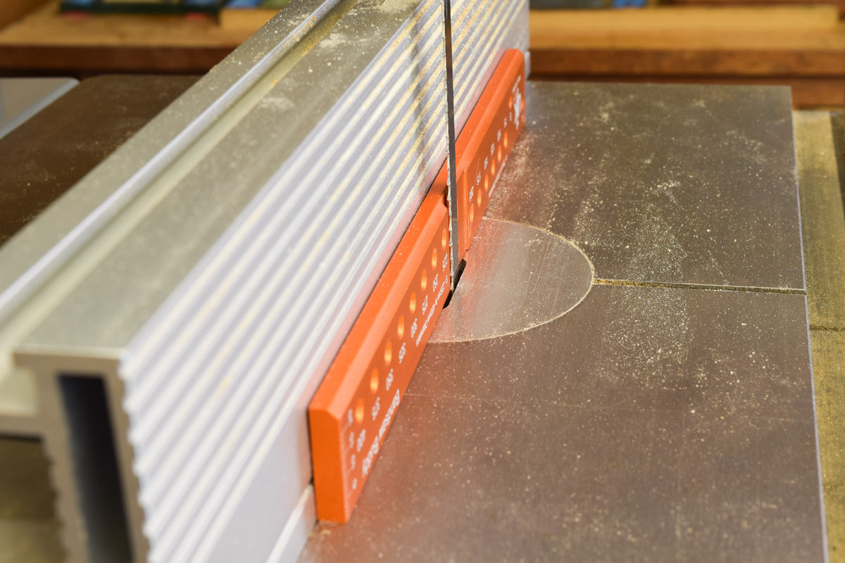

However, what I’ve never done is to check the alignment of the fence against the blade. I’ve always made the assumption that the fence will be set up by the manufacturers. Having bought the UJK Technology Bandsaw Buddy to check for this very thing, I was quite surprised to find some ‘toe out’ on the fence.
The effect of this misalignment is to upset the way the saw blade tracks. It won’t naturally want to follow a straight line cut, but will instead tend to veer. The inevitable result is the user has to make an extra effort to keep it cutting true. At worst, the blade may deviate from its intended line.

Having realised some adjustment to the fence was needed, I had a look through the excellent User Manual and there it was on p17…a pic of the Bandsaw Buddy in place. To make the adjustment, all I needed to do was to slacken off the four nuts (arrowed), nudge the complete table into the right position and then re-tighten. The fence was then aligned spot on with the saw blade.
