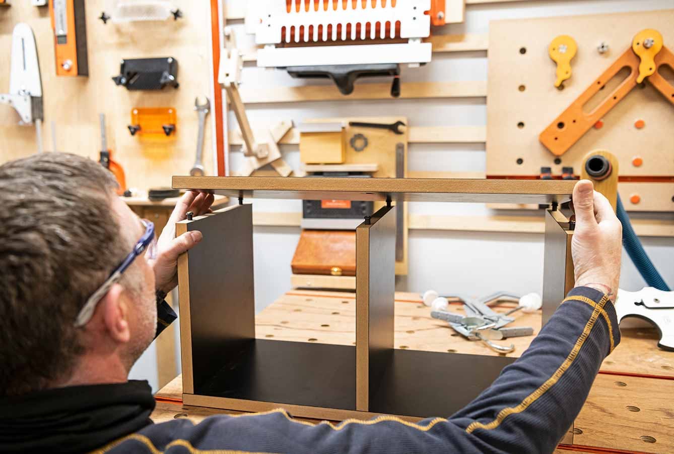

An innovative solution to cabinet making
An affordable alternative to other jointing systems on the market, this package will help you become more efficient at work, saving you time and money.
Versatile
The Peanut® 2 Jig is now available with either a 1/2" or 8mm shank, making it suitable for a wider range of applications than ever before.
Easy to use
The Peanut® 2 Jigs are so easy to use, they can be learned in minutes. Instructions are included and there are plenty of videos and extra resources on both the Axminster and Intelligent Fixings websites.
Strong
Joints created using the Peanut® Jigs are guaranteed to be extremely strong at both 45 and 90 degrees. They will be able to withstand multiple disassemblies and assemblies with no loss of strength to the joint.
Invisible
The compatible connectors for this jig clamp and pull the material together from the inside, meaning your joints are always invisible and your workpiece looks tidy.
Fast
The Peanut® Jigs are a speedy solution to your everyday joints, thanks to the unique connectors. As the material is pulled together from the inside, there is no need for clamps and therefore no waiting around for glue to dry whilst assembling.
Tailor to your project
The Peanut® 2 Jigs are compatible with three different invisible connecting systems - Peanuts®, loose tenons and dowels, meaning you can choose which suits your project best.
Convenient
The Peanut® 2 full size Jig is perfectly suited for use in the workshop. This means you can rout multiple joints at a time, allowing you to use your time more efficiently.
Making joints with the PEANUT® jig is quick and efficient, resulting in a strong, rigid connection. Anyone with a router that can take an 8mm shank cutter and a drill can produce a wide variety of cabinet joints quickly, 90° and 45° with spot-on accuracy everytime. The PEANUT® 2 jig is just about as foolproof as a jig can be complete with easy to follow instructions.
The PEANUT® 2 system creates secure, strong joints and enables cabinets and furniture to be taken apart and reassembled many times without loss to the joint strength, making it ideal for flat-packing.
The PEANUT® 2 Complete Package (8mm Shank) includes;
1 x Jig body (740mm x 190mm x 12mm)
1 x Fence (740mm x 110mm x 20mm)
4 x Slot guide inserts
1 x PEANUT® special router cutter (8mm shank)
1 x Drilling guide bush
1 x 6mm HSS drill bit with stop
1 x Low profile router guide bush
4 x M6 hex head bolts
1 x Nylon carry case
100 x PEANUT® 2 connectors
The only additional items required are clamps and 3.5mm size/gauge screws
Suitable for board thicknesses; 18 to 25mm.
