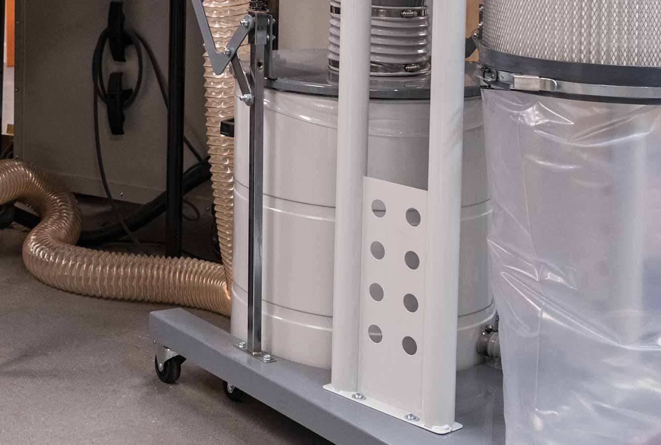

Large Collection Drum
With a 110 litre collection bin to hold the majority of the waste, you won’t need to waste time with frequent bag changes. When the time comes, simply lift the waste bag out of the drum and replace!

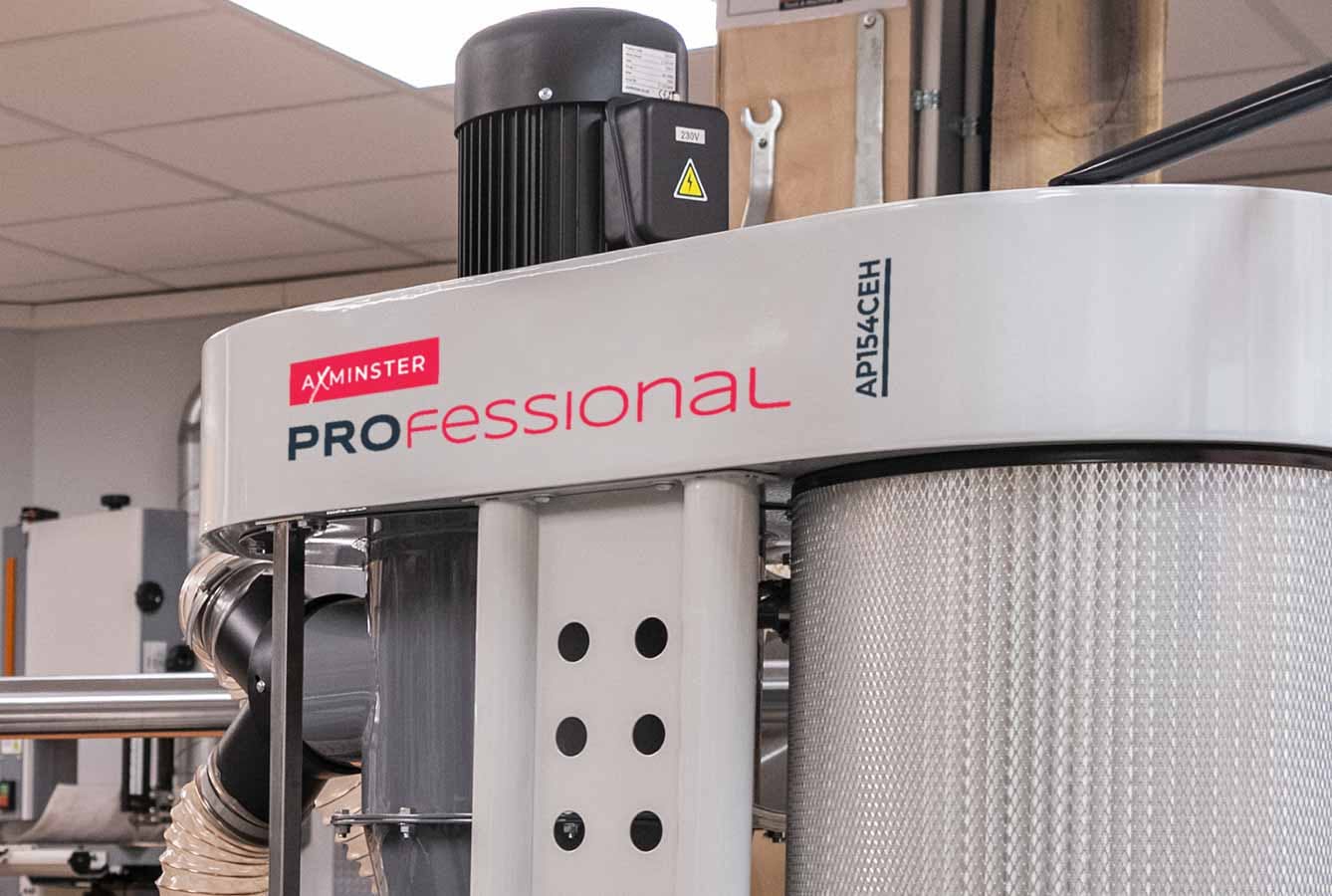

Alloy Impeller
The AP154CEH features a 1.1kW motor which drives an alloy impeller, providing a high static pressure and reducing the risk of sparks.
Dual Paddle Filter Cleaner
The AP154CEH has an integral paddle operated by a crank handle, so you can easily clean the cartridge filter and help to extend the life of your filter.

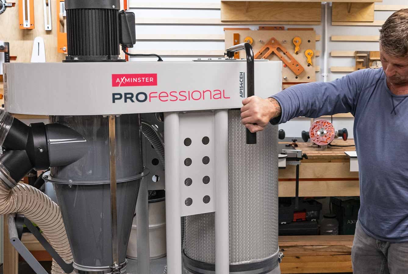

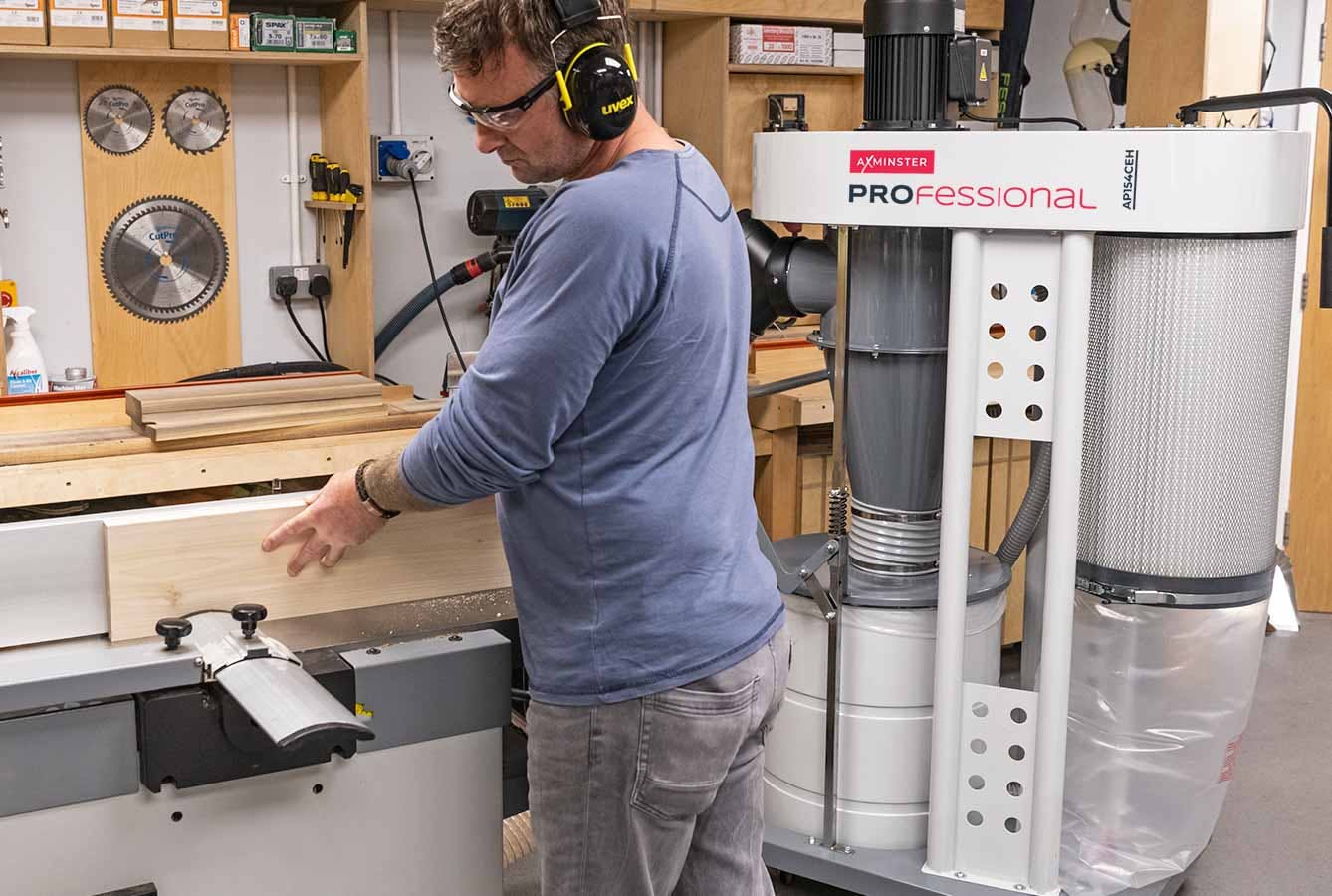

The AP154CEH Cyclone Extractor is a highly efficient machine. This is a relatively compact extractor, with a tubular steel frame holding the main body, filter and waste bin. Compared to other forms of extractors, a cyclone provides a much more efficient performance. The cyclone separates the larger waste particles from the finer dust, before the airflow passes through the extractor’s fan. As a consequence, the fan operates more efficiently maintaining a consistent speed. The heavier waste falls into one bag or container whilst the very fine particles collect in separate receptacle. The cyclone removes the bulk of the waste before it reaches the extractor’s filter. The filter requires cleaning less frequently with far less mess involved.
AP154CEH features a 1.1kW motor driving an alloy impeller, providing a high static pressure and enough airflow to handle two small machines or one larger one. It has remote control for the switch, a manometer for easy visual performance monitoring and is fully mobile on castors.
It has a 2-stage dust separation system, which removes over 99% of the waste from the airstream. The vast majority of the waste is collected in the 110 litre bin, with the HEPA 13 rated cartridge filter trapping any remaining very fine dust. The waste bin is easy to empty, mounted on castors, the waste bag inside is simply lifted out. The bag being held in place by vacuum during use. The cartridge filter is cleaned with an integral paddle operated by a crank handle, there is a small waste bag to collect the disturbed dust. Rated at HEPA 13, it will trap wood dusts down to 0.3 micron @ 99.97% efficiency.
Perfect for the smaller professional workshop, it is quiet, efficient and compact.
