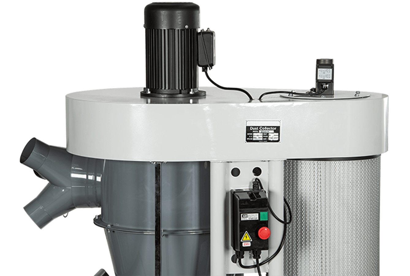

The AP357CEH uses cyclone technology in a two-stage dust separation system. A quiet, high-performance extractor, it can run a moderately sized ducted system or extract from a single large machine.
Cyclone system
Cyclone extraction is a highly efficient option. The cyclone separates larger particles and chips from finer dust, before the airflow passes through the fan. This means that the fan operates more efficiently and maintains a consistent speed.

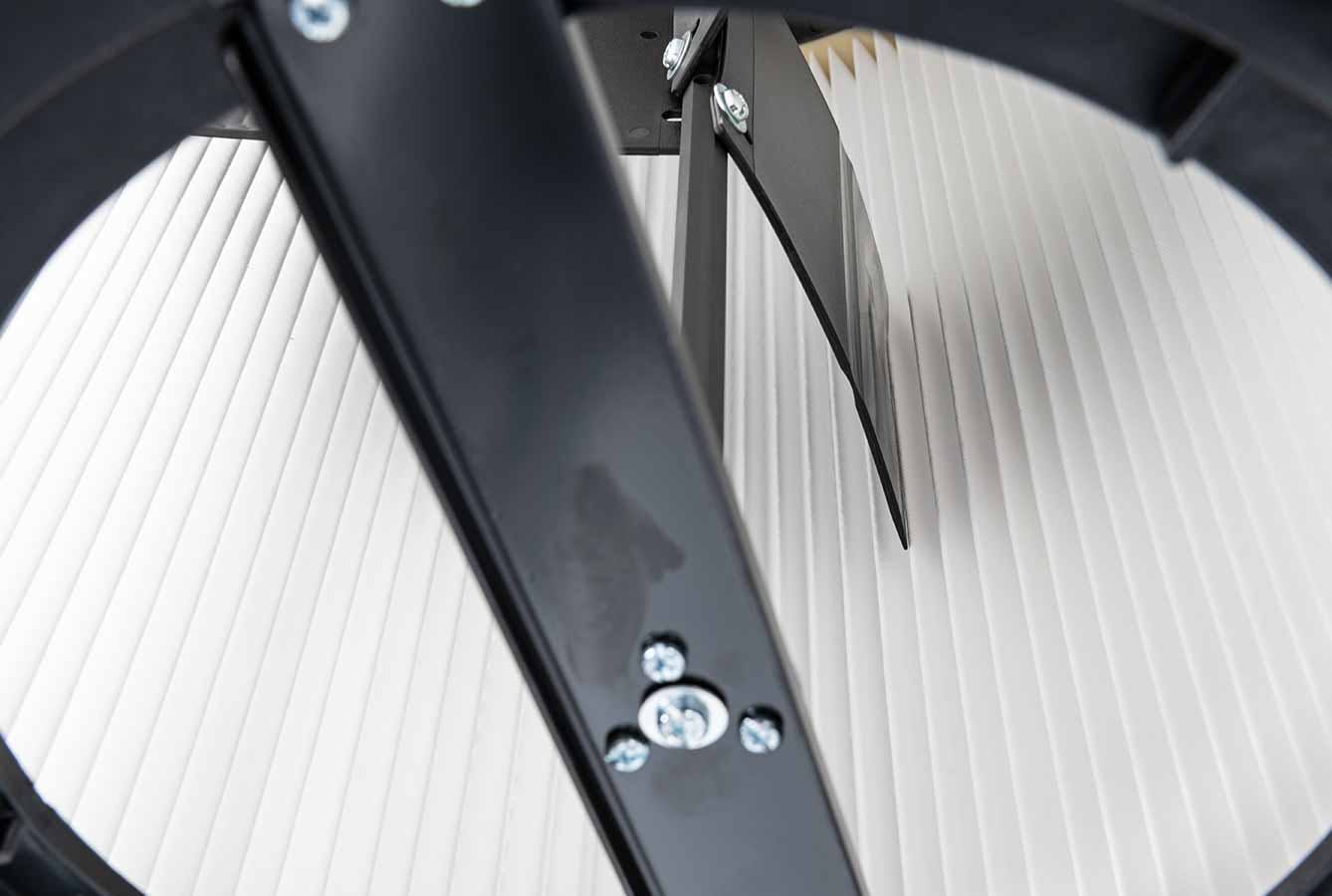

HEPA H13 Filter
Stage two in the dust separation system, the HEPA 13 rated cartridge filter with an exceptionally large filter areas traps any remaining fine dust down to 0.3 microns @ 99.97 efficiency. The filter requires far less cleaning with less mess involved.

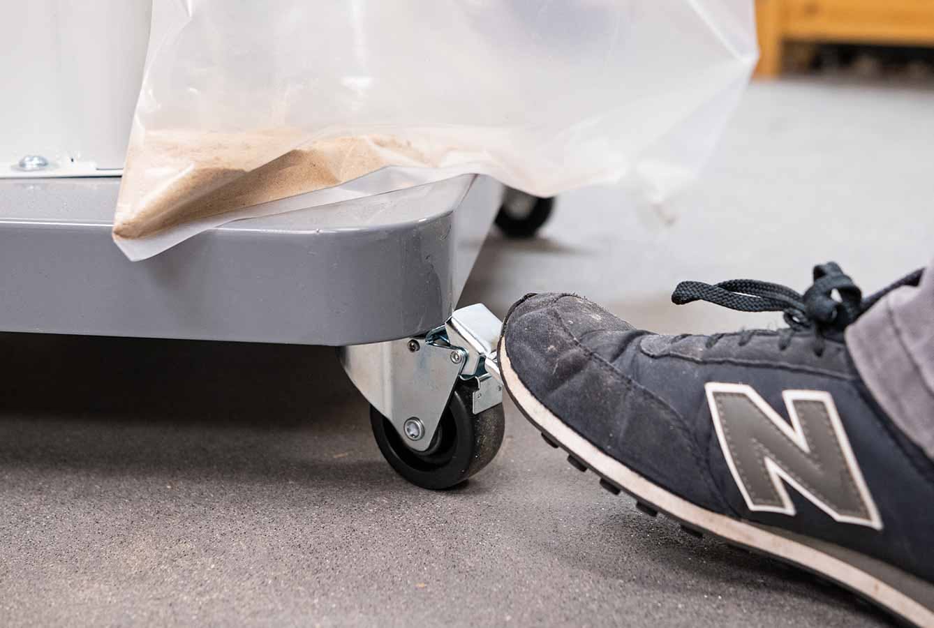

Castor wheels
Move the AP357CEH Extractor around with ease thanks to the castor wheels, giving you extraction at hand for all areas of the workshop.

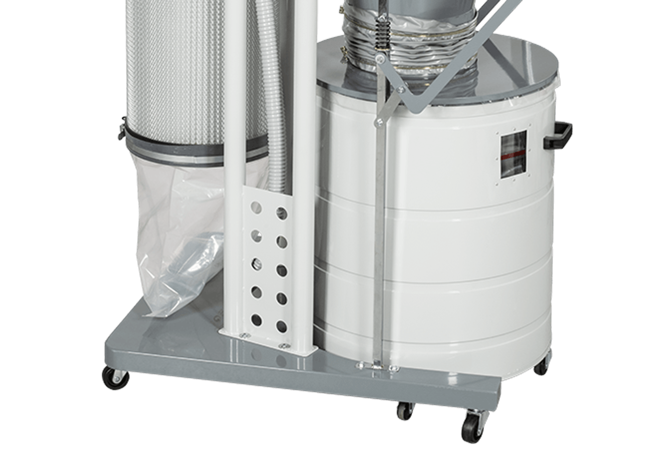

Large Collection Drum
With a large 198 litre collection bin to hold the majority of the waste, you won’t need to waste time with frequent bag changes. When the time comes, simply lift the waste bag out of the drum and replace!

The AP357CEH features a 2.2kW motor which drives a high-performance steel impeller, providing a high static pressure and large airflow. The steel composition is also at less risk of damage from waste impact.

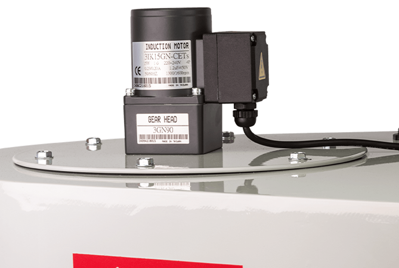

Auto filter cleaner
Extend your filter’s life and save on time, thanks to the motor driven paddle system which automatically cleans the cartridge filter.

The super efficient two-stage dust separation system first deposits the vast majority of the waste into a 198 litre capacity bin. A HEPA 13 rated cartridge filter with an exceptionally large filter area then traps any remaining very fine dust. The waste bin is simple to empty: just press down a large handle and wheel the bin out on its own castors. A waste bag inside the bin can be simply lifted out. During use, the vacuum holds the bag in place. The cartridge filter is automatically cleaned by a motor driven paddle system. This system, controlled by an integral timer and operates when the machine is switched off. A small waste bag beneath the filter collects the disturbed dust. Rated at HEPA 13, it will trap dust down to 0.3 micron @ 99.97% efficiency.
A rigid tubular steel frame supports the main body, filter and waste bin. Castors on the base offer good maneuverability. The AP357CEH comes with a remote control, so you can switch on/off wherever you are in the workshop. The manometer offers easy visual performance monitoring.
