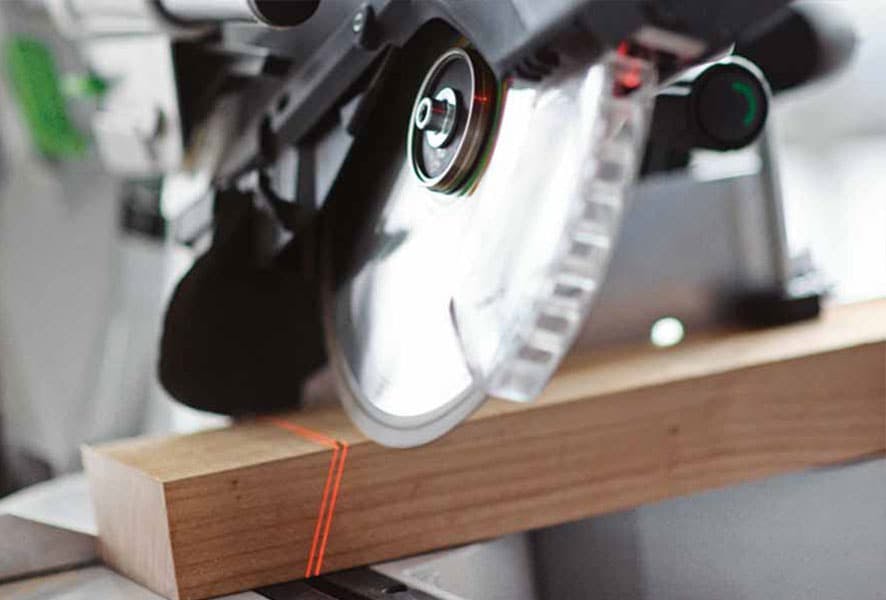

Achieve the perfect cut with this impressive sliding compound mitre saw
Additional tool features
For more efficient working, the extra mitre position makes cutting depths up to 120mm possible. Intelligent details like a double laser line and bevel produce exact results.

A complete mobile mitre saw package deal comprising a Festool KAPEX KS120 REB mitre saw and a UG portable base frame along with right and left hand extension supports.
KS120 REB Mitre Saw
The KAPEX KS120 REB offers impressive capacity and uncompromising accuracy. It is capable of cutting boards and panels up to 305mm wide and 88mm thick and trimming crown mouldings up to 168 mm in their original wall position.
The KS120 REB features eleven preset mitre angles and a twin-line laser beam. The beams indicate precisely where the blade will cut. Variable speed means you can adapt to different materials for the best cutting performance. The main casting provides a firm foundation for the twin bars, which support the saw head giving the saw its supreme accuracy and solid feel. Pull out side extensions provide extra support to longer workpieces.
The machine comes with a 60-tooth TCT blade, a work clamp and an adjustable bevel, which, transfers angles for interior and exterior angles and dissects angle automatically for easy saw setting. Crown stops (available as an optional accessory) support crown moulding or cornice at the correct angle for cutting perfectly accurate mitre joints.
