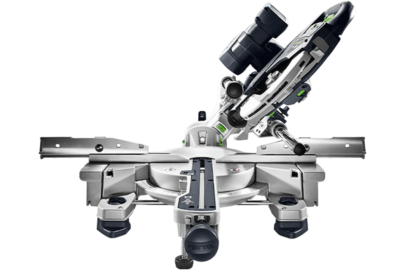

Make unbeatable cross cuts
Combining the flexibility of a battery-powered tool, with the performance of a mains powered machine, the KSC 60 EB is a joy to use. Produce high precision cross cuts with ease, across a whole host of applications.

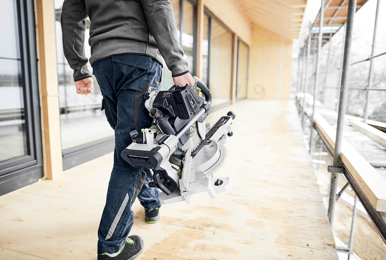

Limitless mobility
Easily transport this machine, with its ergonomically positioned handles and practical safety device. Manoeuvre it with ease, thanks to its compact, lightweight design and flush-mounted guide rods.
Unparalleled precision
Produce perfectly precise angles, with the assured guidance offered by the twin-column guide and dual ball bearings. This ensures the blade is controlled smoothly on whichever chosen setting, without juddering and wobbling.
Exceptional power
The combination of the latest ergonomic EC-TEC motor and the dual 18V battery system provides maximum power and uncompromised endurance, lasting you a full working day.
Remarkable versatility
Easily adjust your angles with this versatile machine, thanks to the mitre angle guides of up to 60° on each side. By using the snaps on the table, you can simply select the preset mitre angle via locking positions, for a fast setup.
Outstanding visibility
Visual assistance from Festool ensures you produce cuts to an excellent standard. The LED spotlight casts the saw blade shadow onto the material, highlighting the exact cutting line. Absolutely foolproof.
Extendable workspace
Endless possibilities. Simply pull out the extension tables on either side to provide ample support for longer workpieces.
Additional versatility
Achieve rapid and precise grooving, all thanks to the cutting depth limiter.
Reduces errors, saves time
he SM-KS bevel makes the rapid measurement of both interior and exterior angles. Ensuring the transfer to the saw is easy and precise.
For all users
The switch and handle are in a central position, making it just as easy for right-handed and left-handed users to operate.
The Festool KAPEX KSC 60 cordless sliding compound mitre saw combines the freedom of a battery powered tool with the performance of a mains powered machine. The brushless EC-TEC motor coupled with dual battery power (2 x 18V 5.0Ah batteries and charger included) provides enough runtime for a typical full day's work. The KSC 60 produces unbeatable precise crosscuts. Mitre angles of up to 60° on each side with indents at common angles and bevel angles 47° L and 46° R, with stops at 45° for fast setup.
The twin guide bars with two bearings each ensure that the saw blade moves smoothly and precisely at every angle; making every cut perfect. The variable speed can be preset for the best results for the material in use. The low weight, compact design and convenient handles make this easily portable for work on site. An LED spotlight highlights the cutting line ensuring good visibility of a scribed cutting line. A large dust bag is supplied making for a cleaner workspace even without a mobile dust extractor. Pull out extension tables on each side provide support for longer workpieces.
The additional feet bring the height of the KSC 60’s table to the exact same height of an SYS 3 M 112 or SYS 1 Systainer case.
Includes a Festool bevel which transfers interior or exterior angles to the saw for a perfect mitre every time.
Supplied with; 2 x 18V 5.0Ah batteries, TCL DUO charger in T-LOC SYS case, dust bag, clamp, additional feet, 36 tooth TCT blade and Bevel SM-KS.
