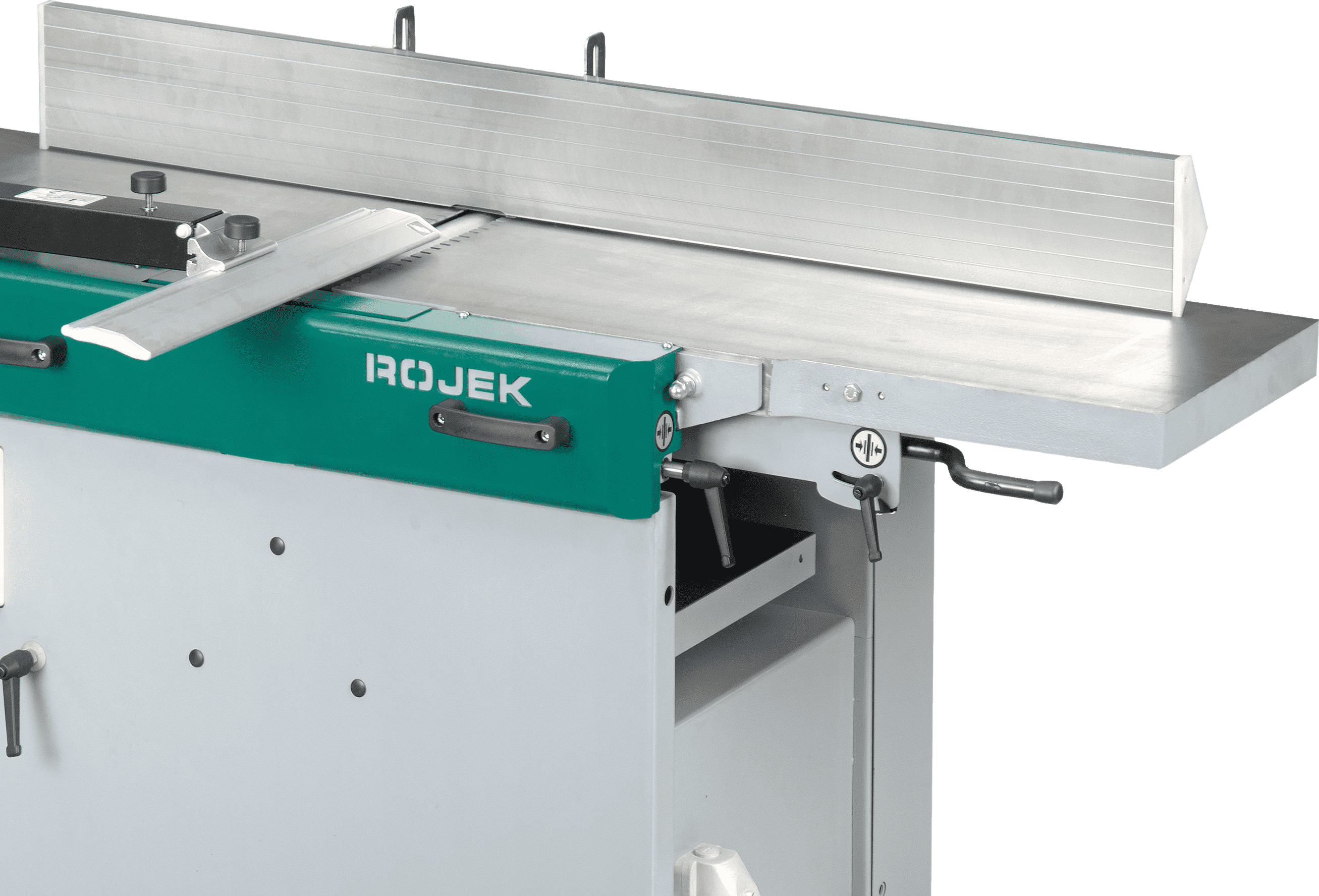

An industrial planer thicknesser
Get years of service from this solid and precise machine - ideal for a busy professional workshop.
Fine ground cast iron tables
Timber will pass smoothly over this 1,500mm fine ground cast iron table. The cast iron reduces vibration and will ensure flatness and accuracy even with demanding use.
Single lift tables
Save time and effort thanks to the single lift tables, aided by large hinges with torsion springs. Easily switch from planing to thicknessing; plus, get set up quickly and easily as the fence can stay in place.
Cast iron fence with aluminium fence plate
Timber is easily squared with this durable and robust cast iron fence, which tilts 90⁰-45⁰.

The ROJEK MSP 315 is an industrial planer thicknesser with single lift cast iron tables. Large hinges with torsion springs make it easy to handle the cast iron tables when changing from one function to the other. It has a generous 310mm planing width and a 300 x 230mm thicknessing capacity.
The MSP 315 is built around solid, precision ground cast iron tables. This machine is ideal for a modern and busy professional workshop and will give years of service.
This ready to buy package includes a spiral cutter block, which offers numerous advantages; notably quieter in use, the sheer cutting action of the spiral block also produces a super smooth finish with no visible lines across the board. Fitted with 3 spirals and 51 knives, the spiral block features 56 15mm solid tungsten cutters in a helical pattern. Lasting ten times longer than HSS, when the edge of the square tungsten cutter dulls, it can be rotated to a fresh and sharp edge, removing the need for complicated knife changes. By producing smaller chips, strain on the machine is reduced and extraction is more efficient.
The MSP 315 is a high quality European made machine, built to last. Our specialist consultants will be happy to discuss the ROJEK range with you; email [email protected] or call 03332 406406.
