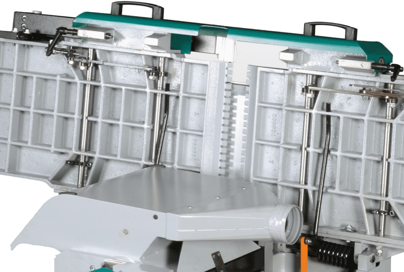

Get years of service from this solid and precise machine - ideal for a busy professional workshop.
Fine ground cast iron tables
Timber will pass smoothly over this 1870mm fine ground cast iron table. The cast iron reduces vibration and will ensure flatness and accuracy even with demanding use.
Single lift tables
Save time and effort thanks to the single lift tables, aided by large hinges with torsion springs. Easily switch from planing to thicknessing; plus, get set up quickly and easily as the fence can stay in place.
Cast iron fence with aluminium fence plate
Timber is easily squared with this durable and robust cast iron fence, which tilts 90⁰-45⁰.
Recommended Accessories
Axminster Workshop 7 Piece Forstner Bit SetSpecial Price £24.98 £20.82 was £36.28 £30.23 Save £11.30 £9.42
The ROJEK MSP 415 is an industrial planer thicknesser with single lift cast iron tables. Large hinges with torsion springs make it easy to handle the cast iron tables when changing from one function to the other. It has a large 410mm planing width and a 400 x 230mm thicknessing capacity. This machine is ideal for a modern and busy professional workshop and will give years of service.
This package gives you the best in class MSP 415 planer thicknesser combined with a 1ph motor and, most importantly, the latest spiral cutter block. With the spiral cutter block, fiddly knife changes are a thing of the past. Fitted with 3 spirals, it features 56 15mm square solid tungsten cutters arranged in a helical pattern. Each edge lasts over ten times longer than HSS, and when the cutters eventually dull, simply rotate them to a fresh edge. Spiral cutter blocks produce a silky smooth finish, without any visible lines across the board, and are notably quieter to run and reduce strain on your machine. Extraction is more efficient due to the smaller size of the chips.
