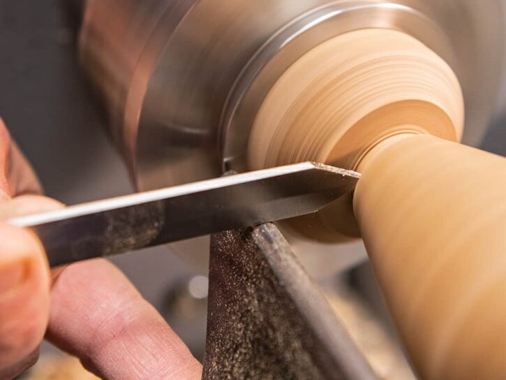

Woodturning lathe maintenance
Your woodturning lathe and chucks will constantly come in contact with moisture and wood sap through regular use. Which is why ensuring you carry out regular cleaning and maintenance on your woodturning lathe will ensure it runs smoothly.
Waxing the beds is a good place to start. Our video guide below offers covers a wide range of maintenance tips to protect your woodturning tools.
