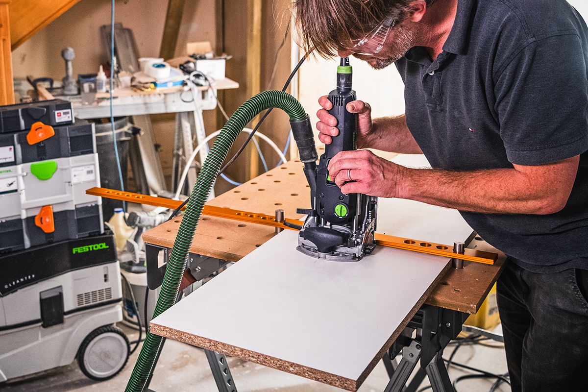

An MFT-style worktop with a precision-drilled grid ensures repeatable accuracy, maintaining consistency in cutting and routing when used with a guide rail, delivering absolute precision every time.
Clamping
The 20mm hole pattern created by the Parf MkII Guide System allows for flexible, secure clamping anywhere on the grid, making it easy to stabilise workpieces without bulky vices or custom jigs.  Use the UJK MFT Horizontal Quick Clamps anywhere on the grid to hold your work fast, exactly where you need them, without getting in the way.
Awkward Work Holding
Irregular or curved components can be safely held using UJK Guide Dogs and UJK Cam Clamps and wedges, providing better control for sanding, routing, or shaping.
